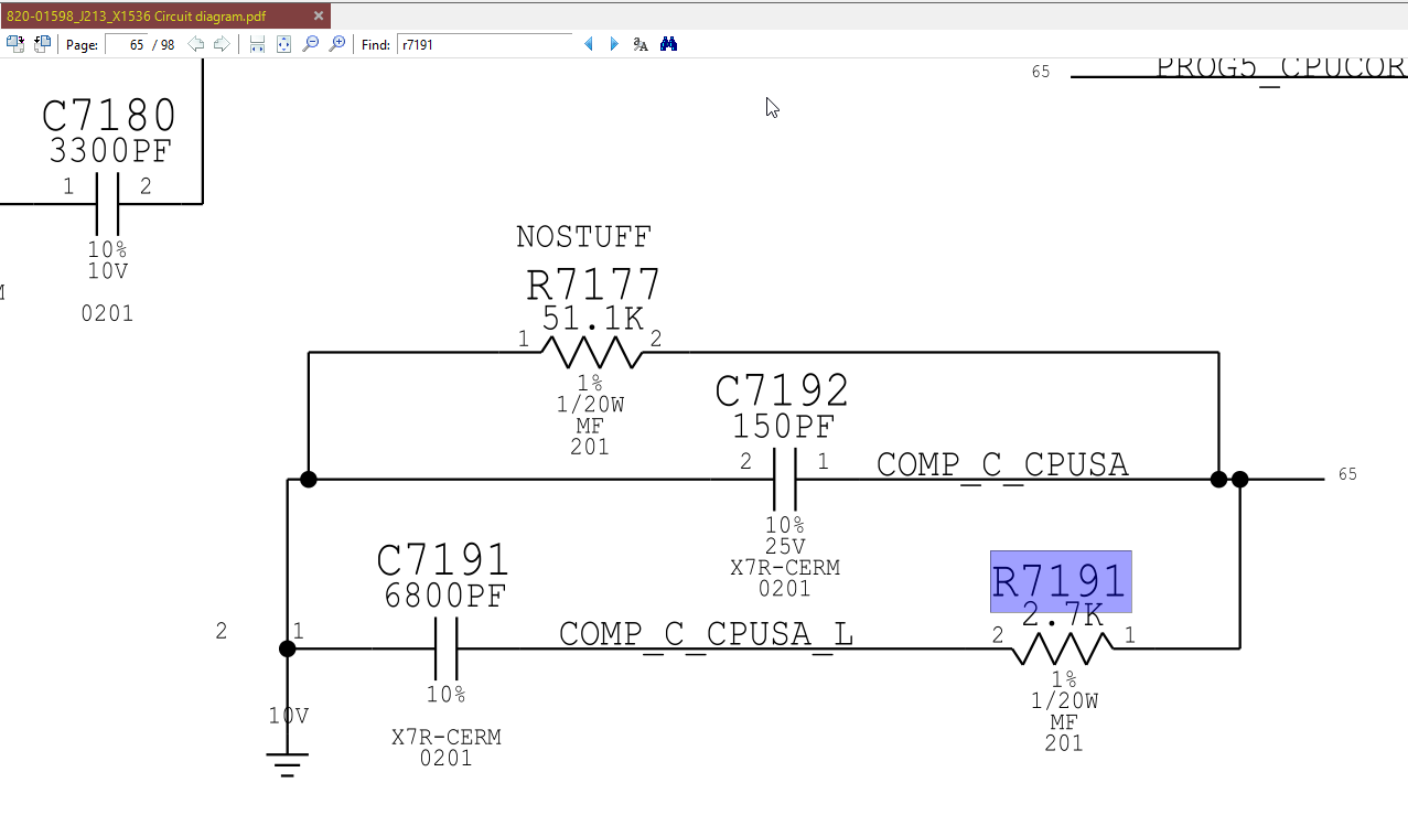

                I originally only had the one from xin zhi zao so when I measured it I saw 2.8k. Thought hmmm if that was blown it should be higher than that. Checked at other things couldn’t find anything so I removed it. Now first boot was 5v 500ma than the USB meter reset and went to 20v 0.4744 amps and fluctuating slightly. If I use the second port towards the battery connector the meter turns off and stays off, so back to the earlier behaviour.
                PPBUS at F7000 is 12.53 volts so we’re making progress finally! Looked around at a few other rails can’t see any shorts anywhere. Which boards have replacements for R7191? According to my schematics the 8P, 6,XS, 3437 and 165 have zero of these on them which I find very hard to believe! And according to the schematic the 1598 has only r7191.

                  See attached.
                  R7191 = 2k7 (2,700 ohms) 0201 size.

                    Thanks. Surprised the schematic in xin zhi zao is wrong, Piernov said there the only ones that have it for the 1598 the one we have here on badcaps is for another board he said. But when I removed the resistor it read 2.6k I think it was so it looks like it's the other way around. Frustrating as I measured it in circuit and assumed this was my problem
                    Looks like the tolerance on this resistor is only 1% so we can only go up to 2.8k is that right? Didn't check for 2.8k on thr 3437 or 165 or the 6,8P or xs do any of those have them? I recently moved out of SA to the land of Paul Daniels not sure if you can ship there? If not digikey have them in stock. Rather use a donor if I can though, so itchy to get this thing working!

                      1) If you are measuring 2.6k (2k6) for R7191, then you are ok. This is not the fault of your logic board.

                        Thanks. Yes that was for the resistor though in circuit. When I measure across the pads I got 2.6M. Resistor out of circuit was also 2.6k I think. Only got a quick glance as I haven't got anything to hold small parts like this in place. Really need to get a spring loaded chip holder or something.

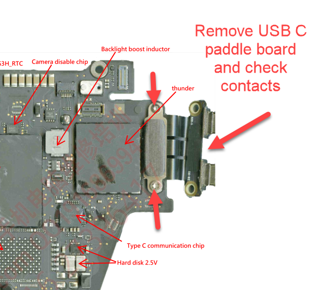

                            It is not normal for the USB port to turn off the meter.
                            Remove the USB-C paddle board and check for possible bent pins / corrosion.
                            Study, sheet 30/98 of the schematic. Check the resistance to ground on the D+ and D- pins on the USB interface for both of these USB C connectors. That is, check for possible USB C connector pin damage where it mates with the power adapter. Then on the logic board, check the same D+ and D- pins.
                            I do recall that another tech had blown ESD diodes on the logic board that needed to be replaced. They are quite tiny in size so must be handled with care. Low air pressure and a steady hand.

                                    Thanks. Checked the port all the pins look fine but the gold shield outer casing is starting to peel back. I did have a bit of trouble lining the port up earlier. Stupid me removed the screws that hold it into the board during disassembly and it popped out and I had a hell of a time realigning it. So I guess that could be the issue but I doubt it. The pins in the board connector, on the ribbon connector and on the USB c male part all look fine.
                                    0.681 diode mode for pin 7 of ue010 and 0.737 for pin 6. Specific resistance mode was 0.667M on both pins. So there seems to be no shorts on the USB c data lines. Is UE010 no stuff? It’s missing on my board but the schematic says critical so looks like that may be my issue?

                                        Sigh. I’m a muppet! In getting the connector back on I think I know what the problem is. Pin 18 on J3300 is now missing. Pin 19 outside section and bottom section of the connector are there but the inside section towards the other rows of pins seems to be missing. DZ3351, DZ3352, DZ3350, DZ3353 are cracked or partly missing. Pretty sure this is recent damage though because before replacing the isl I was checking diode modes on those and they were fine. Pretty sure this is from connecting the battery. For the parts in that row marked D rather than DZ aren’t they also diodes? I ask because whether I read left to right or right to left I get OL on them. If they were blown shouldn’t they read 0 or close to it like the DZ parts are? Hope the CD3217 is not blown
                                        How hard are the USB c connectors to change? Also can we buy the esd diodes? I know for the Xbox we can’t hopefully that’s not the case here. Sigh. Apple does such a good job of making these connectors so hard to not damage. First the battery connector on my xs and now this
