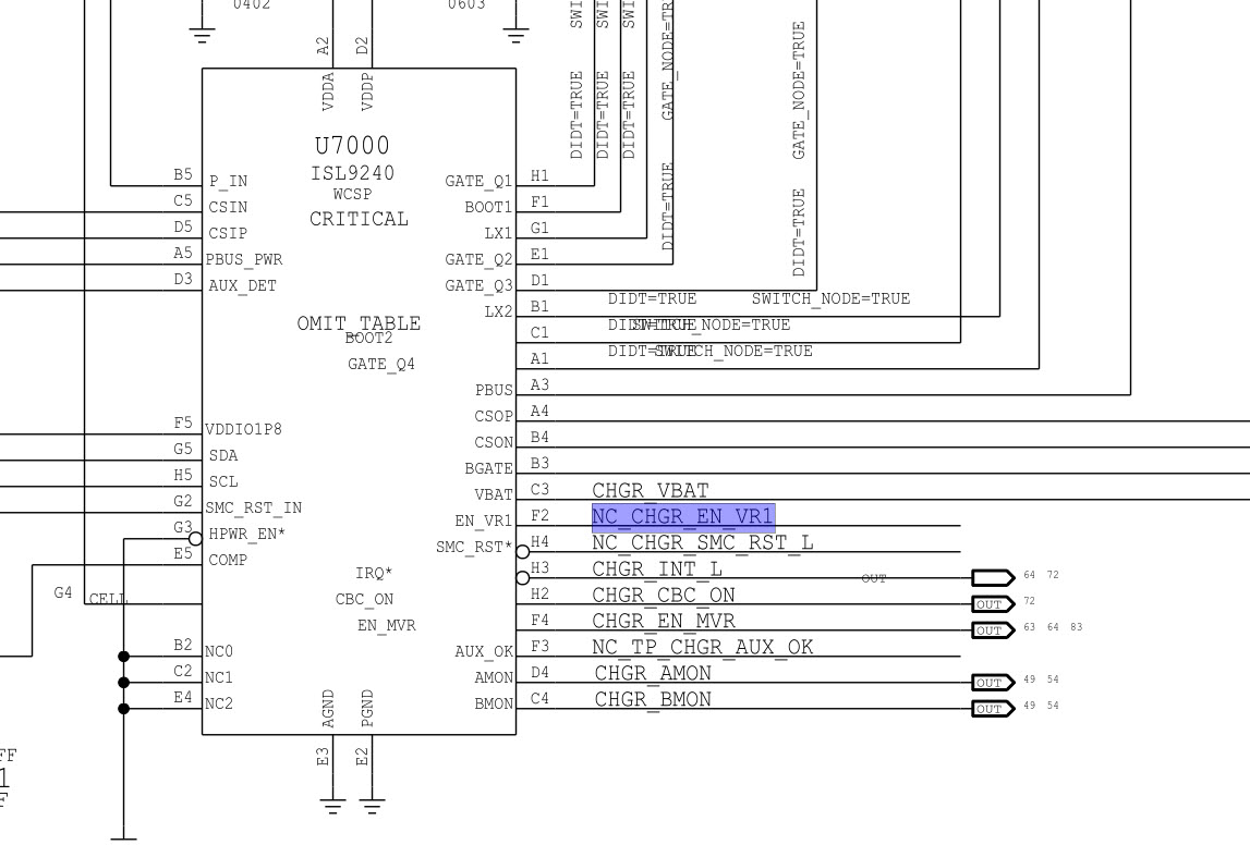

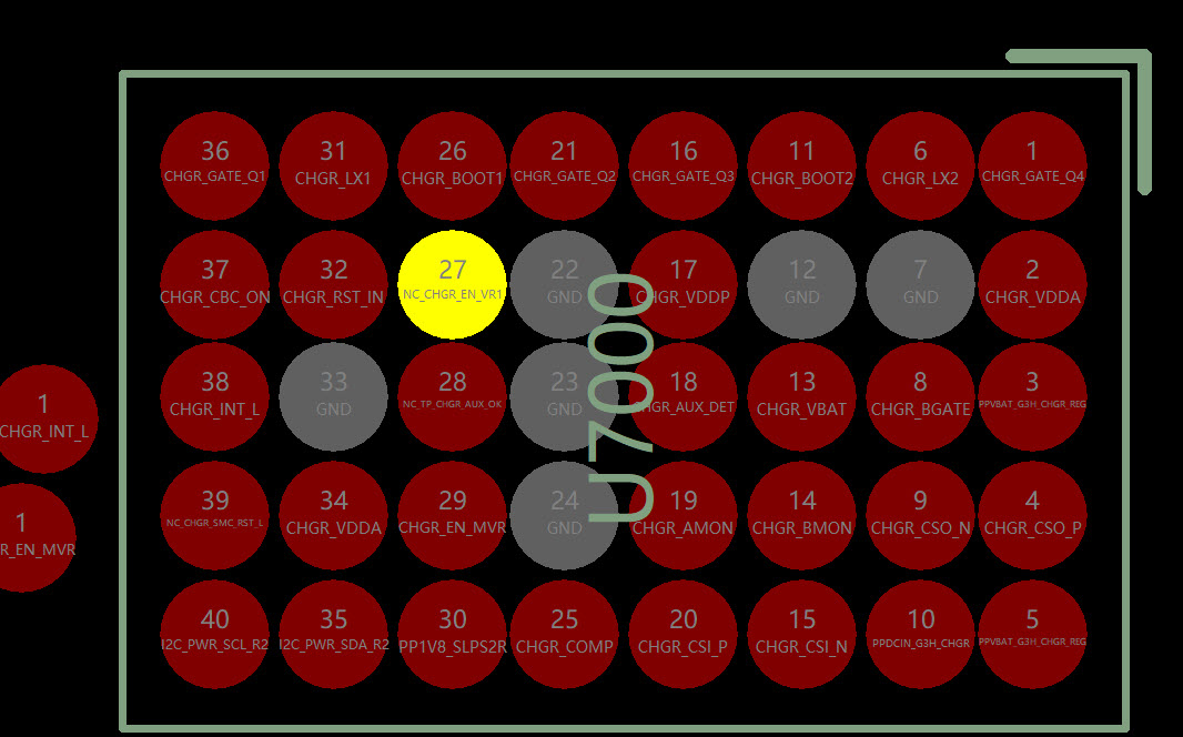

      Yea ppbus is missing.
      Ppdcin_g3H @ pin 1 of R7020 I is 5.16 so yes it is getting it.
      Diode mode for L6900: 0.400.
      pin @ r7020: 5.15v
      Aux_DET @ r7016 1.278v
      VDDA @ C7075 1.2V
      VDDP @ c7077 1.203v
      CHGR_AMON @ tp5919 0v ( also checked at r5439 again 0V. The test point layout on the board view is different to my board).
      CHGR_BMON @ TP5922 0V. Was not able to find an alternative location to test.
      VDDA & P measurements is what made me believe the isl is faulty.
      I'll try get one from Ali express see how I go. Really don't want to reball one I've never reballed anything so I'm convinced I'll crack it.
      I'm going to try another reflow see if that helps. I tried getting it to dance yesterday but it did not look like it budged hence why I brought in the tweezers. I'm using the quick 851dw what temps should I use? I was at 360 full air and it did not want to budge so I think I was too low.
      If that doesn't solve it I'll get a replacement pre balled from Ali and fingers crossed.

            You may be facing a bad ISL9240.
            See here,
            https://boards.rossmanngroup.com/thr...t-5v-0a.60834/
            These are very fragile parts. Be sure to order some spares. Found some on AliExpress for about $4 usd each.

                    As far as we know, they are all the same. We were attempting to reverse engineer the ISL9240 but halted the project. We built a tiny FPC to breakout the source pads to probe points and then stopped as the ISL9240 are now readily available. I think that the ISL9239 and ISL9240 are very similar but made slightly different to cause us techs pain by Intersil / Renesas. We did contact Renesas for any help but they are contractually bound to secrecy by the fruit company. The version you sourced should work out fine. On the flux, we purchased some low cost versions off Aliexpress and are very pleased with the results. Ironically we wanted to buy from Amtech directly in bulk volumes but the company is a joke to deal with. Went on for months in chats and amounted to nothing. I think they are seriously in bed with Louis which is fine but do not yank our chains and waste our time. We are in the business for 36++ years to date and could have moved the product. They are very old school as Louis mentioned in his posts. I think there are many good suppliers of flux on the market and you can clean up the residue with IPA (we use the medical grade stuff from Costco with success).

                                      That torn pad though I mentioned earlier is that not connected? Is it worth me trying the isl I reballed or should I just wait for the new ones to arrive? I'm curious to see if my first reball actually worked, but I don't want it enough to risk damaging this thing further.

                                        1) According to the schematics, F2 = No connect so I think you are safe here.
