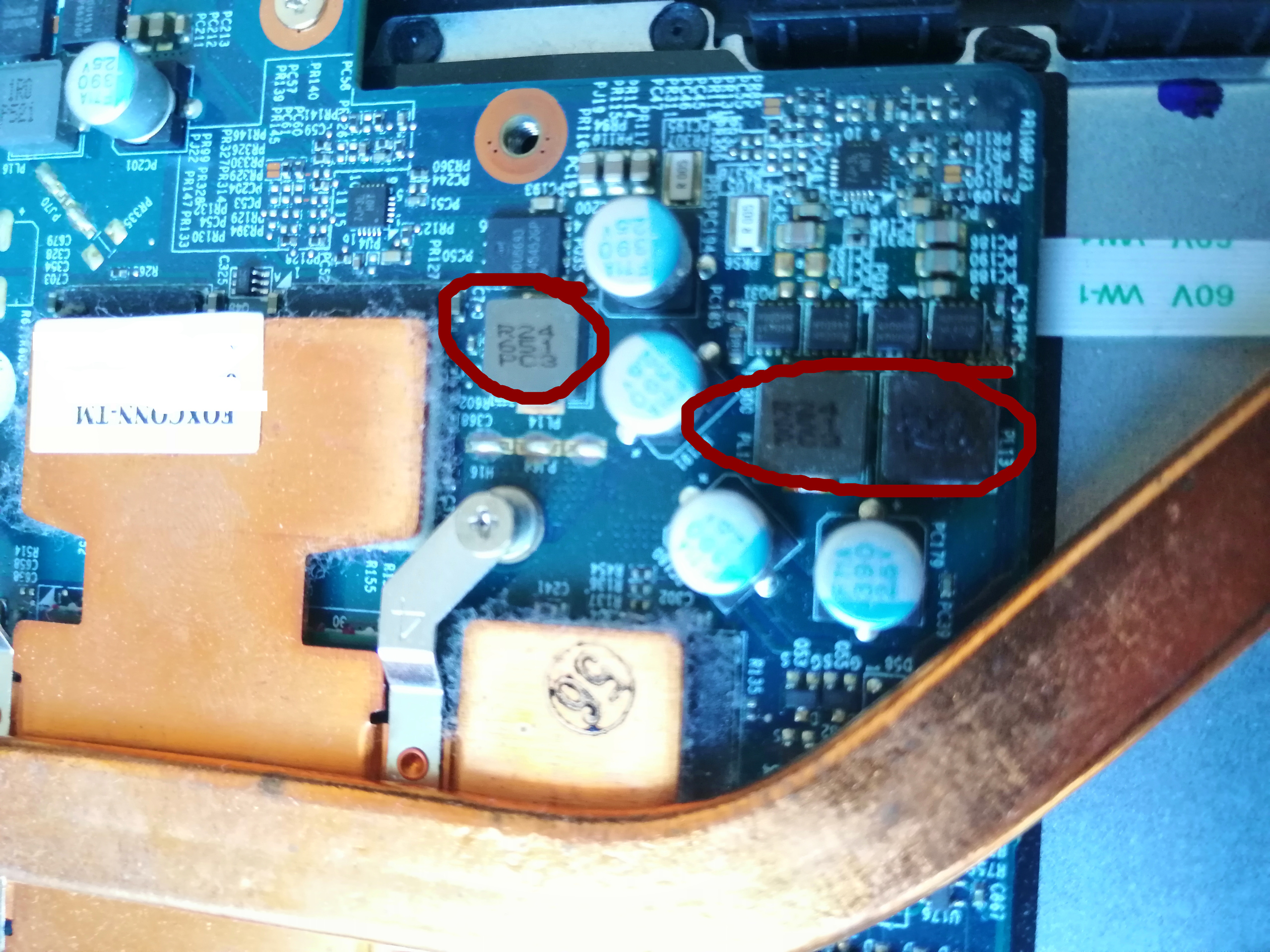

    Hi Forum!
    My laptop recently started smelling bad, stopped working.
    Further inspection I found a capacitor that turned black.
    I hope that just replacing the capacitor will bring it back to life, but I am not able to find any information about these capacitor.
    Its written R24 651 PC3.
    Anyone know what these parts are and where I can buy a replacement part for this?
    Thanks everyone!

    Re: Help identifying motherboard capacitors
    those are inductors - coils
      .24 microhenry?
      If that inductor has a problem, it is likely that something is shorted or drawing too much current.
        .24 microhenry?
        idk you tell me?
        Its a older laptop that was running well before. I agree that if that inductor got smoked, then something else probably went horribly wrong and I can discard the laptop...
          make & model?
