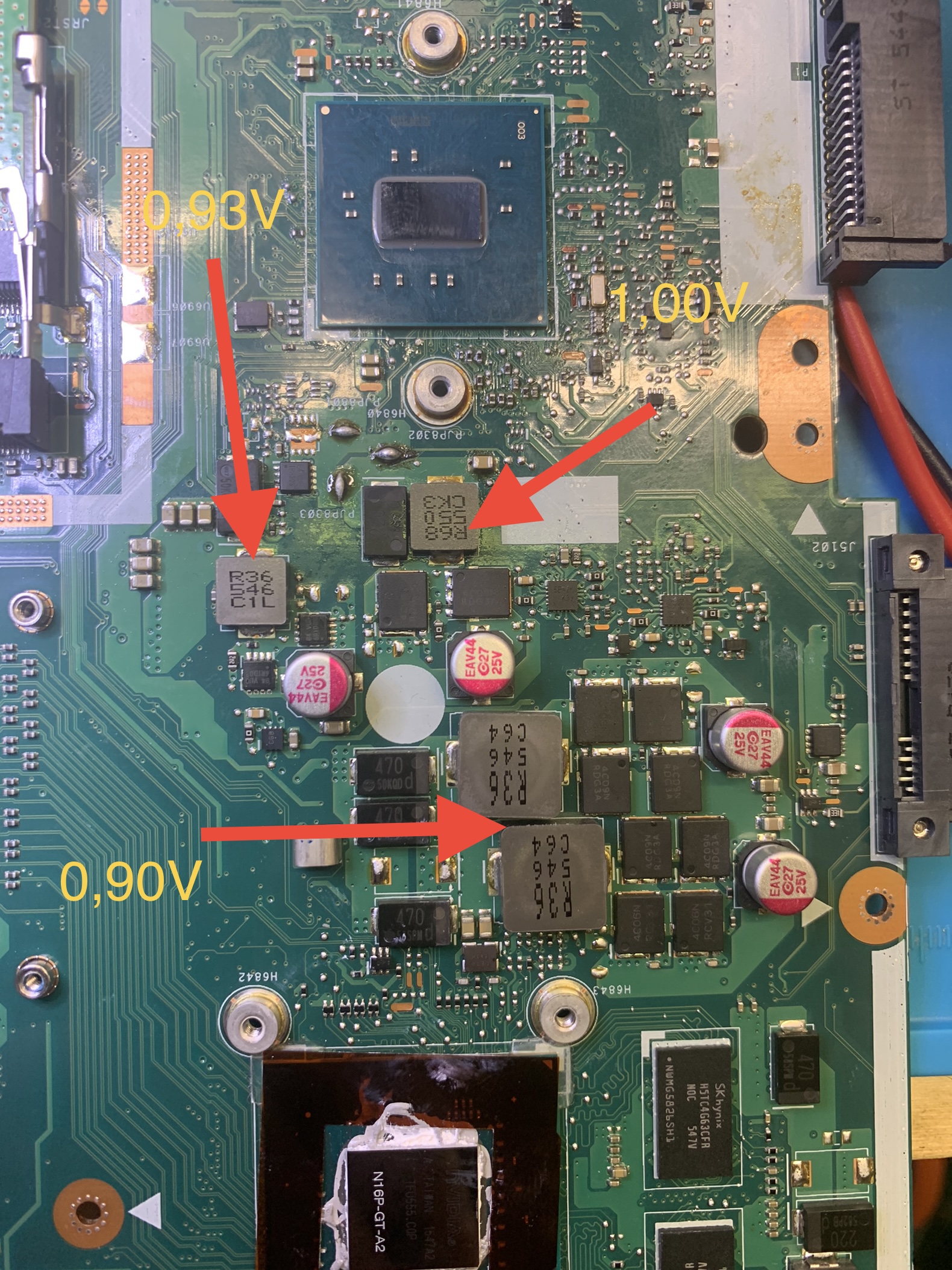

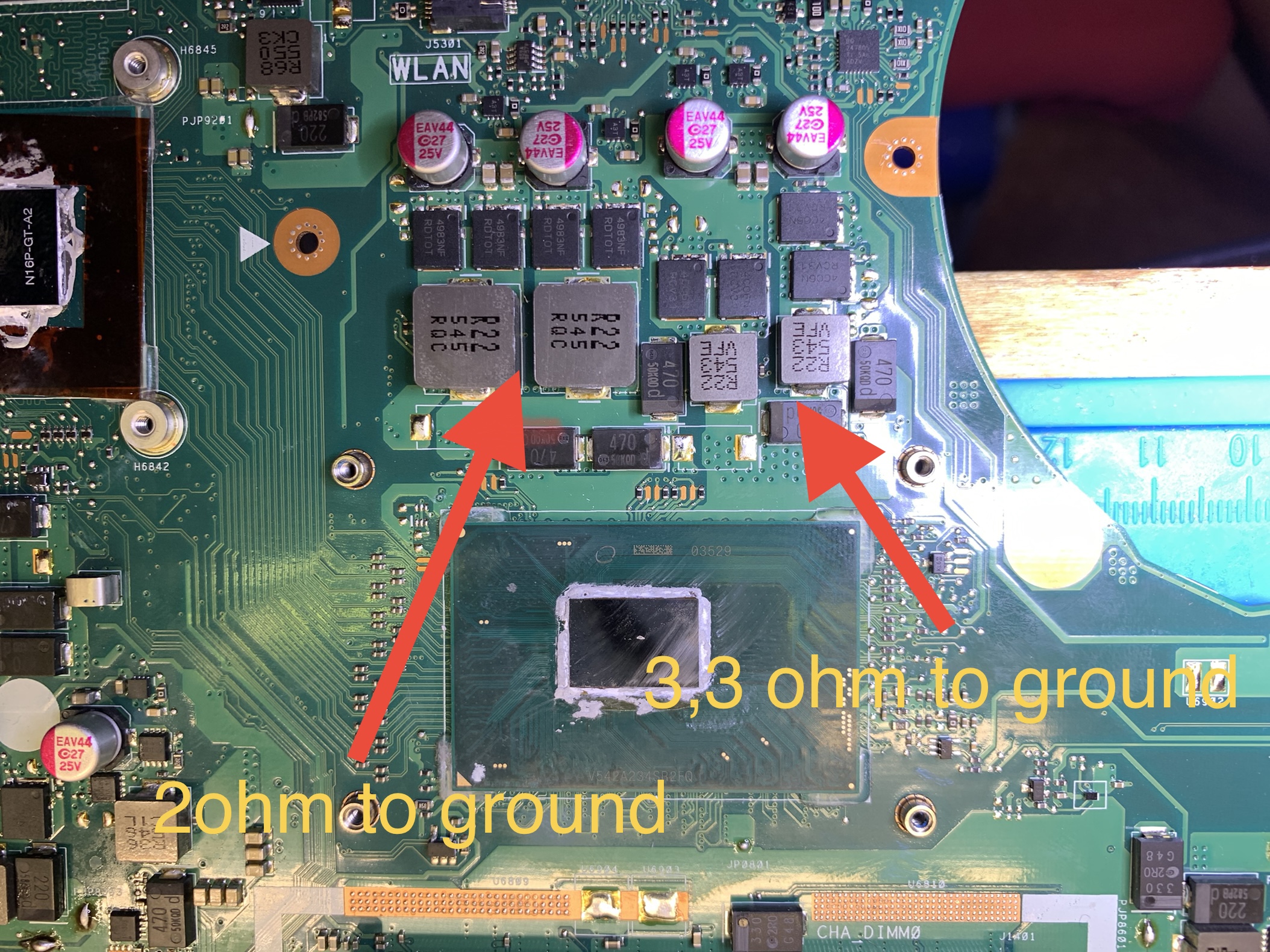

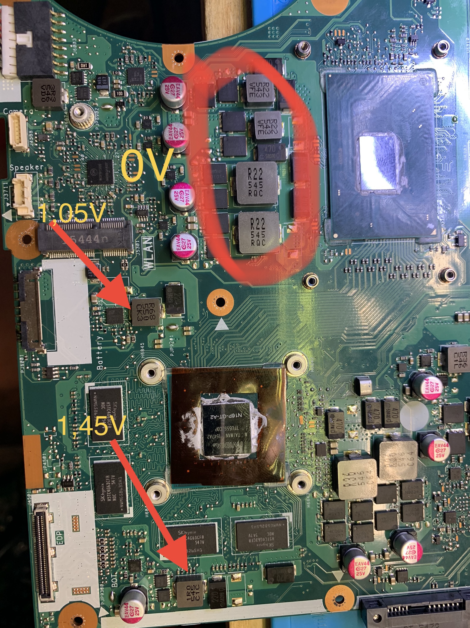

    Asus model N752V motherboard N752VX rev. 2.0
    This laptop comes dead.
    I checked PCH shorted, so after replacing it I get 3,3V 5V and other voltages except of two CPU rails as picture show.
    Seems not have other shorted components.
    I haven't schematic or boardviewer.

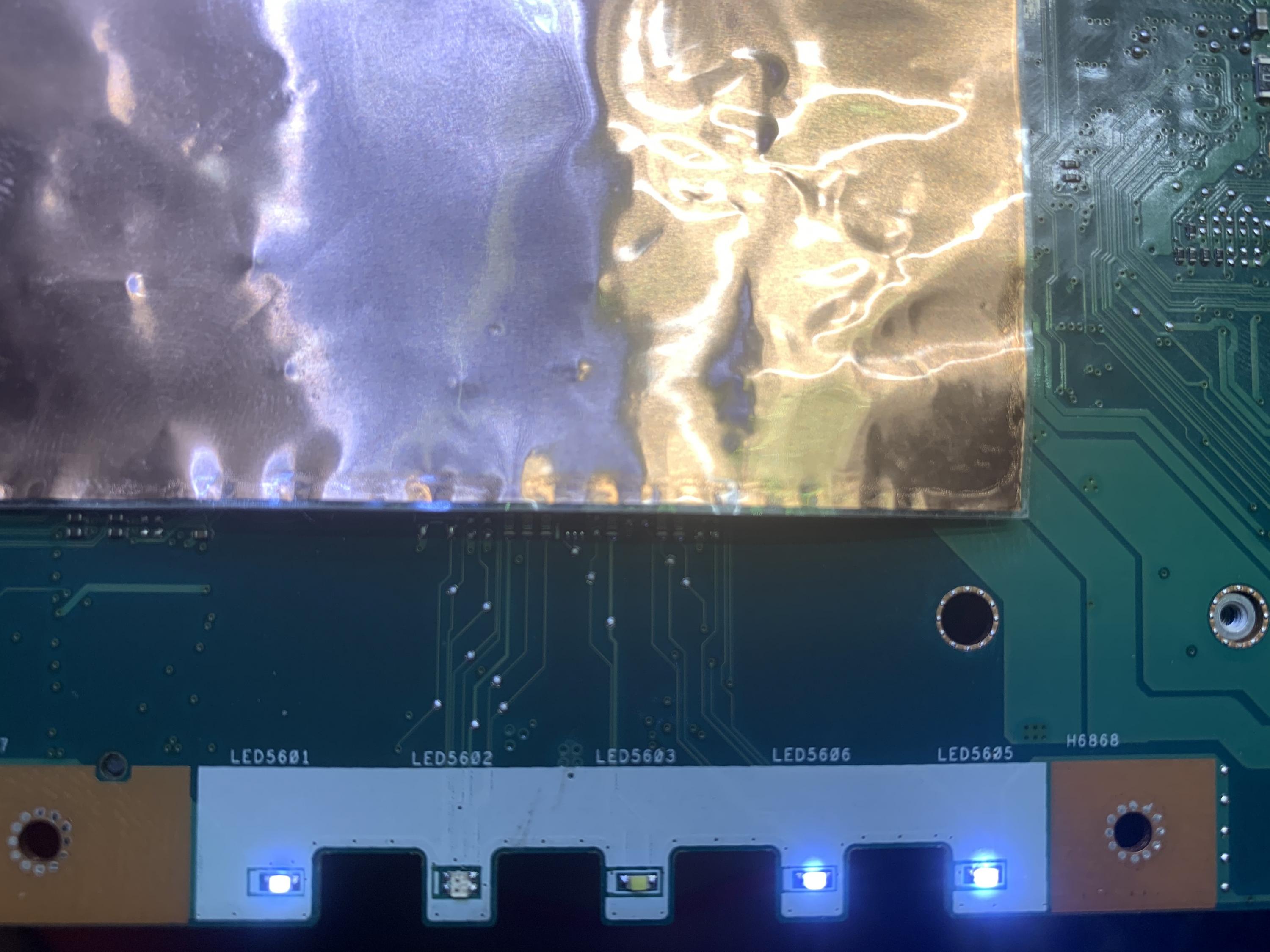

    After plugged PSU motherboard turns on itself with 3 leds on.
    Power consumption is 0,45A

    Likely +VCC_Core Missing and +VCC_GT, what you can ignore at this Point.
    I'd exclude corrupted BIOS at this Point. Is there a CMOS Battery present?

      Re: Asus model N752V motherboard N752VX rev. 2.0
      Bios flashed too.
      Possible causes about missing voltages?
        Missing Enable Signal, Dead VRM Controller, Dead Driver, Missing SVID communication, etc.
            Solved
            Flashed bios with a clear ME Region, now it working perfectly
