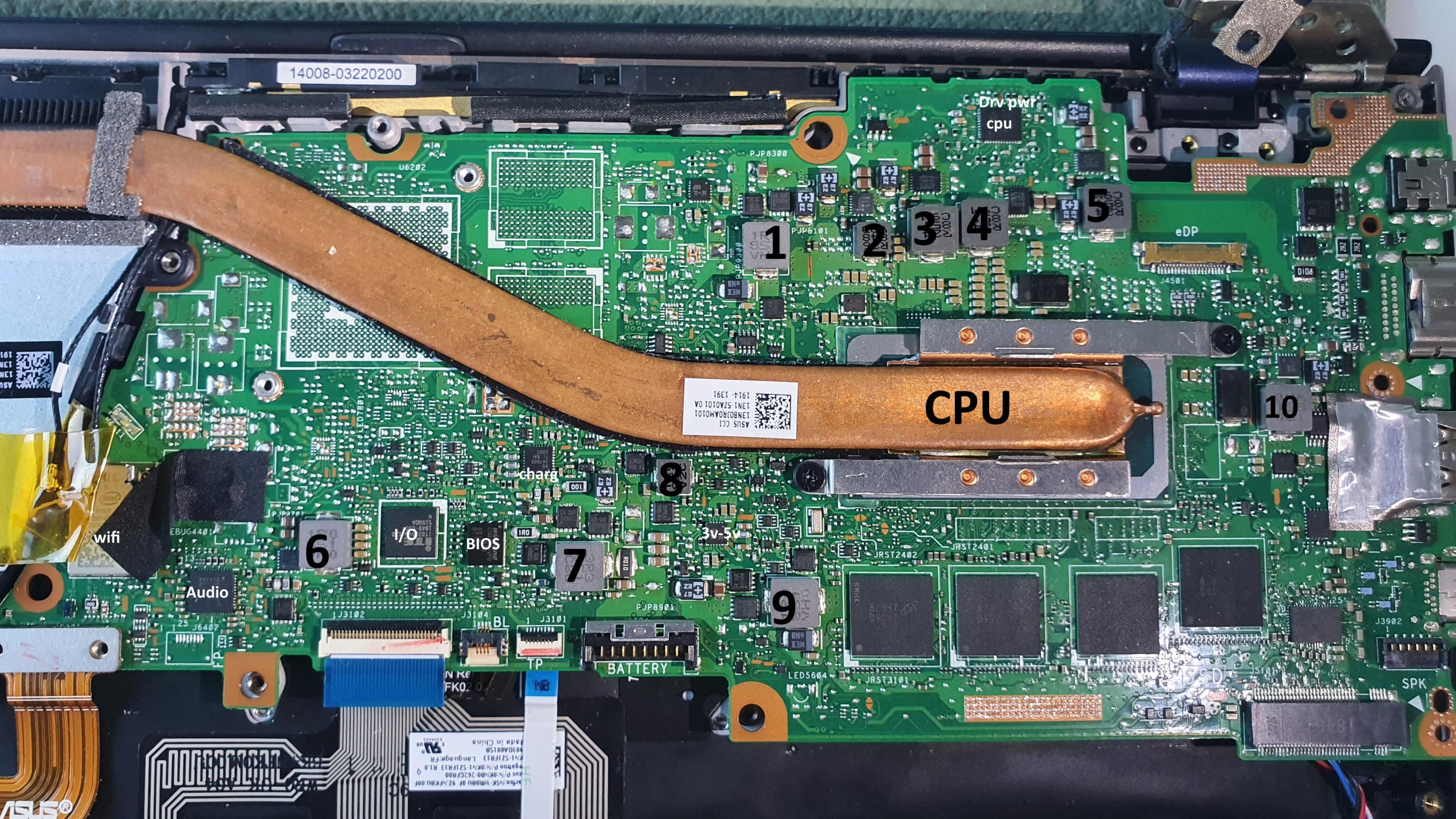

        Thx for the help, I identifyed some components and wrote on the picture.
        For coils (to ground) :
        1 – (close CPU) 63 Ohms
        2- (close CPU) 20 Ohms
        3- (CPU) 3.6 Ohms
        4- (CPU) 3.6 Ohms
        5-(close CPU) 3.5 Ohms
        6 – (3.3v) - Open line
        7 – Battery – Open line
        8 – ? Open line
        9 – (Ram) – 300 Ohms
        10 – (5v) – Open line
        I guess all rails are OK ?

          Re: Asus Zenbook UX433F (very light water damage)

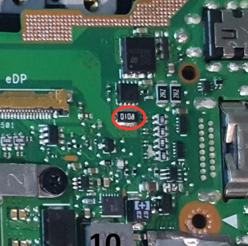

          Well done, Only Main Power Rail is Missing but the value there is important too. The other Rails seems fine Like you already guess.
          Measure on the Current Sense Resistor (any Side) shown in the Picture below.

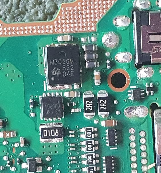

            Thanks for looking in the good direction ; at the right of mosfets, there is 3 « blackcaps ». You can see on this best quality picture. I guess it's caps. The 3 are shorted (side to side, not to ground).
            At shunt resistor, I mearuring 2KOhms but the value moving permanently very slowly to 40 MOhms, so not usefull until 3 caps are replaced.
            It is possible to deduce capacitors values ? There is no schematc for this laptop, but I have shematics for another laptop (gamer) and at the power jack, there is 5 capacitors in parallel :
            10uF x2 (size : 0805)
            0.1uF x2 (size : 0402)
            2200pF (size : 0402)
            I guess I can deduce at least 1 of 3 is 10uF but the others ? Maybe another 0.1uF ?
              • 21881
              The 3 parallel « blackcaps » are inductors/ferrite beads.
              • corrize
                • Apr 2021
                • 294
                • France
                Ha ok thanks, I never saw that before. I was amazed that they were so clean.
