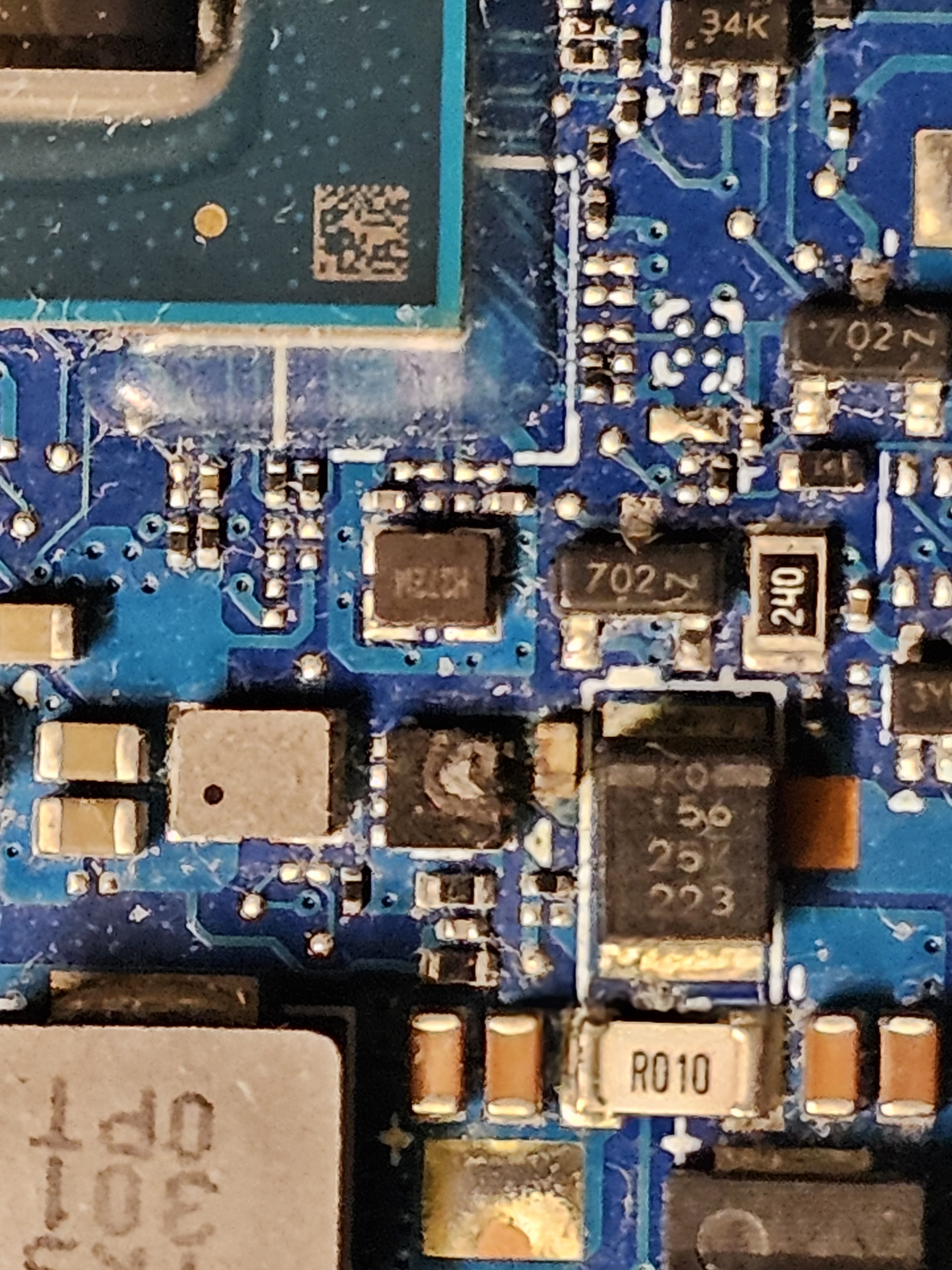

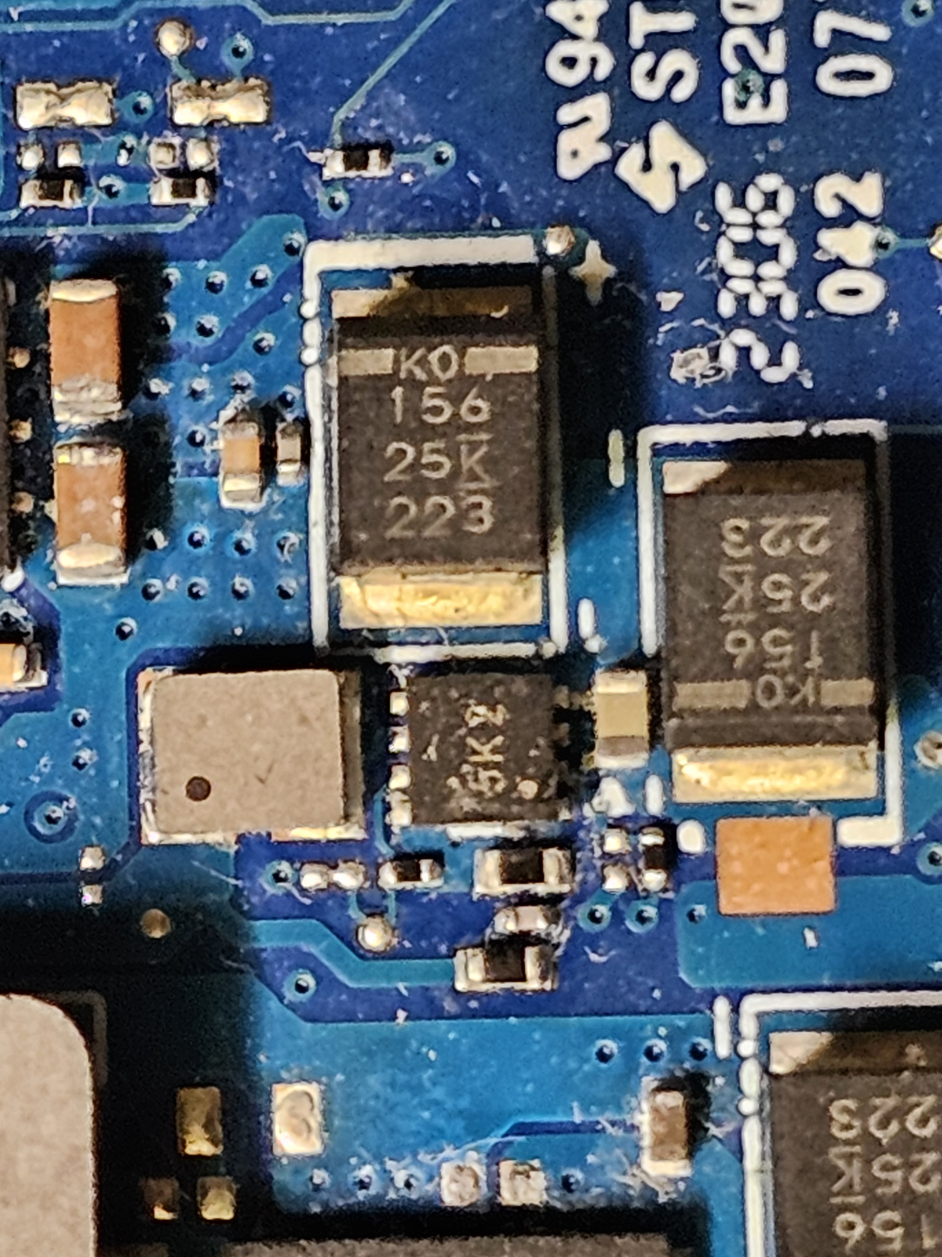

    I have got a water damage Asus Zenbook UX3404 (exact model no. UX3404VC-PURE5) where one of its component got burned, picture attached. MARKING ON COMPONENT is ONLY 5k6 !!
    Wondering does anyone know what is that component, it is located near the GPU. I have found out the same component near the LVDS cable on and that is how conclude that the suspected burned component
    Thank

      Thanks for the quick response. But it does not seems to be the right component since the burned component has only 8 pins.
      I compared again the layout with PCB and found that it is PU2505, can you please share the part no. of it ? and the capacitor below it

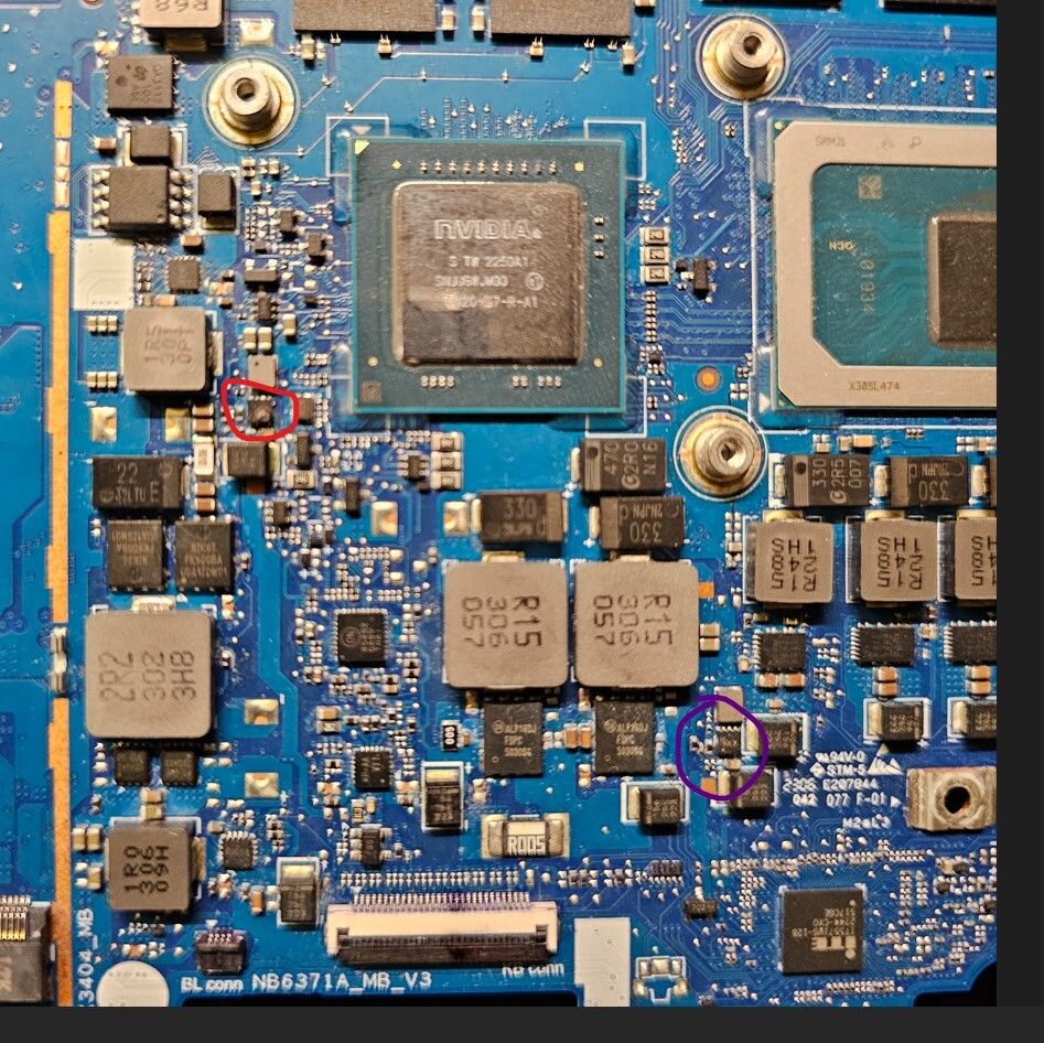

          Thanks again but that is not assembled in your board layout, can you please check the other similar component marked in PURPLE in the new picture attached
            23 Click image for larger version

              I can't find that component available nearby, does anyone have any alternative part number for the given component SY8883
