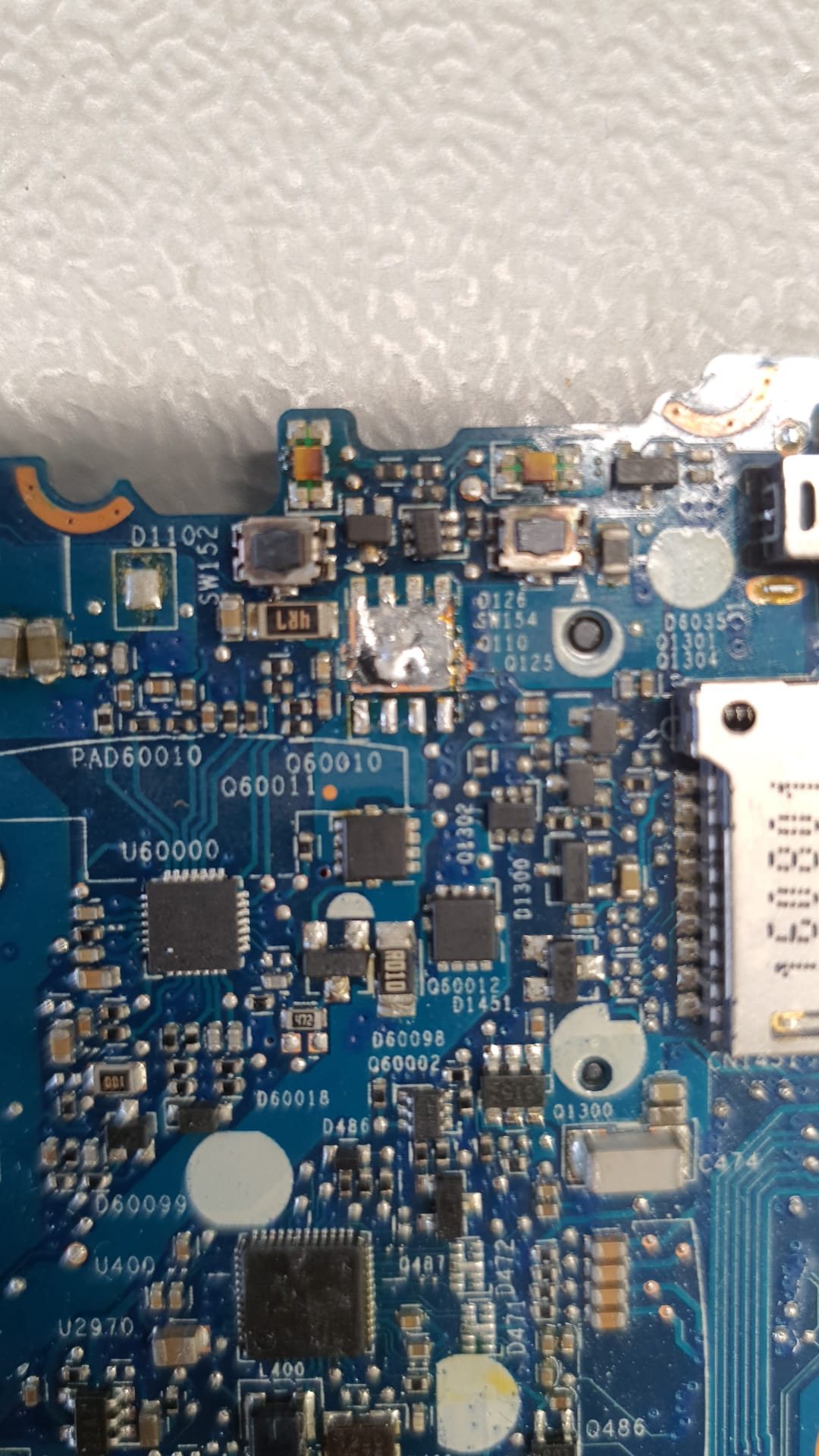

Hp 840 G3 board no: 6050A2822301-MB-A01 5V, 3V missing
  • mon2
    • Dec 2019
    • 13835
    Re: Hp 840 G3 board no: 6050A2822301-MB-A01 5V, 3V missing
    To determine if Q6010 mosfet is defective, remove all power.
    Meter in resistance mode.
    Measure the resistance across the mosfet pins:
    source (1-2-3) & drain (5-6-7-8)
    source (1-2-3) & gate (4)
    gate (4) and drain (5-6-7-8)
    Post all measurements.
    You can test each of the mosfets using the same method. If the resistance readings are low - the mosfet is defective. Best to post every measurement for a review.

      Hi, I can not findd L6035
      Q6010 mosfet measurement:
      source (1-2-3) & drain (5-6-7-8) 1,2 ohm
      source (1-2-3) & gate (4) 189 ohm
      gate (4) and drain (5-6-7-8) 190 ohm

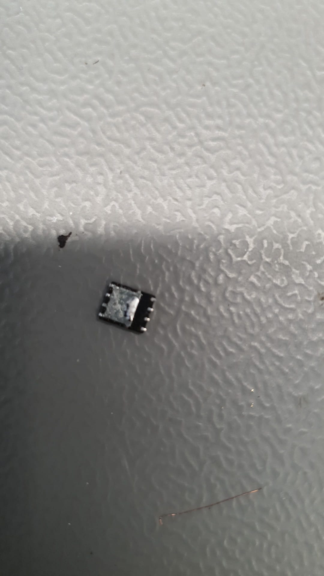

        Can you post a pic of one of these mosfet measurements?
        If indeed in ohms, the readings are extremely low and this part appears to be defective.
        If in ohms on the meter, remove this mosfet -> measure again the same readings but while it is off the logic board and on your work table. This will be the final confirmation that the mosfet is defective and needs to be replaced.
        Proceed to measure the other mosfets that follow this one in the schematic and logic board. Post each measurement.
          mosfet Q6010 is broken, short!
          on board now 120 KOhm
            Ok. So Q6010 will be required to be replaced.
            Proceed to test the other mosfets that follow this one so you can replace each for this repair. Do continue to update this thread.
