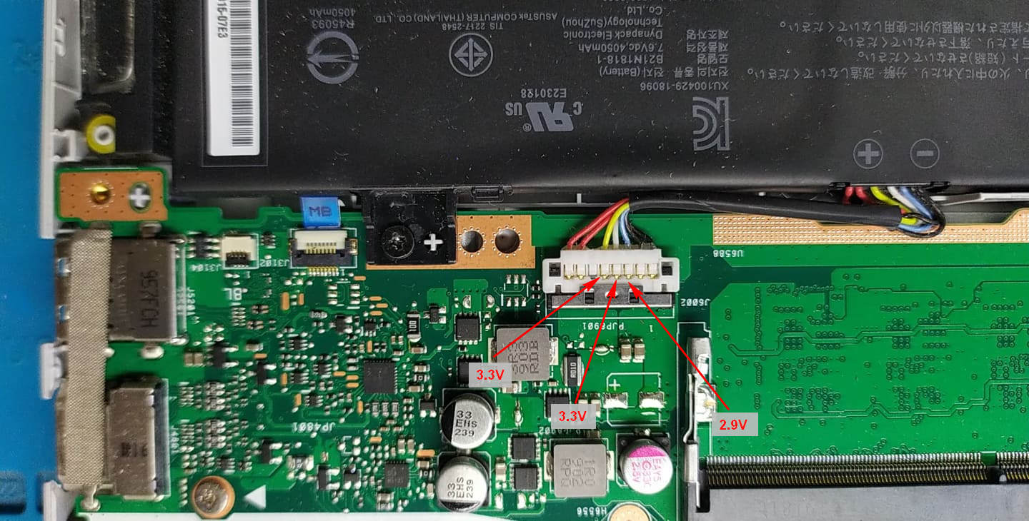

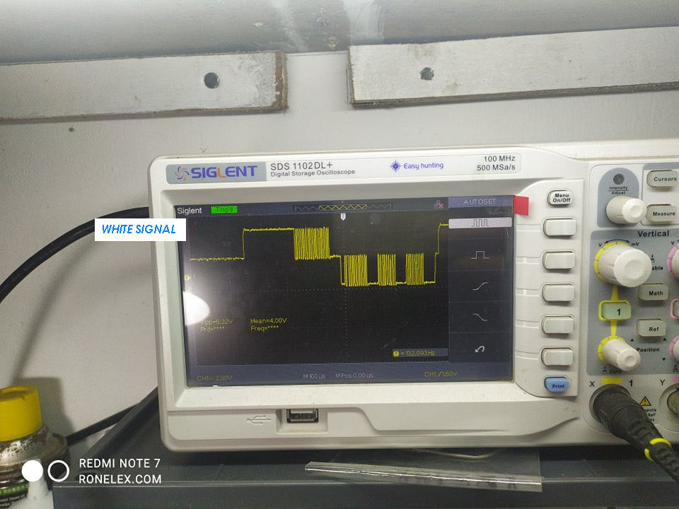

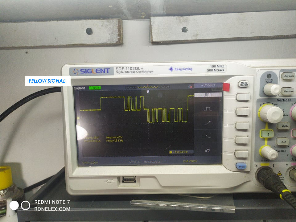

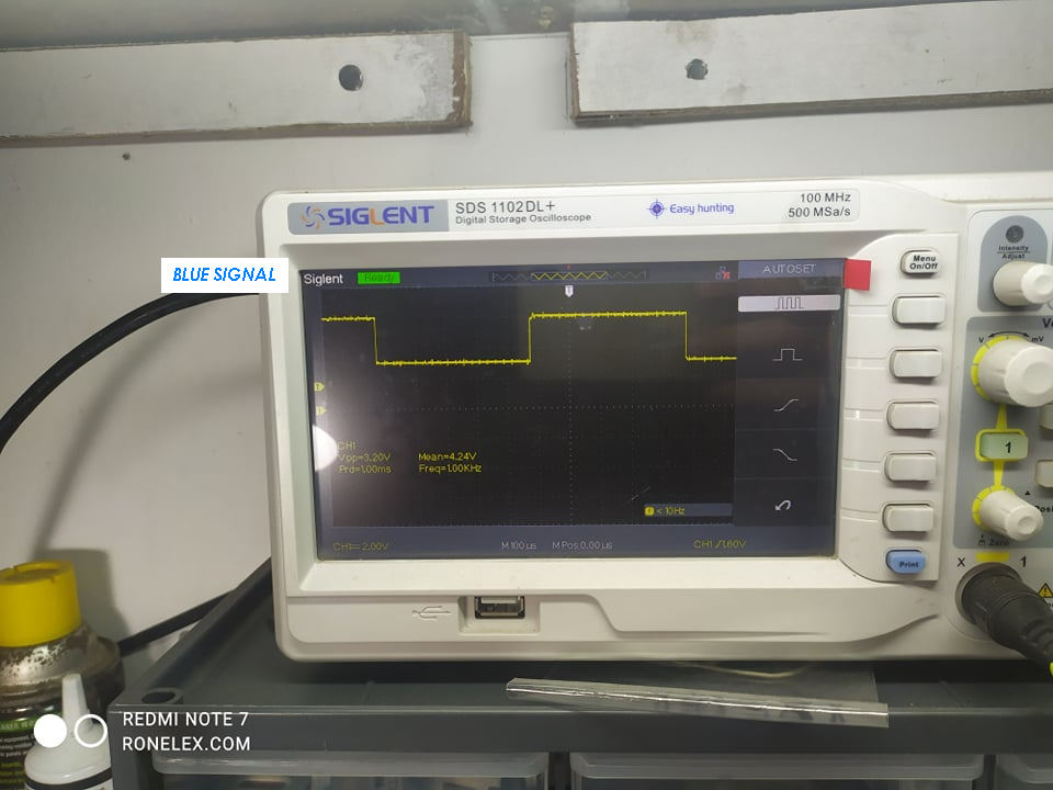

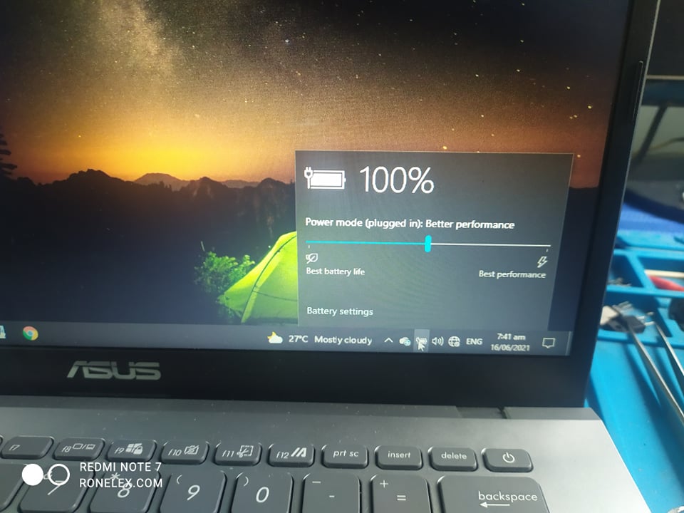

    Good Day to all,
    Can anyone help me on this unit? No Battery Voltage is read on ther battery terminal,
    If I hang the Battery the battery coil measures 8.5v in the circuit and lights turned Orange
    But if battery is attach it measures 8.5v upon plugging this reduce to 0.230v then the orange light turned white
    Maybe the battery need and en# signal but I cant locate because the unit dont have boardview file
    In the Windows, the battery states that it is 100% Charged

      Can you check the voltage on the battery connector with battery disconnected ?
