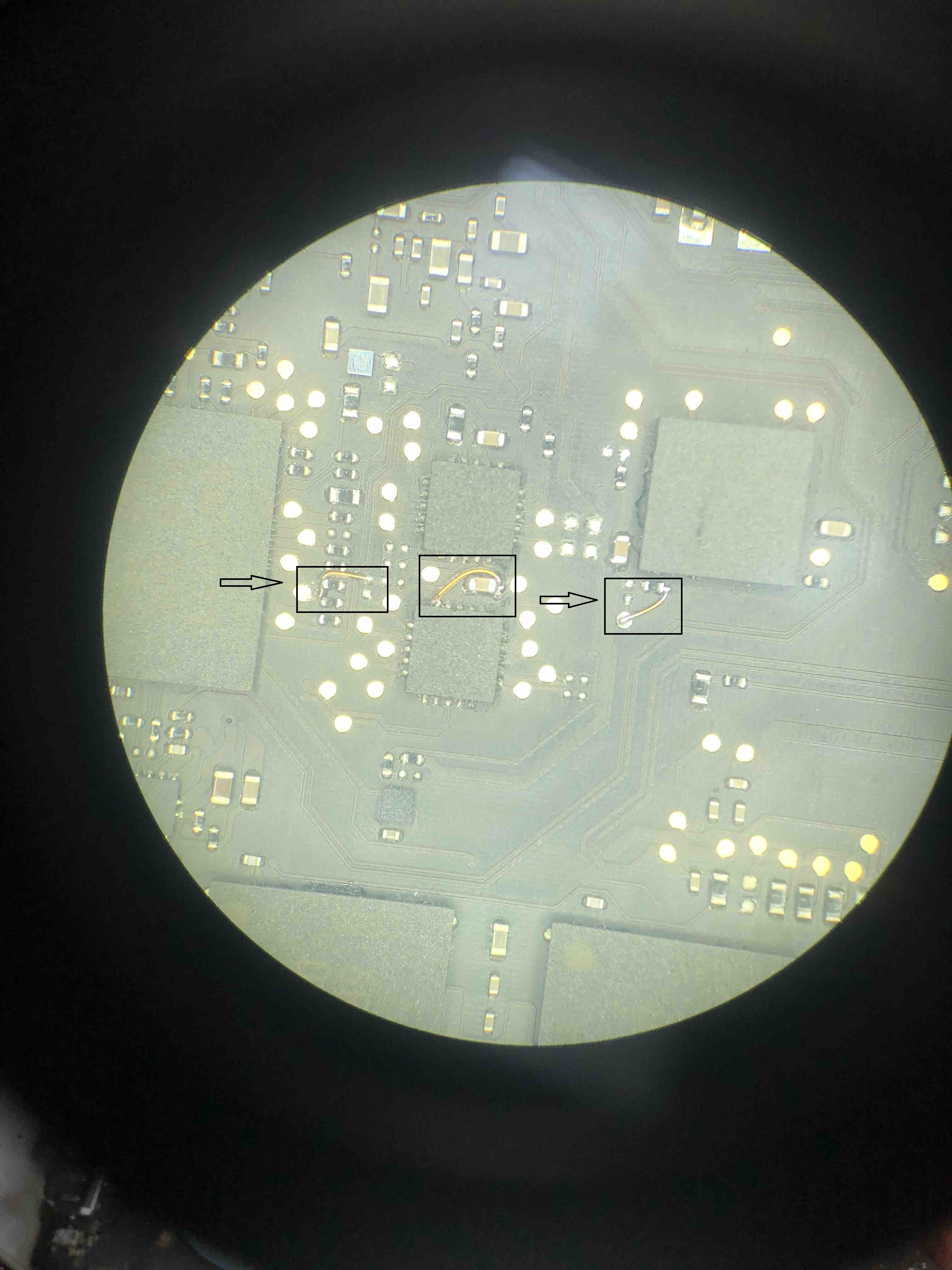

                              hello everybody, here the solution that i use in this case, i hope help all
                              Note: for good working is necessary OSX Sierra or older, maybe if you install upper this the machine after sleep show black screen.

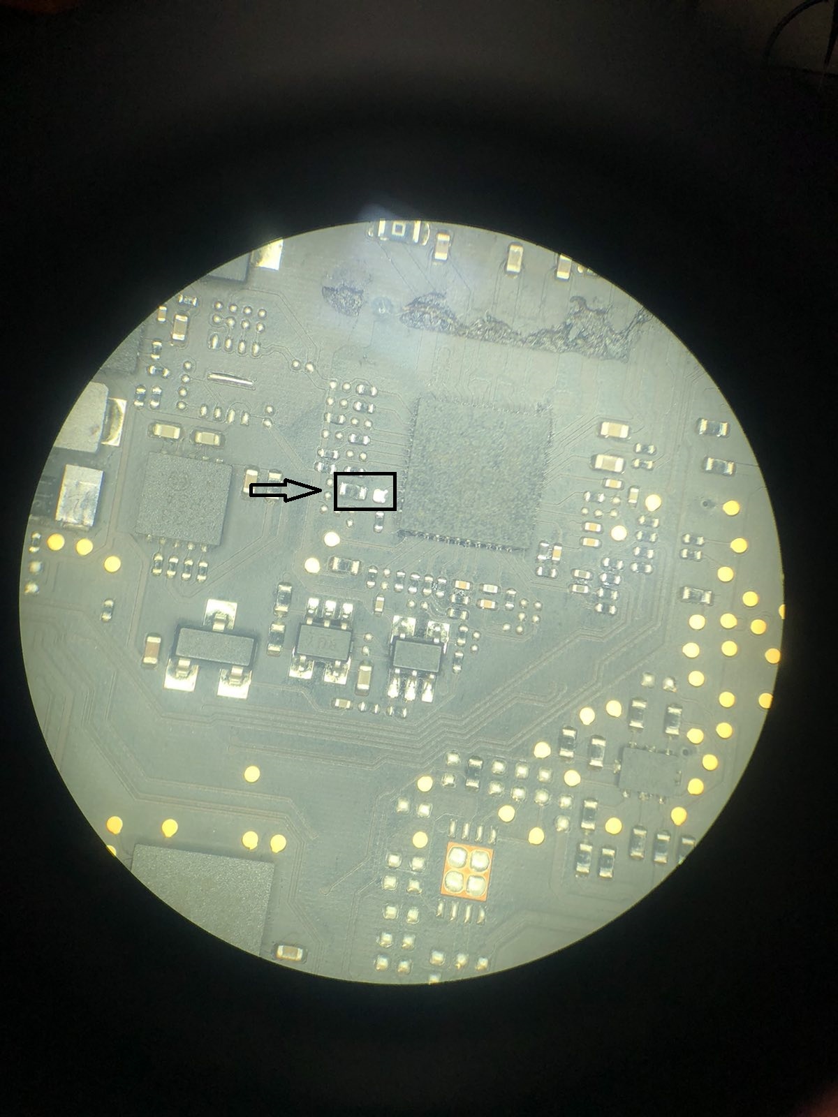

                                  Ok gays you wont solution.OK)))))
                                  LCD_MUX_EN - 3.3v don't climb, that's how it should be
                                  LCD_MUX_SEL - to GND
                                  LCD_BKLT_EN and LCD_PWR_EN - 3.3v
                                  DP_EXTRA_MUX_SEL_EG - to GND
                                  and GPU_VCORE_EN R8236 - should be deleted

                                      you need also one wire to enable backlight once mac goues in sleep mode (like when u close the lcd and reopen it). check that line in the attached picture and adapt on your logic board.
