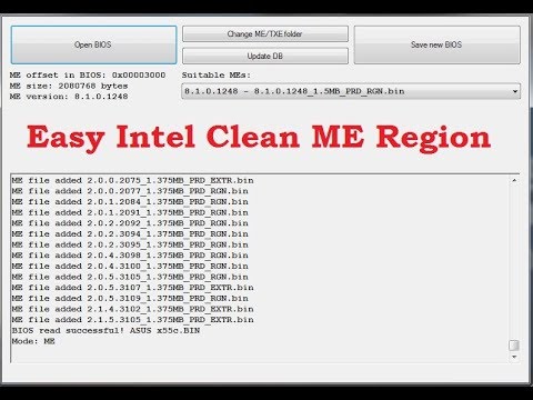

5. Bios backup and same bios cleaning to intel clean me region tool
