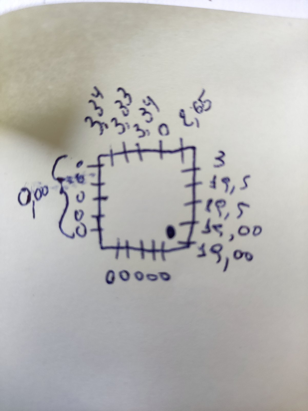

                Ι don't know how to distinquish , the "right" balls in the schematic.
                As i saw the chip (it's upside down) as we look the board.
                The values were like this , with the ball as you see it.
                But i cannot understand ,the "ball hole on the chip" what is the "correct on the schematic" i mean the correct side that the numbers start .
                So i have taken a photo for you to see ,those are the values i get as soon as i plug in the charger jack..
