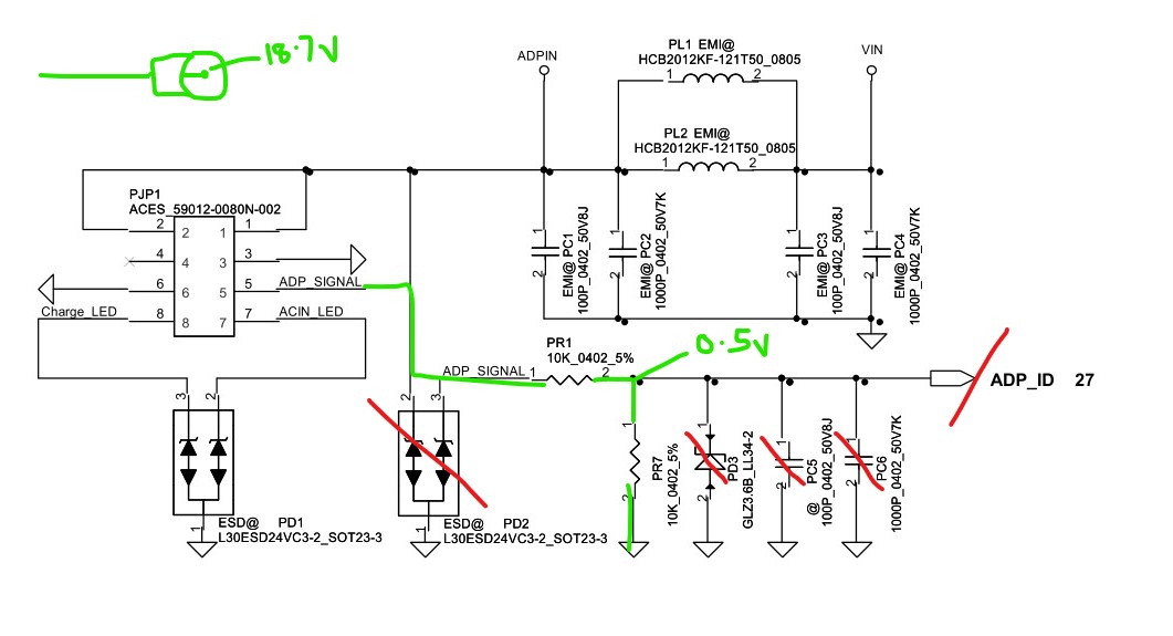

      This leads me to an issue that I'm having regarding the ADP_ID pin on the EC.
      That centre pin on my adapter is 18.7v and I'm getting only 0.5v approx. on that EC pin. Looking at the schematic, since the Zener diode is there and has a breakdown voltage of 3.6v, I'm assuming that the pin should be held around that 3.6v. Is this correct?
      Also, As a little exercise, I removed all of the components in that circuit, leaving only the voltage divider and it is still only 0.5v. I also cut the track to the EC. (see attachment)
      I have come to find that the DC connector is causing the voltage to drop down to 1v before the voltage divider. I'm trying to understand why that is? Is the DC connector designed to do that? I have tried to connectors and it's happening in both cases.

        resistance on that adp line?
        middle pins is vulnerable to damaged connector which put 19V to middle pin. burning EC

          Hi, Resistance on the ADP line is 10K ohms.
          Mind, I have now cut the track to the EC. However, it was 10K even when the track was in tact. The EC didn't heat up and the laptop is/was not drawing excessive current (20mA before pressing the power button and 150mA a few seconds after pressing the power button.
          The middle pin on the adapter is 18.7v. I assumed that this is ok since the adapter is working fine on my other hp laptop and is supposed to be compatible across all laptops.
          What's more, if I bypass the dc connector and connect the power supply directly to the board, the voltage doesn't drop to 1v on the adp line before the voltage divider as shown in the screenshot above.
          With the power supply going through the dc connector, it drops to 1v on that adp line. I'm wondering, is there a resistor in the dc connector at all?
