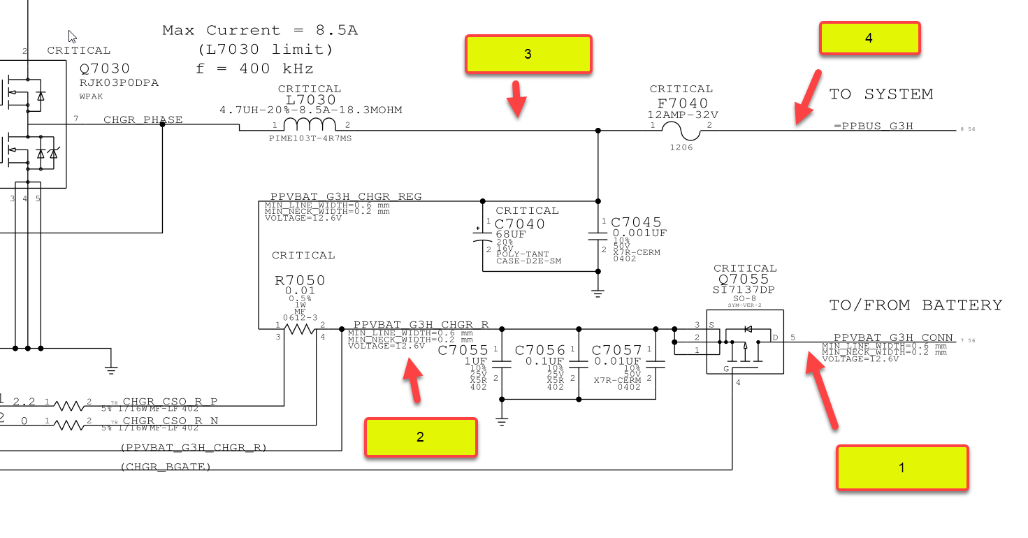

    hi everyone
    i have a macbook pro 820-3462 works off battery but its charging cycle 136
    voltage measured adapter not plugged and battery in charged 100%:
    PPVBAT_G3H_CHGR_R :12.8v
    CHGR_CSO_P :12.47v
    CHGR_CSO_N :12.47v
    SMBUS_CHGR_SDA : 3.4v
    SMBUS_CHGR_SCL :3.4v
    CHGR_RST_L : 3.38v
    CHGR_BGATE: 5.5v
    CHGR_PHASE : 12.47v
    CHGR_UGATE : 12.25v
    CHGR_SGATE : 12.15v
    CHGR_CSI_N : 11.95v
    CHGR_CSI_P : 12.18v

      my question is why the motherboard cant work off batteries,the problem is the battery or something else?

        Re: Macbook Pro Retina works off battery
        See attached.
        1) Start with reading the voltage on F7040, pin # 2 with external adapter attached. What is the voltage for PPBUS_G3H ?
        2) Next, power down and remove the external adapter. Use the battery only.
        List the voltages from the attached diagram.
        Do you see the PPBUS_G3H with a similar voltage as supplied by the battery? (NO EXTERNAL adapter should be attached)
