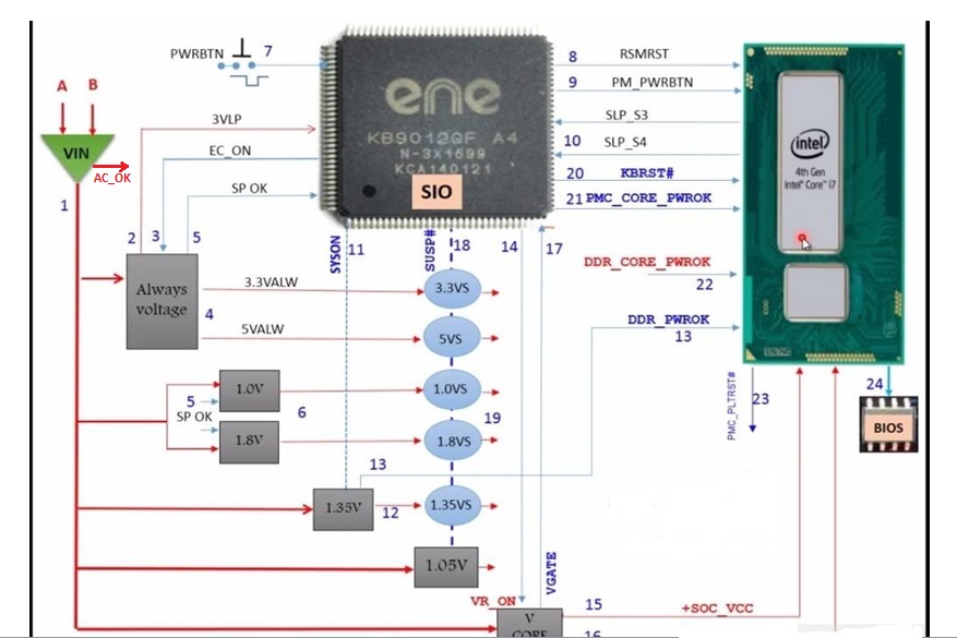

                  • Sametbey
                    • Jan 2021
                    • 229
                    • Turkey
                    Re: HP G62 star reverer - missing +V5A rail
                    AD_ID activates the charge control chip when the adapter is installed. Then the charging chip generates the signal AC_OK + 19V is supplied to the system. PU850 STBY chip generates +3.3 V LDO voltage. IO works, BIOS gets the program. It sends the signal to PU850 and output 3.3 VALW to 5VALW. PU850 pwrgood sends signal to IO. IO waits, the SYS opens when the POWER button is pressed.
