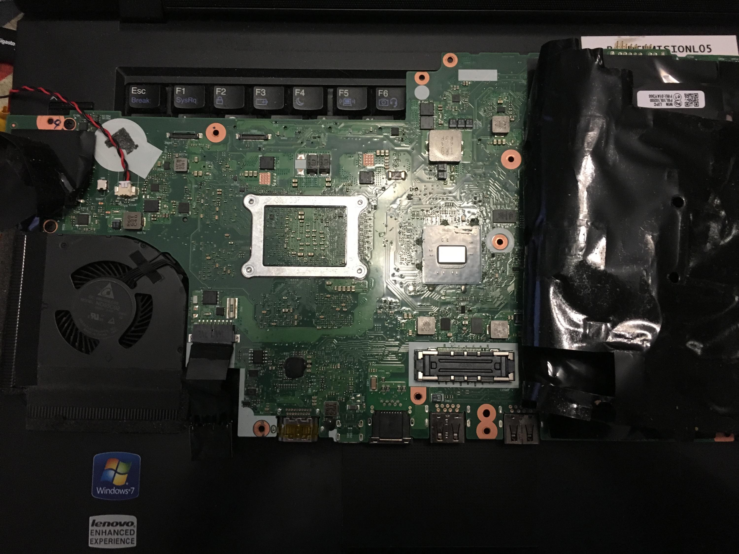

    Lenovo P50 NM-A451 no power
    My ThinkPad P50 laptops suddenly died on the docking station without any sign of life. I had to buy another P50 motherboard from eBay to get my work done. I just swapped the motherboard out and I am reusing everything including memory sticks, and hard drive, docking station, power supply, and battery pack. Now I have this dead motherboard. It has no LED light near the DC-in power jack with power supply plugged in. I get 19.95V at DCIN. I need this P50 BOARDVIEW to help me go further. I tried to download and install the P50 BOARDVIEW for debug. But the BOARDVIEW application Tebo-IctView.exe failed to install saying missing BaseTool.dll, Interface.dll, IctData.dll, and IctViewLicense.dll. I am running Windows 10 Pro. Can somebody light me up on this?

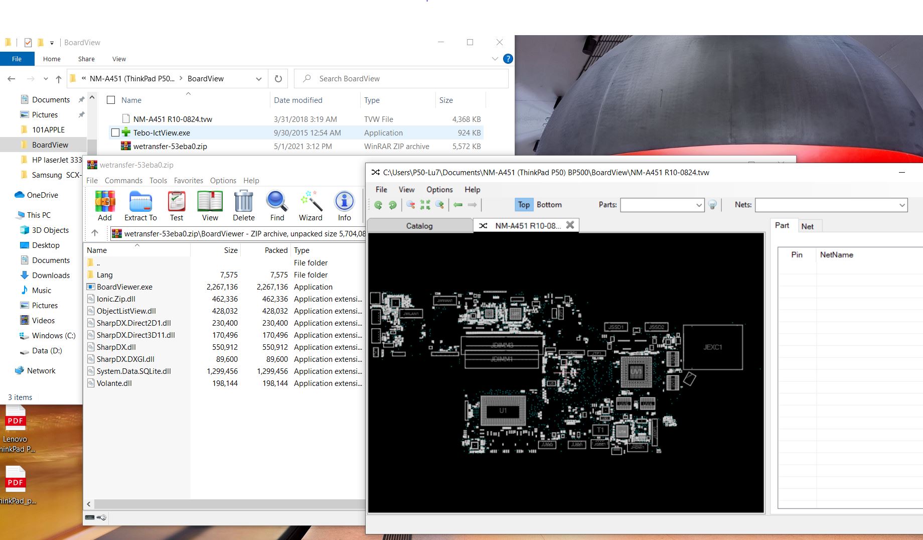

    @fromtexas1, see my post here:
    https://www.badcaps.net/forum/showthread.php?t=95401

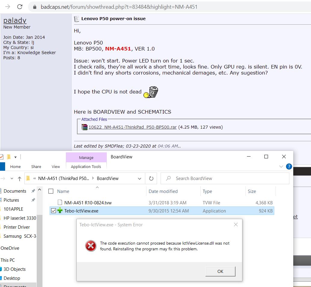

    download and extract the boardview fileset and run directly from the extracted folder.
    then load your .tvw file and see if it will load for you.
    post your results.
    • fromtexas1
      • Apr 2021
      • 8
      Re: Lenovo P50 power-on issue
      Great! Here are the posts.
      I followed your instruction and loaded ThinkPad P50's boardview file NM-A451 R10-0824.tvw. Let me know if I am doing correct. I need more help here on how to know what the voltage or resistance should be on a node of interest. See attached.

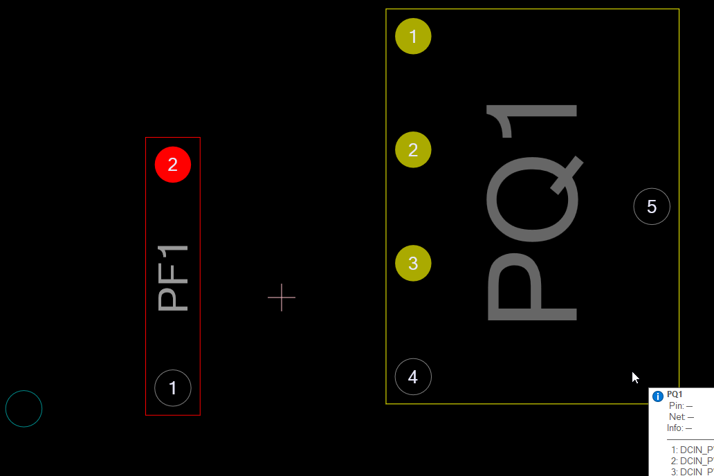

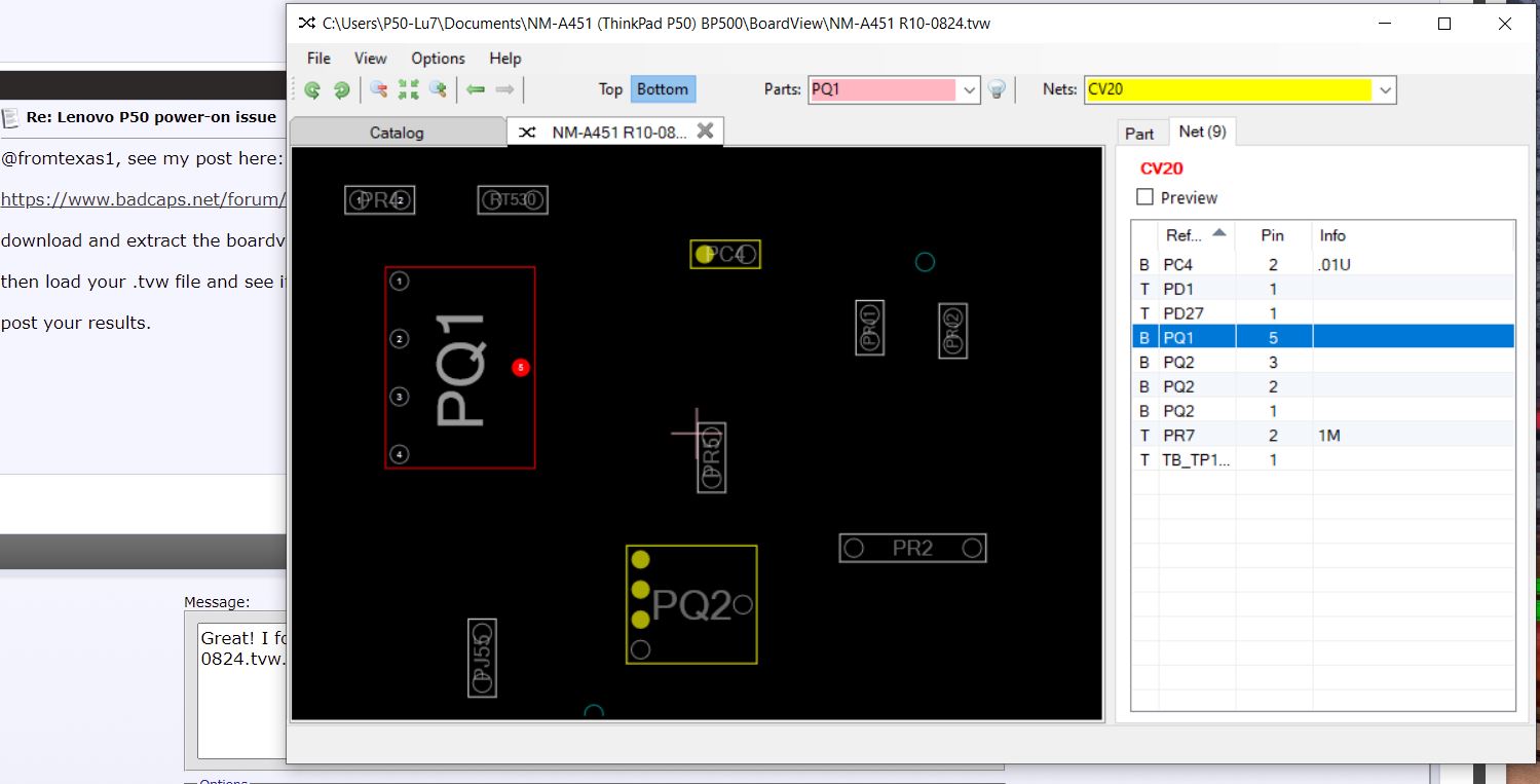

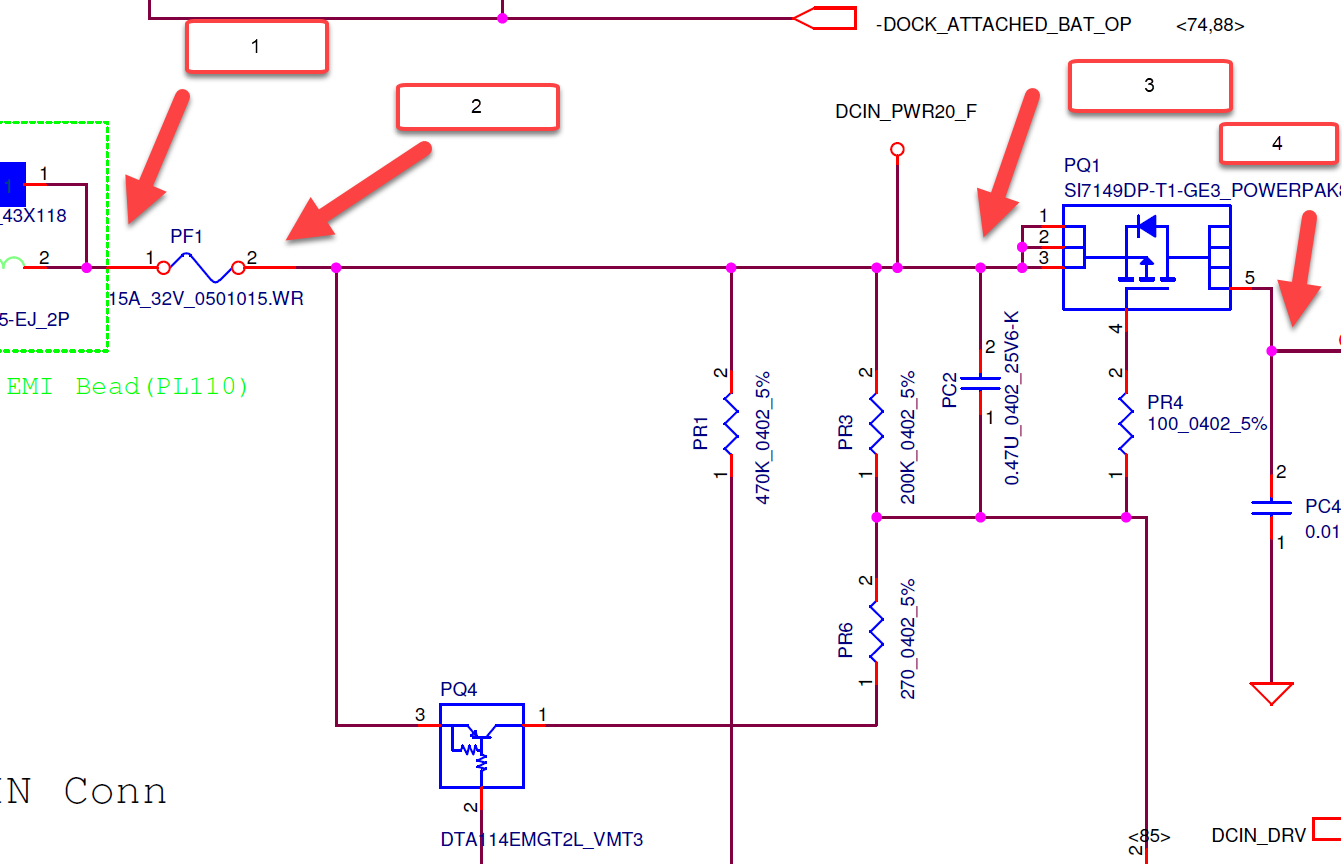

        Ok. Review the attached partial schematic and check the 4 locations as noted in the schematic.
        1) Fuse PF1 ok ? DC IN should appear across the fuse on PF1, pin # 2
        2) MOSFET PQ1 - DC IN value should appear on pin # 1-2-3
        3) MOSFET PQ1 - DC IN value should appear on pin # 5 when powered up / ON.
        • fromtexas1
          • Apr 2021
          • 8
          The continuity test shows the Fuse PF1 is good. DC-IN 20.64V appears on both ends.
          DC-IN 20.64V on PQ1 pin # 1-2-3
          Odd: DC-IN 20.64V on PQ1 pin #4, too
          DC-IN value on Pin # 5 is 0.042 V only.
          I have no way to know if it is powered on or off when I press the power button because there is no LED light on power button when I press the button.
          PQ1 testing:
          Meter in Diode mode shows 0.501 V across PQ1 pin # 5 (positive) and pin # 1-2-3 (negative), even on pin #4. It is open in reversed probing.
          So I cannot tell if PQ1 is dead.
          Any tips?
          Thanks.

            For the mosfet to turn ON, pin 4 has to be lower than DC IN rail. That is, the closer the value on pin 4 (gate) is to zero, then the mosfet will then turn on. Often a voltage divider is used to lower the gate voltage. Will study the schematic tomorrow to see how they wired this up.

              More update:
              I measured the resistance across the capacitors PC4 (bottom side) and PC5 (top side) to be 431.7 KOhms and 427.8 KOhms, the capacitance to be 0.30uF for both respectively. In Diode mode, probing across PC4 positive to ground showing 2.27V and negative to ground showing open.
              Thanks, Josh

                I found the data sheet for the power P-channel MOSFET SI7149ADP-T1-GE3 and it shows that the Vgs threshold is between -1.2V and -2.5V. The PMOSFET will be on if the gate voltage is 1.2 to 2.5 volts lower. My measurement on the Vgs is 0 Volts, the Vgate to ground is the same as the Vsource to ground. So in other word, the gate and the source is connected to each other somehow. The only explanation to this is that the gate oxide on source side is punched through and gate/source connected to each other in some way.
                Based on this assumption, I measured the resistance between gate and source of the PMOSFET to be 202.71KOhms (PR3+PR4). After switching the multimeter to Diode mode, it showed 2.27 volts with positive on the Gate and negative on the Source; or open with negative on the Gate and positive on the Source. It's acting like a diode between the Gate and the Source with 2.27 volts as turn-on threshold voltage value.
                So it looks like the Power PMOSFET is blown.

                  PR3 on the logic board is giving this resistance reading (source / gate).
                  Can you remove this mosfet and perform your measurements again?

                                  hi there. im trying to diagnose this thinkpad p50 also. ive got the same issue where tebo cant open due to all the missing files, just like post #1. ive searched for about 3hours trying to get it to work and to find the files elsewhere but im having zero luck finding the files, or the BRD for this laptop to use in OBV.
                                  any chance you could send me the filed to get tebo working? ive even installed tebo but theres no lisence..
                                  edit: i managed to get it running with boardvierwer
