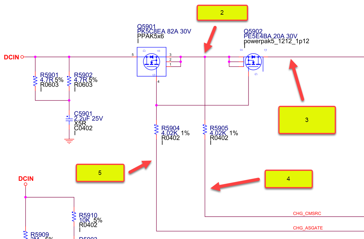

      yes the sot has on pin 2 battery power and pin 1 20v dc, pin 3 is only putting battery power out, before resistor 12,05v after 11,8v
      I now charge it with adapter in AND power on battery plus, I gues due to the charge chip.
      do you have advise for me regarding the q5901 mosfet ?
      on adapter power only it does nothing.

        Re: Lenovo 320s no power no led
        With the battery charged, are you able to power up this computer ?
        1) Remove the battery and apply your external adapter voltage (20V?) onto DCIN like normal. Confirm this voltage is reaching pin 1 of the diode @ D5902. If D5902 is working correctly and is a dual diode with common cathode, pin # 3 of D5902 should be a voltage close to DCIN value (0.3 to 0.6 volts lower due to the forward voltage drop of diodes).
        What value do you see with only the DCIN mated with an external power supply on pin # 3 of D5902?
        This voltage will then go through the 4R7 pair of resistors and continue to power the ISL power supply IC.
        If this ISL device is working ok and not burnt out, believe that the Q5901 and Q5902 will then enable to power your logic board.
        As you have seen the logic board working already, Q5901 - Q5902 and this ISL components may be working ok. TBD once you confirm the diode.

              3) If not working with the adapter, remove the battery - now the one leg (pin 2) of the dual diode will be zero volts (since the battery is removed). The other ANODE (input pin # 1) to the same dual diode (D5902) will be DCIN voltage @ 20V. Cathode, pin 3 should be close to this value -> enter the 4R7 ohms with a similar value. Please confirm. ISL should then enable the mosfets @ Q5901 and Q5902 (unless they are damaged).
              Please share the readings for the locations 1..5
              • Jeroentje
                • Dec 2017
                • 82
                • Nederland
                1) yes!
                2) correct
                3) yes confirmed (both), 20v, repair is succesfull
                pict 1
                1) 3.6
                pict 2
                2. 3,6
                3. 3,6
                4. have to find it
                5. have to find it

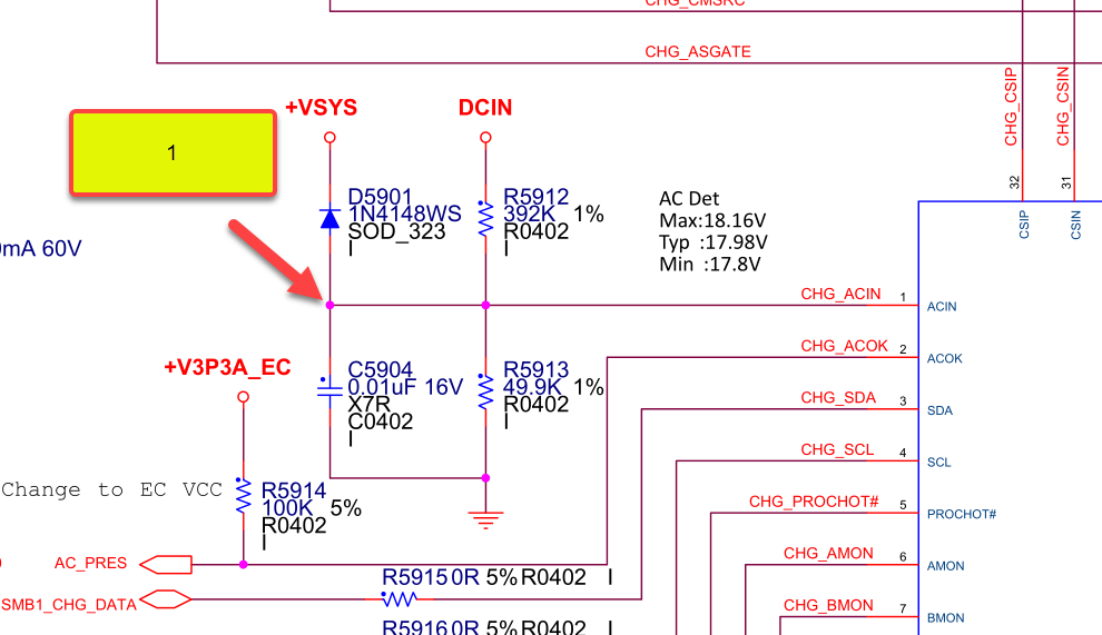

                • mon2
                  • Dec 2019
                  • 14012
                  Ok.

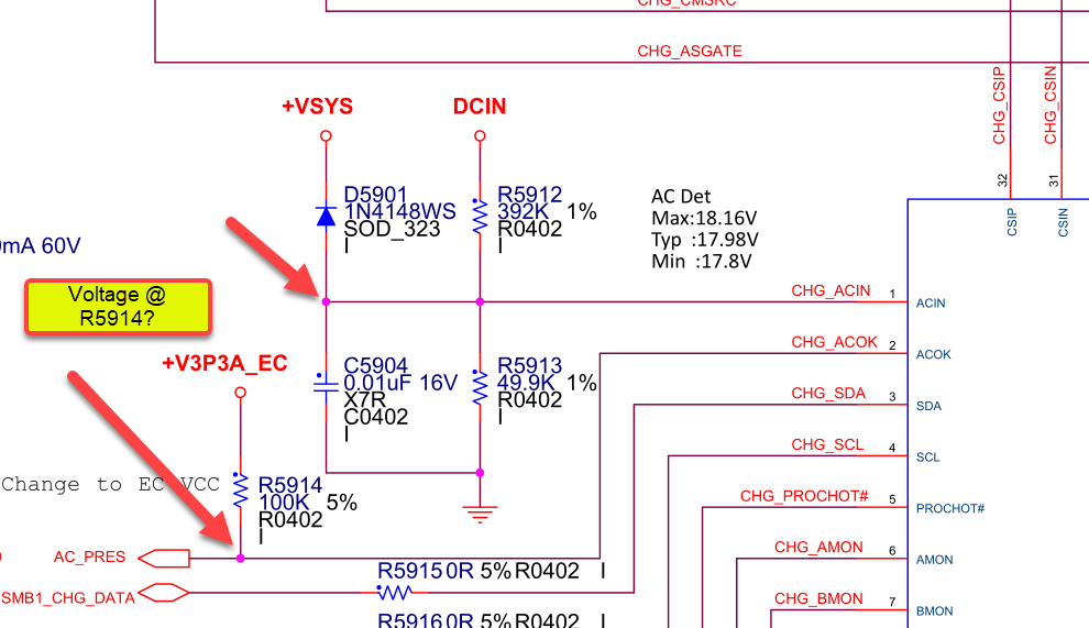

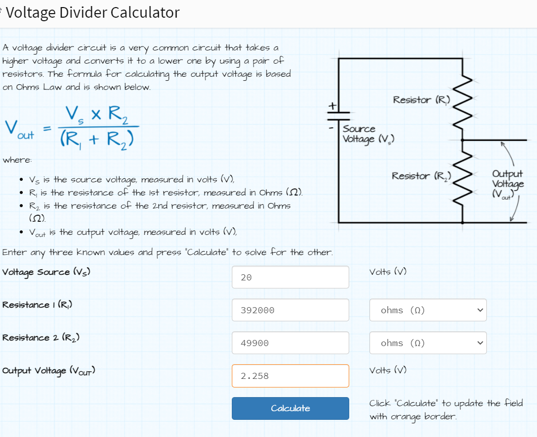

                  1) Check the status line with label AC_PRES. This line should be be HIGH if the external adapter is present and LOW if removed. First monitor the resistor R5914 and one side will be always +3v3 to match the +3v3A_EC rail. The other side of this resistor should be HIGH = +3v3 with the external adapter connected; LOW = 0 volts with the external adapter removed. This is for the ACOK pin on the ISL regulator.
                  2) According to my voltage divider calculations, the value @ ACIN should be about 2v3.
                  https://ohmslawcalculator.com/voltag...der-calculator
                  3) Power down, remove battery and external adapter. Check the resistance of R5912 and R5913. Do the values match the schematic ? This may not be an issue but if the ISL is operating @ 3v3 internally then 3v6 is very borderline dangerous to the IC as a max voltage.
                  Summary - the ISL detects the presence of the external power adapter (20v) by using a voltage divider to lower this high voltage to a safe value that is acceptable to the ISL component. You are reading 3v6 when the DCIN = 20V. It is a bit high, according to the calculator but may not be an issue. Do post the resistor values for the divider.
                  Once the ISL detects this external adapter through ACIN pin, the ACOK pin should be logic HIGH = '1' = +3v3 (or close to this value). That is my understanding of this undocumented IC (similar to the ISL9241, etc. which is documented).

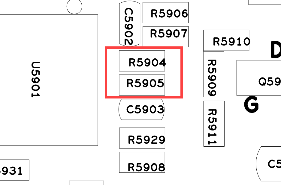

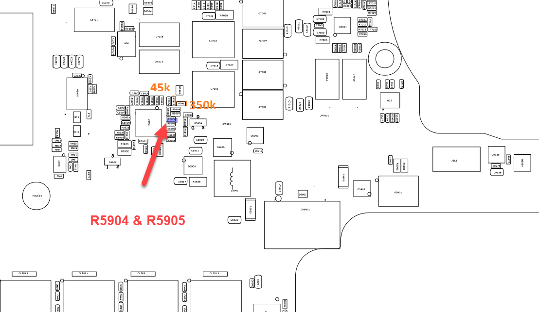

                    #29
                    update
                    regarding point 4 and 5 with the R5904/5
                    4.9v R5904 4kohm
                    2.7v R5905 4kohm
                    1)
                    Pin 1 2,3v (1,3 without adapter but with battery)
                    pin 2 0,25v after resistor 0.220 ( seems to turn off ) (3.2v with battery)
                    3)
                    350kohm r5912?
                    45 / 38 kohm r5913
                    Am I right on the location ?, ohm reading is a bit of wit +/- not stable read

                      #30
                      I am starting to think that U5901 or the front mosfet (Q5901) is defective. On a good note, the controller is in stock (very rare with current market conditions) and available from mainstream distributors:
                      https://www.digikey.com/en/products/...21AHRZ/6228193
                      Consider to source a fresh mosfet to replace Q5901:
                      https://www.aliexpress.com/item/4000...archweb201603_
                      Part # PK5C8EA (Q5901 replacement) - strong possibility that this is the issue
                      With the gate @ 4v9 and source @ 2v7 (4v9-2v7 = 2v2), Q5901 should have turned on. The typical ON voltage for Vgs = 1v7.
                      There may be a cross from ONSEMI or equivalent for this part but have not checked for valid replacements...yet.
                      For U5901...
                      Bad part is that the device is a 28 pin DFN which can be tricky to replace. Will need a hot air tool + flux (Amtech NC-559 is good). Suggestion is to source this part and have a (good) cell phone tech replace this for you. Or if you feel comfortable, try it yourself but kapton tape should be placed around the area of this controller so the small parts do not fly off.

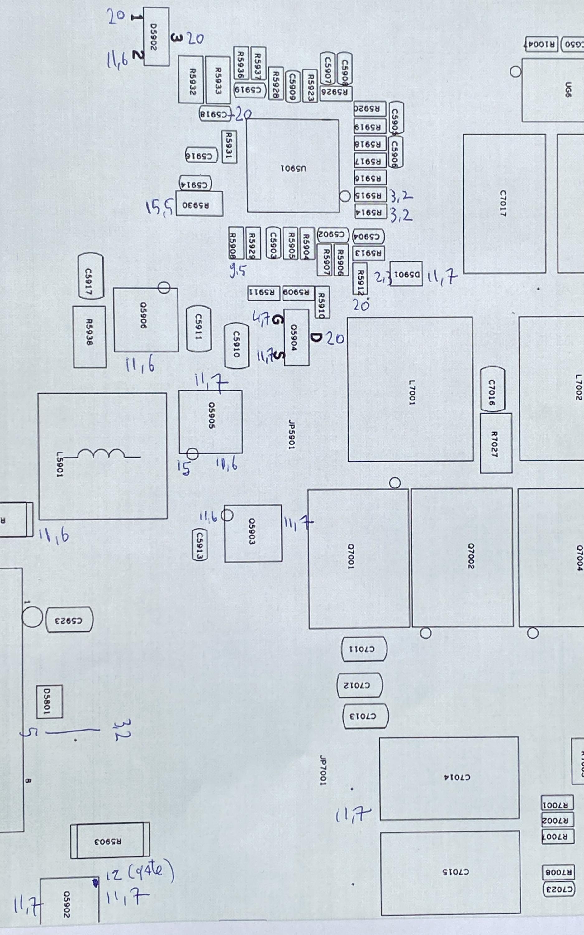

                            • Nederland
                            #33
                            ok with schema it is more easy to find the parts, I have done some more measurements. Hope its is readable.
                            With battery and ac adapter connected btw.
