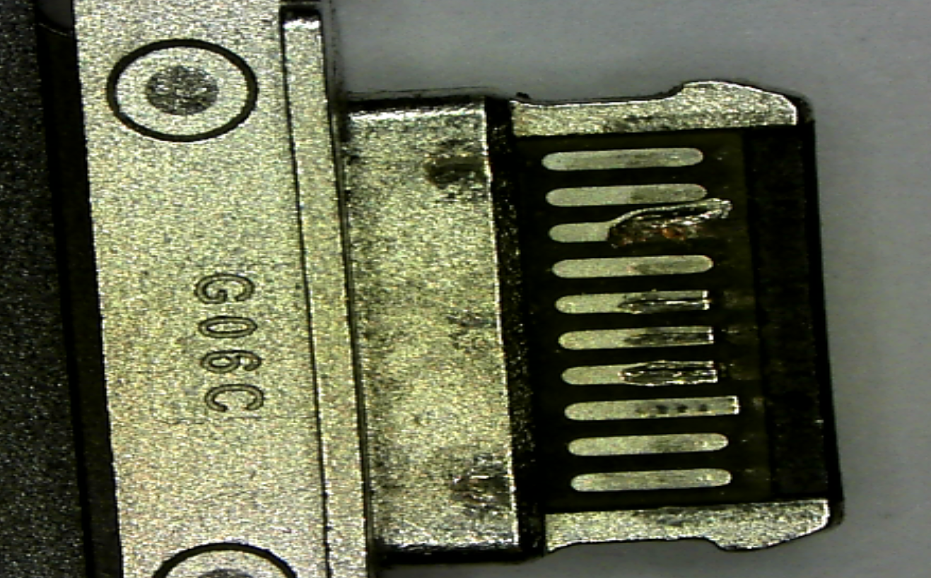

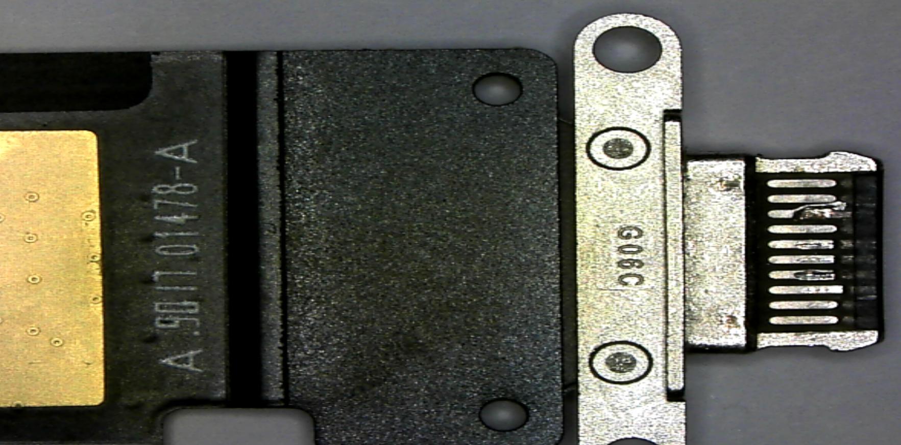

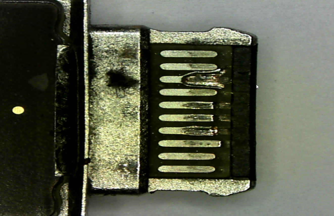

    Hi. Thought to share a recent repair on the iPAD PRO A1876 that was flaky / not charging.
    Issue was a defective dockflex charge cable.
    See attached pix on the original connector condition.
    Sourced a fresh cable from here:
    https://www.esourceparts.ca/replacem...ad-pro-11.html
    After the replacement - the display was dark and we almost were in a panic. The charge current was around 40mA @ 5V which is too low for this unit. Confirmed with multiple docks of the power adapter we have in the lab.
    Then attempted to use iTUNES which reported to find the iPAD Pro but stated we were stuck in DFU mode. As the screen was removed, we proceeded to restore the IPAD to factory defaults (ok'd by the end customer). All went well after this step.
    The current draw > 1A @ 15V and we heard the charge chime a few seconds after the next power up - even without an attached display.
    All good !!
