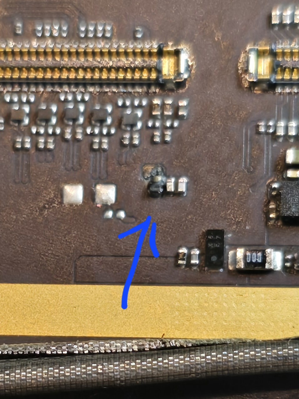

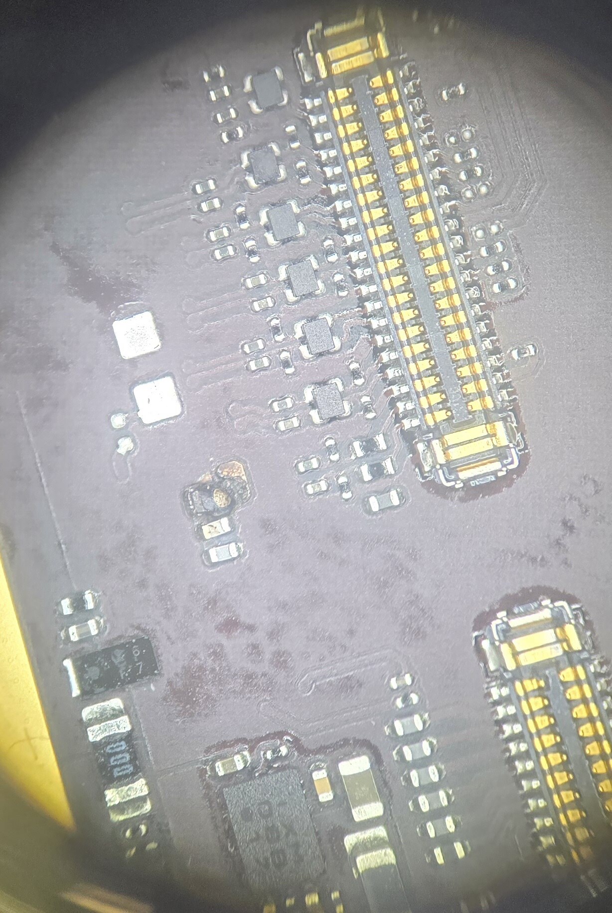

    Hello, an SMD burned out on the logic board of my Apple IPad Pro Gen 3 A1876. A pin on the display connector was bent. I think it happened there. Can someone give me the data of the defective part or is there a board view and schematic for the logic board of the Ipad A1876? Thanks and greetings

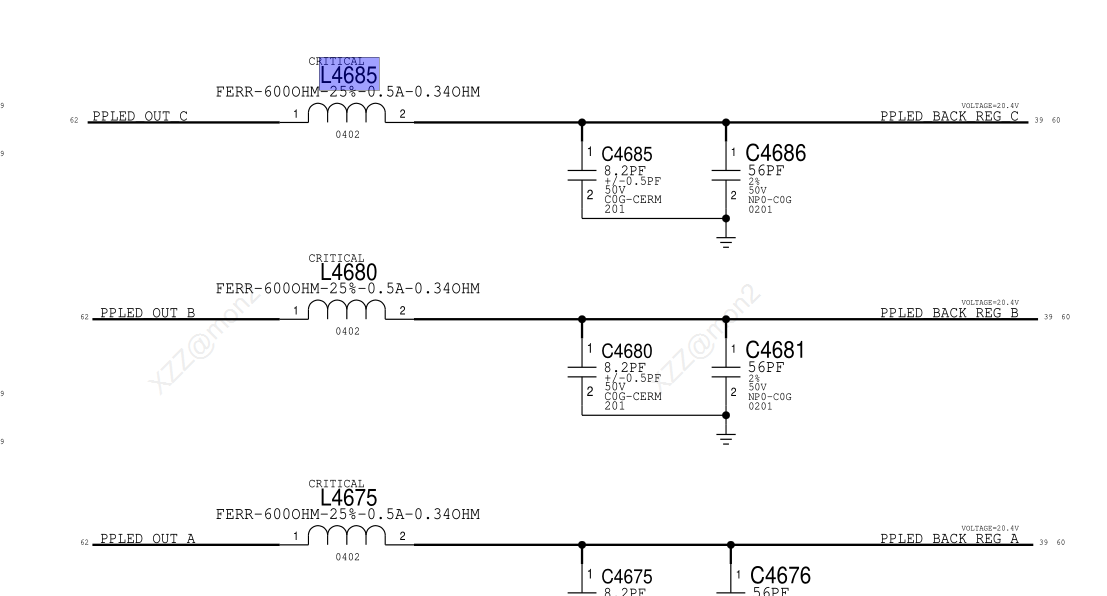

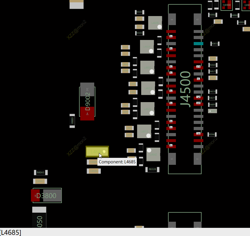

    See attached.
    This part is an 0402 smd size, 600 ohm ferrite bead rated @ 0.5A.
    https://www.digikey.com/en/products/...01SN1D/2256876
    https://www.digikey.com/en/products/...01SN1D/4421102
    * better part since it can support 900mA
    If in a pinch, the part can be bypassed since this part is acting like an EMI filter to reduce noise / block frequencies. This part is acting like an electronic resistor that is passive at some frequencies but becomes a 600 ohm resistor at noise levels. Wait on other comments but you should be able to replace with many other parts as well.
