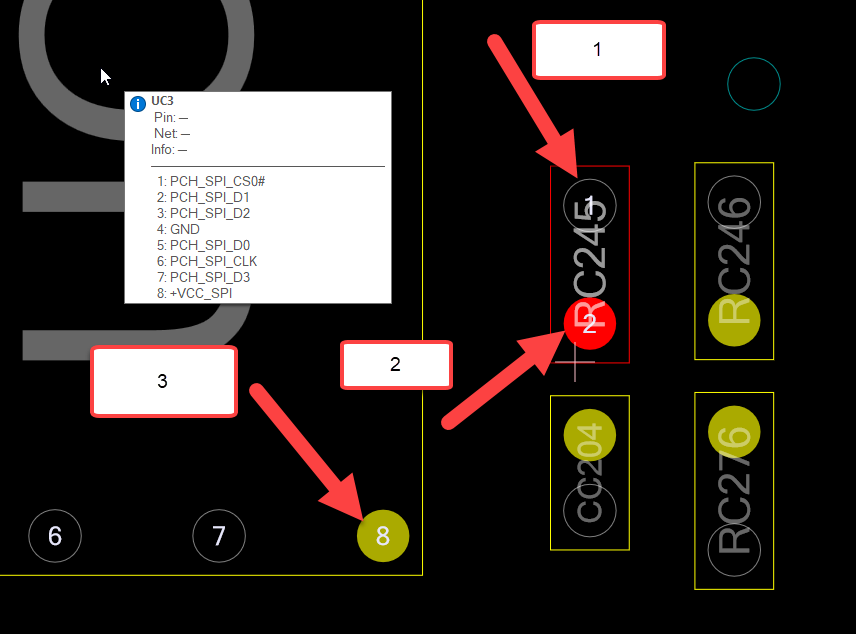

                Lenovo 310-15abr no power
                Dear all
                i have the lenovo m/b CG516 NM_A741 Rev 1.0.
                i have the 19v , 3.3v and 5v rails
                on pin 8 of Bios i have nothing and also at pj704 i am suppost to have 1.8valw and i have .328v.
                i tried to find boardview but i couldn't.
                can someone help!!!!

                    hi.
                    1) is the bios you are referencing @ UC3 ? Pin 8 is Vcc for this SPI flash. If the voltage is not +3v3 on pin 8, check RC245 - is that - 0 ohm, 0402 resistor present and ok ? Check the voltage on pin 1 of RC245 as well.
                    2) Aside from the above, in general, power down and place your meter in resistance mode. With the power off, remove the battery. Then check the resistance to ground on each coil. If there is a very low resistance to ground, the rail could be defective due to a bad cap; excessive current draw which may have damaged a local mosfet; dry solder joints on the coil / mosfets.
                    Any liquid damage ? That must be also repaired.

                      Re: Lenovo 310-15abr no power
                      Thanks MOn2 for the reply.
                      first i tried to download turbo view to have access the boardview because the components on board are NOT labeled but the software is asking to access contacts and other private thinks on tablet which i don't want to do that. do you have brd file!
                      i already tested all coils and none of them is showing short.
                      in order to follow ic UC3 (BIOS) pin8 path i need boardview.
                      Around uc3 there is only one cap and then the rest of the components are on the other side and is connected to the cap again.
                      on the some side of uc3 near pin 8 there is a connection but no part.
                      if i jump this connection i think i will get the 3.3v.
                      i will do this on Monday because today is our EASTER.
                      Yes you are right customer had water inside
                      thanks
                            Hi.
                            1) We are across Detroit, Michigan in Windsor, Ontario so for you it should be around 9:18 PM now (2:18 PM for us).
                            2) For this SPI flash device (8 pin device), pin # 8 receives its voltage through RC245. RC245 is supposed to be a 0 ohm resistor / jumper. It is important to check the voltage on pin # 1 of RC245 to confirm it is +3v3. Then check pin # 2 of RC245 to be sure it is the same. Since you have no voltage on pin # 8 of the SPI flash device UC3, there is some break in the circuit OR the voltage rail of +3v3 is not present. Either way, these are show stoppers.
                            3) Please see attached pix which we hope will help you. Need to confirm if the +3v3 is even present on your logic board so start with pin #1 of RC245.
                            Please post your voltage readings for 1, 2, 3 locations.

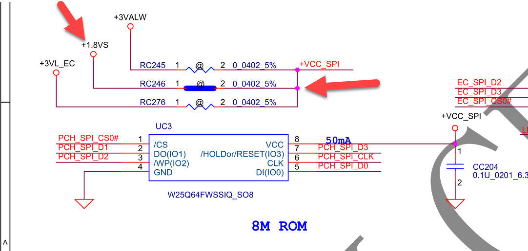

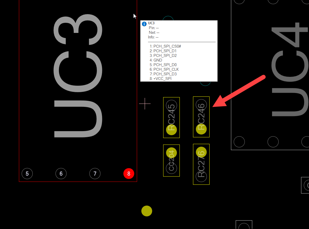

                                      • mon2
                                        • Dec 2019
                                        • 14667
                                        Re: Lenovo cg516 nm-a741 no power
                                        hi. my apologies, the referenced ROM @ UC3 is powered from +1v8 (not +3v3). See attached partial schematic.
                                        Please confirm the presence of RC246 and also that the voltage rail is +1v8. If not +1v8, then there is an issue with that voltage rail.
