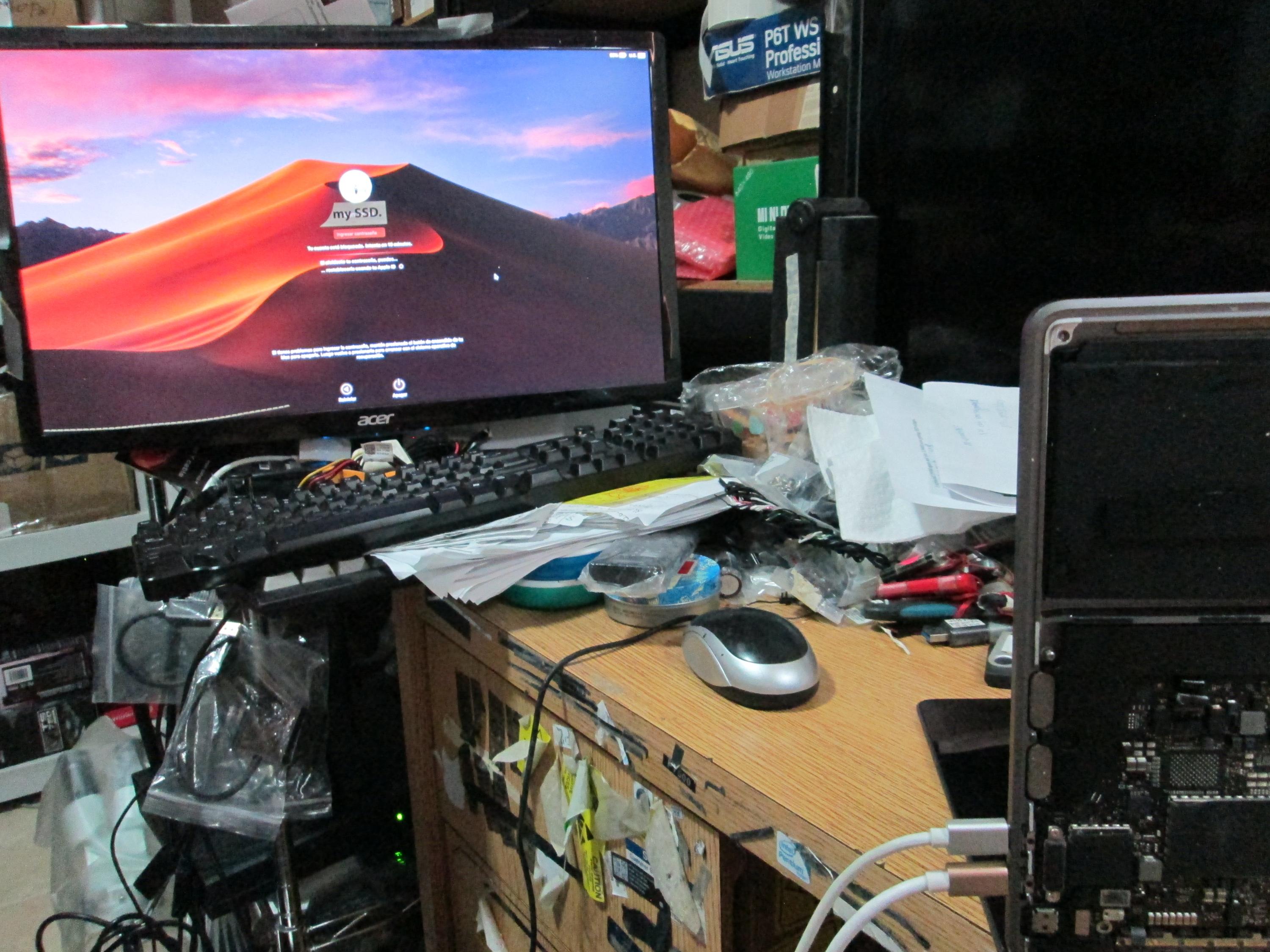

    Macbook ProA2159 with board 820-01598 with black screen. was water damage. Measured lcd connector J8500 and find pin #1 (EDP_AUXCH_N) short to ground 2 ohm. Looks like it goes to U0500(CPU) directly . Is it anything to do? Starts fine and all, just no image

    Someone say that's CPU EDP partial Damaged. can it be fixed without replace the CPU(U0500)??? need solution please.

      What’s it measure with display unplugged ?

        Dead CPU. Backlight rail arced to eDP AUX line and killed it.

          Diode mode 0.001 and 0.064v or 64mV on that pin#1. are there any way to rescue ? I am not able to replace the cpu or take it off to check if it is cpu dead or PCB board short.
          and is that "EDP_AUXCH_N" a power supply point or it's some data signal to activate the screen? can we use "EDP_AUXCH_P"--Pin #3(0.9V and 0.129 diode mode-- measured) to emulate it ?----sure need to cut cpu to pin #1 the trace first.
          for all your experts do you think to do this will damage more the cpu or screen I don't know how risky it will be at least use external monitor still can use this laptop and or the screen is not cheap.(if damaged)
          I am new for this hope got some advice thanks for all you guys.

              Re: A2159(820-01598) no image
              See post #4.
              Does this unit work with an external monitor? If possible, test with an external monitor. I know that we have done this with some external dongles to validate the position of the logic board.
              Also, we recently purchase a POST code reader for macbook and iMacs that apparently will confirm the boot cycle of the cpu. Bought from Asia but not yet used.
              That tool would help here. I think you stated earlier the logic board chimes? That is quite positive. Perhaps review your lvds connector and cable with all power off so no voltages cross onto other pins.
              Either way, you will need to know if your CPU is damaged beyond use or not.
              We are studying in how to replace large bga devices like such cpu but this will require a high quality bga rework station.

                Everything will work except the internal display since the eDP output of the CPU is dead.

                  For Mon2 yes it works on External Monitor.
                  Still I want to know if the "EDP_AUXCH_N" is power line or it's data signal line? can it be use "EDP_AUXCH_P" emulate add to eDP LCD? or it is feedback signal from LCD to CPU and let CPU know the LCD status then CPU will activated video functions or others etc...
                  Other thing I confirm the water damaged eDP LCD screen is good After cleaned LVDS EDP Display FPC Connector the connector was burned pin#43 and pin#1 became black color. and after cleaned I use A1706(820-00923-a) mainboard(that only working board I have) to test the eDP LCD with cleaned original flat flex video cable the video image came out perfectly.
                  Now How can I rescue this no inner video image mainboard.
                  Hope experts help me out thanks.
