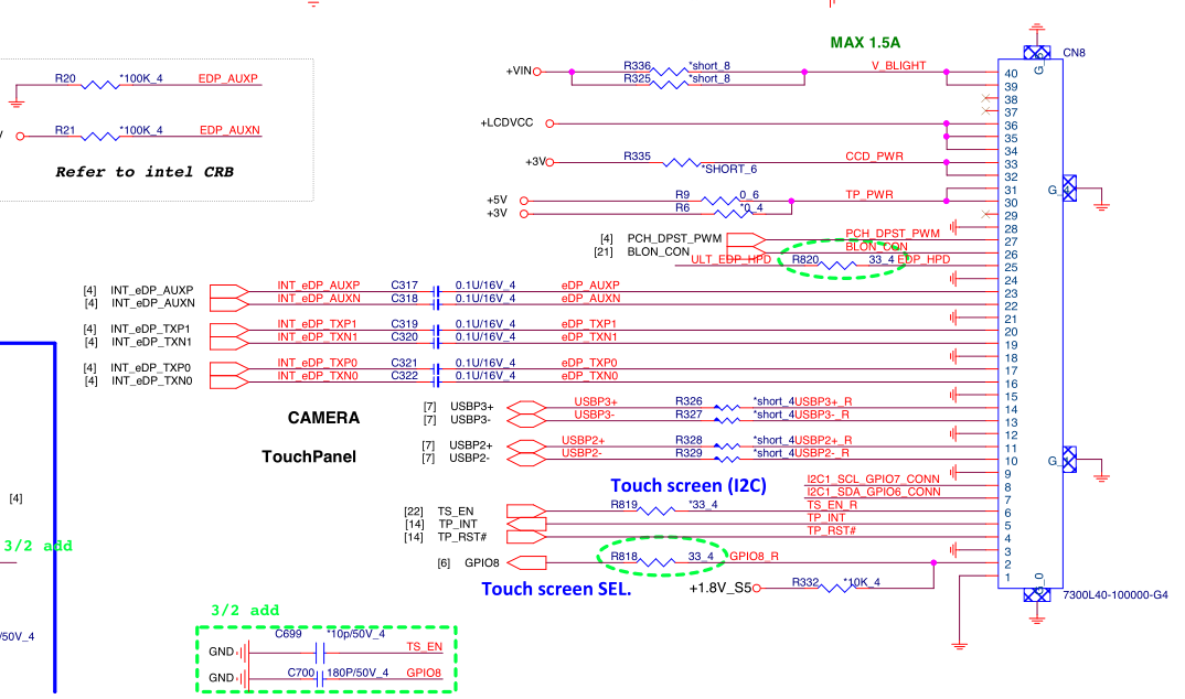

    Hi good day i have a quit a bad issue of this board , I alrady change the scren but I can only ssee a dim light od display showing acer logo. Ive tsted the pins showing
    CN8
    Pin 40 19v
    Pin 36-34 has 3.3v
    Pin 32-33 has 3.3v
    Pin 30 has 0v
    Im very new with this issue and I dont want to add more damge to the board hope somoen can guide me..

        According to CN8 schematic, pin 30 should not be zero volts. Please see attached.
        Can you trace back this pin 30 and confirm if there is a stuffed resistor @ R6 or R9?
        Only one resistor should be present on the logic board.
        Respectively, when this resistor is found, check the OTHER side of the resistor to confirm if there is a voltage rail present @ +3V (R6) or +5V (R9).

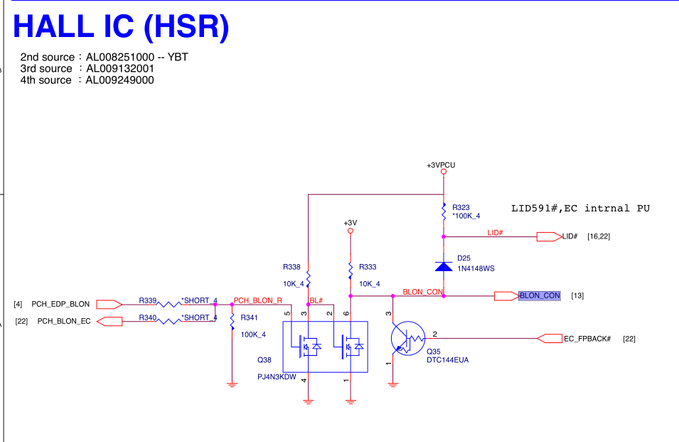

        Also, investigate the hall effect IC (lid sensor?) as per the attached schematic. Is this working correctly?
        What is the voltage on BLON_CON?
        Perhaps the host CPU believes the LID is closed so it is dimming the display accordingly to save on power.

          The =3v and 5v is preent into the end of the two resistor
          The r9 and r6 are no stuff
          check the BLON_CON 3.3V

            What about the LID switch as suggested by @mon2??
            • kalilinux25
              • Mar 2018
              • 2089
              • ZAMBOANGA SIBUGAY
              Re: LCD backlight Issu Z8A REV D
              when I tried to check the pins of q38 im not getting any voltage on all pins
