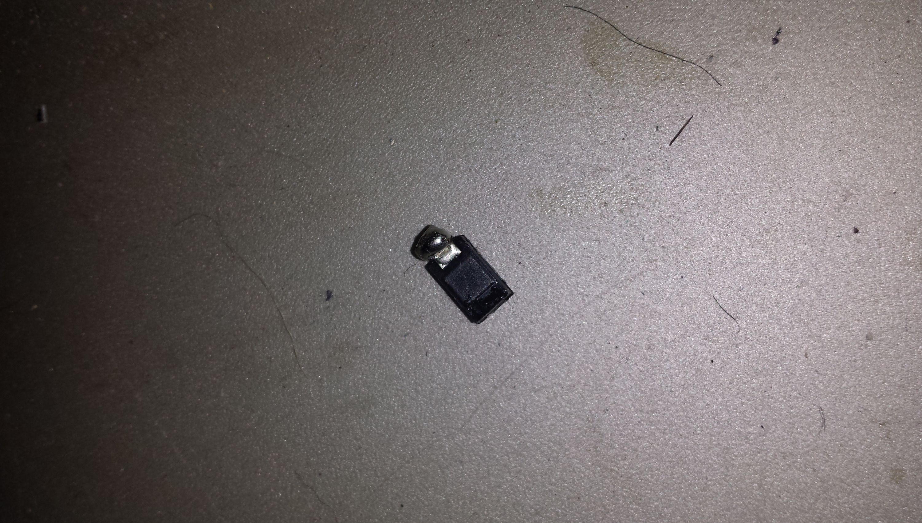

                        • lezsimply
                          The Wanderer
                          • Jan 2013
                          • 655
                          • Philippines
                          #672
                          Re: Toshiba Satellite - Locks up when plugged in
                          Does anybody had problems similar to me? I just replaced tokin cap from acer 4736z with 4 tantalum caps which I always do and now laptop shows no sign of life. I have already done this before but I guess this time something went wrong. I'm sure I have not shorted anything during the process I was quite careful all the time. I'm really confuse now
                          • rievax_60
                            • May 2012
                            • 897
                            • australia
                            #673
                            I strongly suspect that in some machines, the outer + strips are not connected in the PCB and relies on the connection through the old nec/tokin capacitor.
                            I have not been able to have anyone understand this.
                            • lezsimply
                              The Wanderer
                              • Jan 2013
                              • 655
                              • Philippines
                              #674
                              Surprisingly, laptop now has power and the blue led light lit. All I did was cleaned the whole motherboard. Maybe metallic dust interfered with some power rails which also caused regulator ic (PU4) to become hot. I haven't tested if it displays. I already cleaned my space and kept the parts as I was ready to leave. I hope tomorrow will have a positive result.
                              Come to think of it, as I was soldering the caps, my chair broke and almost drop myself on the floor. maybe some lead dropped around the board.

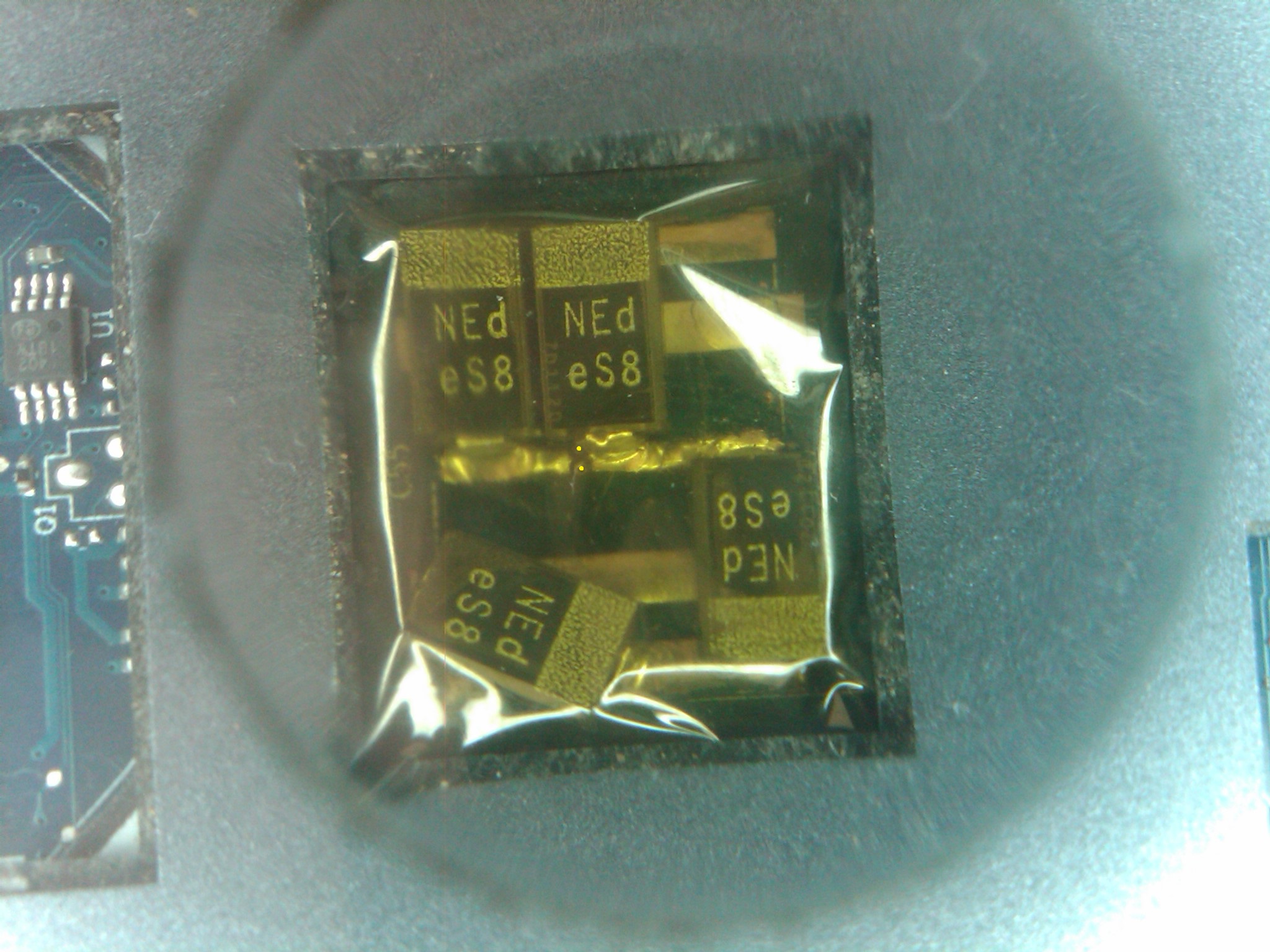

                                  #676
                                  The laptop is working perfectly now. cleaning the board might have fixed it. I think you were right I saw 2 points at the center. I scratched the center to create copper trace for the caps to fit and filled it with lead.
                                  When board got no power. I removed caps and check if something got shorted. I managed to redo the trace and removed some excess solder then suddenly two points emerged. I decided to clean the board and resolder caps and it worked. I did not put any solder at those point leaving a space at the middle. Do you think that may have fixed it?
                                  I cannot picture the caps anymore as it is with the client.
                                  • lezsimply
                                    The Wanderer
                                    • Jan 2013
                                    • 655
                                    • Philippines
                                    #677
                                    I'm uploading pics now. Its not the best but I put marks on it (dots).
