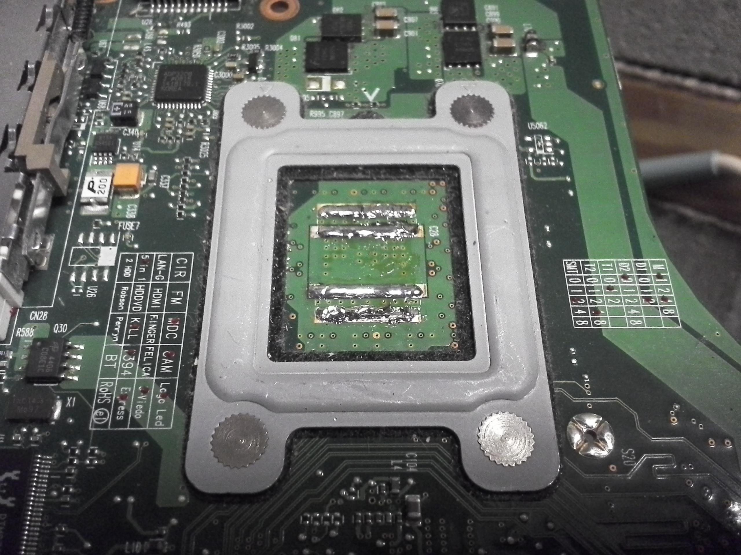

                #607
                Re: Toshiba Satellite - Locks up when plugged in
                Well I spoke too soon. Restart started again so instead of adding extra caps, I decided to redo it. I also bought a multimeter and I think I've damaged the PCB.
                There is continuity between + and - and having trouble removing the solder in between, I became posessed and started scraping off too hard and ended up touching the copper. situated inbetween + and -....The dark green line seperating one + from - region is now copper!
                I'm guessing this is gameover and continuity will never be removed? Ive used 1,6m of desolder braid in between the rift I made unsuccessfully.
                Anyway to fix this? or do I need a new MB?

                  #608
                  The low resistance reading is caused by the CPU being in the socket. The dark green coatiing is lacquer. Sometimes we scrape it off purposely.

                    #609
                    I'm getting 0.7ohms between ++,-+,-- , and multimeter shows continuity between all. With the caps, I get the same result.
                    Here's the massacre...

                      #610
                      I cant see much detail. I think I see some small resistors. You must not damage them.
                      Check the resistance again between one of the outer strips and the center square pad while the CPU is removed.

                          #612
                          Ok..will do that tomorrow. I didn't scratch the tiny resistors but might have used a desolder braid to remove a little smudge around one several times (are they easily damaged by heat? I didn't scratch them)
                          Did I damage anything below the black line? I did scratch the copper pretty deep.
                          Also, is the copper I've reached underneath, from the + or - side? I'm confused...
                          Is the continuity simply caused by some leftover solder somewhere in and around the ravin I've dug? (It's hard to get rid of all the solder inside and around...)
                          I'm a total noobie and don't really picture PCBs in their 3D, layered form. 2D is new already.
                          Thanks for the reply, will remove the proc asap.
                          Sorry for the picture quality.

                            #613
                            A better photo is needed for useful detail to be seen.
                            You need to avoid bumping the resistors. They can be easily knocked of the PCB or worse, the PCB might be damaged.
                            The photo in post 225 shows the polarity of the pads under the original capacitor.

                                          #620
                                          I'm getting 0.6ohms without the cpu again. So with ot without cpu, with or without caps, I always get the same reading and a bridge between pos and neg.
