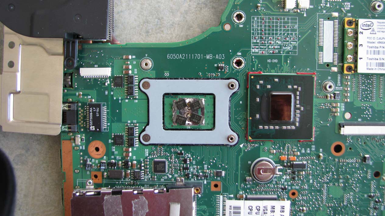

        Many thanks to everyone who contributed to this topic - the information was invaluable for repairing our Toshiba Satellite A200 PSAF6A-02H01N Notebook purchased Aug-2007.
        For ease of soldering with the 3.2mm wide tip I was using in the soldering station, I decided to mount these 4 capacitors in a different layout to what is shown in this topic (see attached images).
        For anyone interested in using this layout, & so that I could contribute something to this topic, I have included some information below (apologies to all the experienced PCB repairers for all the obvious procedure comments):
        I replaced the NEC/TOKIN 0E128 capacitor with four 330uF 2.5V Panasonic SX series EEFSX0E331XE capacitors purchased from Element14 (formally Farnell) in Australia (Element14 is pretty much world wide).
        http://au.element14.com/panasonic/ee...t=EEFSX0E331XE
        NEC/TOKIN 0E128 details: 1200uF +/-20%, 2.5V, 105ºC, 1000hrs, 0.0015 or 0.002 ohms ESR depending if the part number ends in ‘MNSTE' or ‘MTE', dimensions in mm 16.7 x 12.1 x 2.5.
        Panasonic EEFSX0E331XE details: SMD polymer aluminium electrolytic, 330uF +/-20%, 2.5V, 105ºC, 1000hrs, 3500mA ripple, 0.009 ohms ESR, dimensions in mm 7.3 x 4.3 x 2.1 (max).
        Using this layout, the only extra effort required was the removal of most of the green finish on the PCB from between the two -ve solder pads to allow soldering of the capacitor's -ve ends to the PCB. This was achieved with a curved cutting edge blade hobby knife & a sharp flat blade jeweller's screwdriver.
        Once completed, this area was tinned & any excess solder removed with a solder wick (with only 3mm between the PCB copper & the raised section of the aluminium cover/heatsink I wanted to give as much clearance to the aluminium as possible).
        The two right hand pair of capacitors (closest together) were soldered in place first.
        My finished solder connections aren't very neat but I was more interested in getting the capacitors soldered in place as quickly as possible to prevent any damage to the capacitors (the soldering station temperature was pre-adjusted by soldering onto the –ve copper pad).
        Using a digital multimeter, ~5.5 ohms was measured between the +ve & -ve solder pads with the NEC/TOKIN 0E128 capacitor removed & prior to fitting the replacement caps (CPU still fitted).
        4.0 ohms was measured between the +ve & -ve solder pads with the new caps fitted (CPU still fitted). In both instances it took a few seconds to reach the above figures.

          In addition to the NEC/TOKIN 0E128 capacitor repair in my above post, I also decided to cut open the Toshiba PA3290E-3AC3 AC/DC adaptor for this notebook (Toshiba Satellite A200) to see if I could replace any aging electrolytic caps that could be causing any possible excess ripple.
          Without major surgery, the only electrolytics I could get to were two Rubycon ZLH series, 1500uF, 25V, 105ºC, 10000hrs, 2480mA ripple, 0.017 ohms ESR, 20.0 x 12.5 OD electrolytics.
          I replaced these with two 1500uF, 25V, 105ºC, 10000hrs, 2600mA ripple, 0.018 ohms ESR, 20.0 x 12.5 OD Panasonic FR series EEUFR1E152 electrolytics purchased from Element14 in Australia.

                              What ESR are those caps? You want ideally under 10mOhm (0.010Ohm).

                                      HI, I'm a new member to this forum but I have been led here many times searching for solutions to computer problems, with both desktop and laptops. Most I have repaired successfully thanks to this site.
                                      Now I have a Toshiba satellite A300 with the random shutdown issue, I have disassembled and confirmed it has an OE907 cap under the CPU.
                                      I have tried many things including updating bios, restore to factory, format and reload Vista32 SP2, disassembled, cleaned HSF, cleaned and replaced thermal paste.
                                      Still had this random shutdown/reboot issue (when it shuts off sounds like when power button held for 4 sec)
                                      I have about an hour ago booted in safe mode and disabled one of the CPU's, restarted and machine has been on ever since without reboot (was getting about 6 or more reboots an hour). This confirms my suspicion of faulty OE907 right?
                                      Now the advice I need it on the replacement caps.
                                      The OE907 is 900uF so I am looking at 2x 470uF caps, 2.5v, 6mOhms ESR, 20% tolerance, 7.3 x 4.3 x 1.9mm found here at RS NZ http://newzealand.rs-online.com/web/...itors/7372832/
                                      So 2 of these caps would give ESR of 3mOhms am I right?
                                      Yeah so I just want someone to confirm that I would be correct to buy 2 of these and put one each side.
                                      Sorry for the long winded post.
                                      Steve
                                      • spleenharvester
                                        • Mar 2010
                                        • 913
                                        #559
                                        Re: Toshiba Satellite - Locks up when plugged in
                                        Yes, that is definitely an NEC Tokin problem.
                                        Never used 2x470uF caps myself but I can't see anything wrong with that setup - voltage is fine, capacitance is fine, and it will indeed give you 3mOhm ESR.
                                        All looks fine to me!
