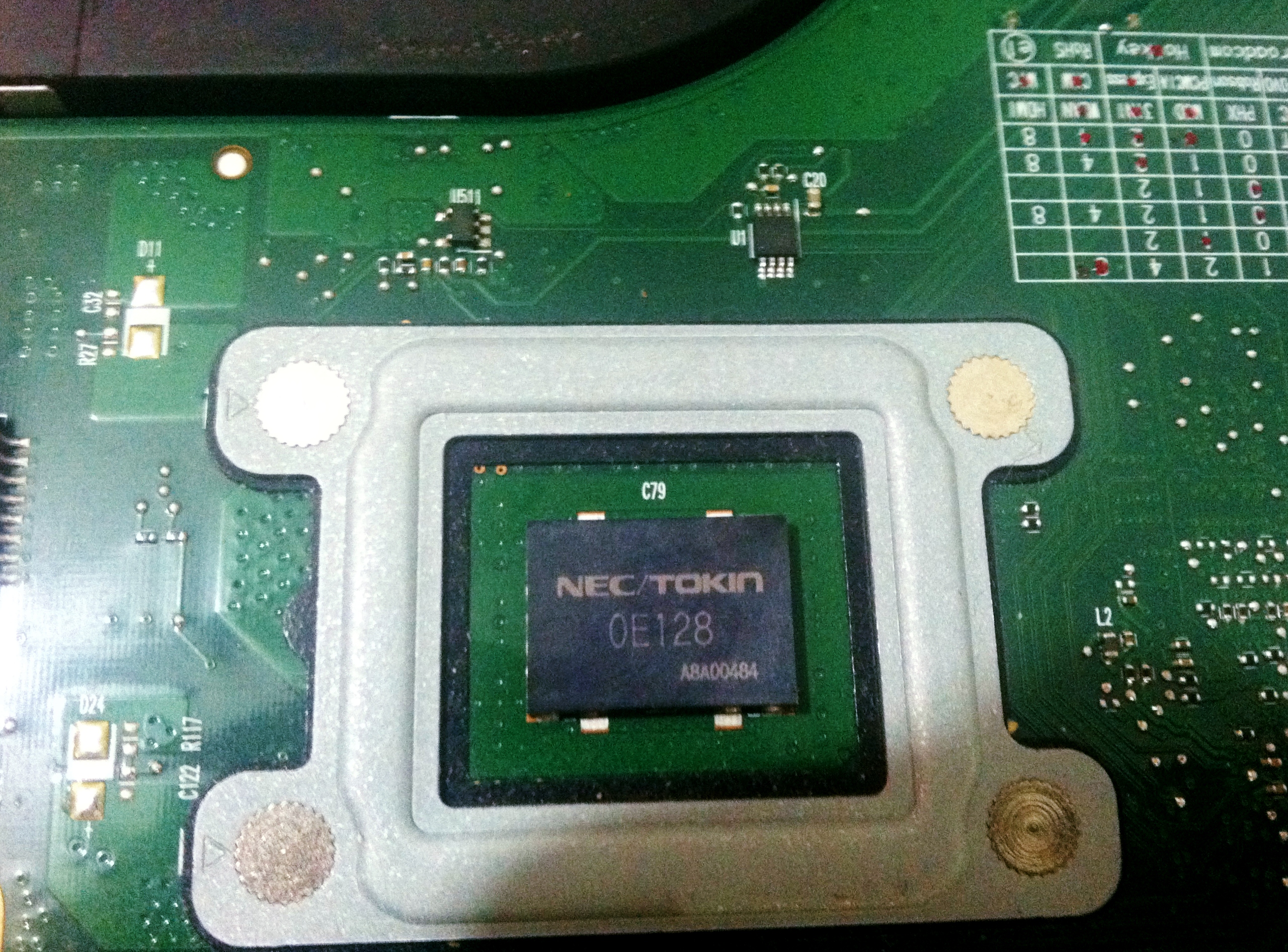

            If anyone is interested I repaired my Toshiba L305-S5875 with the help of this forum. Thank you!!
            The laptop used the NEC Tokin 0E128 and I replaced it with 4 Kemet capacitors P/N T520V337M004ATE007 from Mouser for $3.12 each. USPS priority mail is about 5 bucks and they deliver in about two days. They were 7mOhms, 4 volts at 330uF. I used the 4 volts only because they were cheaper than the 2.5 volts and it does give it a bit more voltage margin. If that even matters. $20 bucks delivered to my door and it fixed the deal!!
            Also the gap between the two conductors is rather small and it would be easy to short the cap across it when soldering. I just scraped of some of the green solder resist to exposed a wider conductor bar, tinned it and soldered on the caps almost perpendicular to the existing bars with plenty of room.
            The unit powered up and works great!!! Thanks for the help.

                      I had the opportunity to solve another one with that same problem, this time I took some pictures. Hope it helps.
                      The notebook is a Toshiba Satellite A305-S6872.
                      The first image shows the capacitor removed, board cleaned.
                      The second, new solder added to the pads.
                      And finally, the finished job.

                            The only pictures I took were as notes for assembly. If it's any help, here is a picture of the chip that was replaced.
