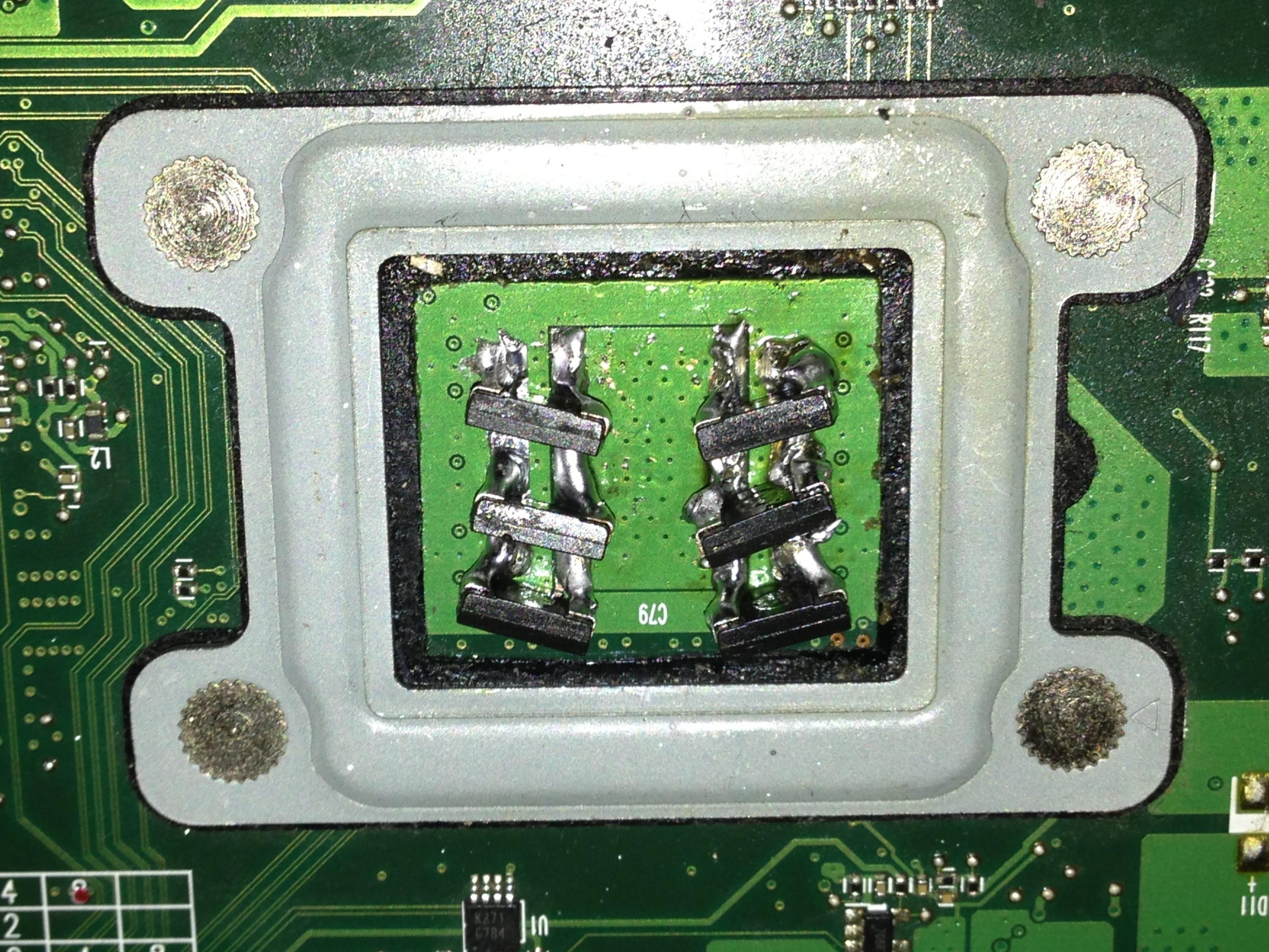

    Success.
    I ordered 4 330uf from here: http://www.mobofix.info/loja/product.php?id_product=262
    It was a little hard to solder this, but now the board posts.
    Then I tried booting to windows and worked fine from the charger only, but then started making a buzzing noise.
    Is it normal?

      Well done.
      I hear a low level buzzing from some of these laptops also. I found it to be coming from the Vcore regulator area when the Vcore voltage starts rapidly shifting between two levels for power saving.

              This solution works but instead of using 4 330 caps i used 6 220's.
              L300 working like new now. . .

                        hi, I have L350 toshiba satellite i replace NEC/TOKIN 0E128 with 4pcs 330uf 2.5v (panasonic EEFSX0E331ER) caps and it works, thank you,

                          Never seen one of those capacitors. where did you get them?
                              To me it looks like the capacitors are mounted on their sides.
                                        hehehe... i took a good look and indeed mounted on their sides...lol
