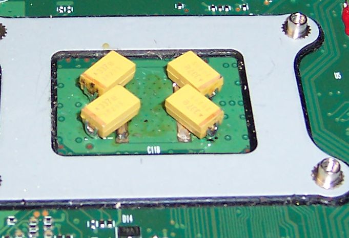

        I scored a faulty Satellite A200 via eBay.
        The proadlizer had already been replaced with 4 yellow surface mount capacitors. I measured the ESR of one of them at 80mΩ.

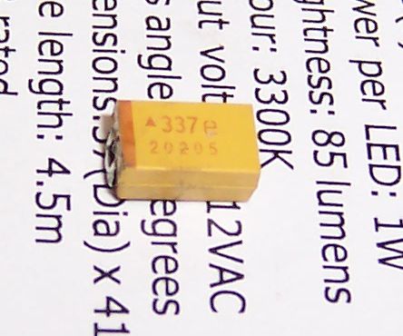

        Does anyone recognize the type of this capacitor?
        https://www.badcaps.net/forum/images/attach/jpg.gifhttps://www.badcaps.net/forum/attach...1&d=1342226613
          Re: Toshiba Satellite - Locks up when plugged in
          They look like Tantalum caps.
            Well, that's a worry because it means they have limited life also.
                  Originally posted by rievax_60 View Post
                  I have not been able to find the data sheet to see what the ESR is supposed to be.
                  That is most likely TPSY337*002#0040, which is AVX TPS Series Tantalum Cap, 330uF, 2.5V, 40mΩ:
                  http://www.datasheetarchive.com/TPSY337-datasheet.html
                  This cap seems similar to RS Stock No. 548-3337, which did not work on my A200.
                    Thanks. That makes sense.
                    I replaced them with 10x 100uf ceramic caps and its working fine.
