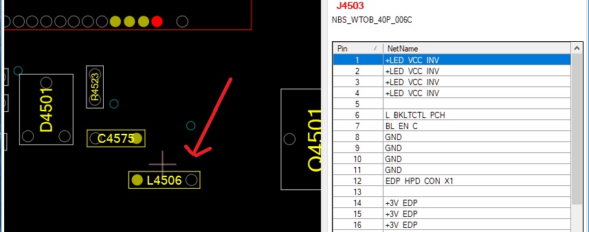

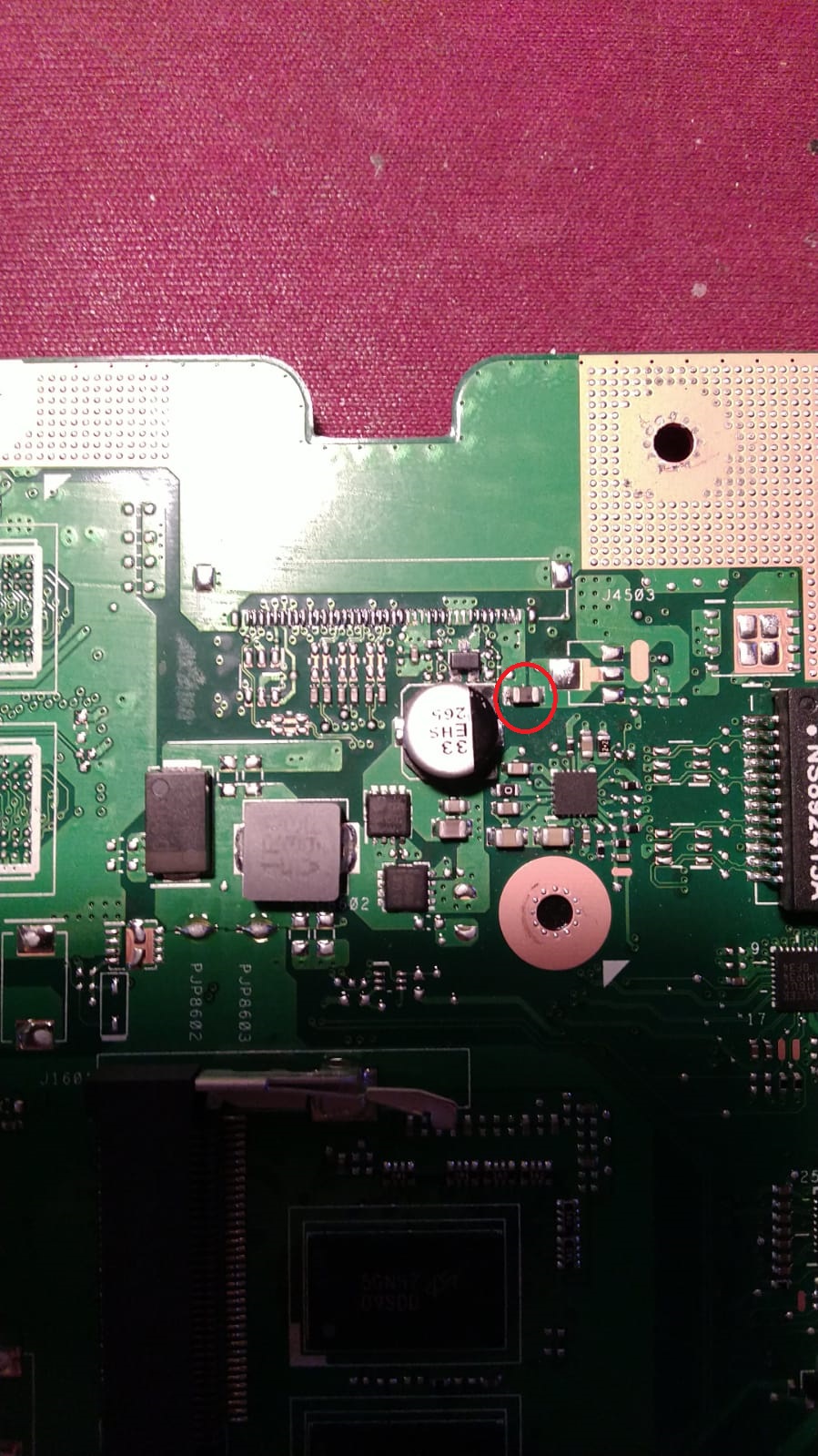

I've a really weird problem with this laptop.
It works properly with DC power but when I disconnect it, LCD backlight shutdown.
It happen already when you're in BIOS setting and laptop doesn't power off just the screen, even if its dark, is still visible and it appear if I attach again DC power.
Mainboard is X555UJ rev.2 and even if I didn't find schematic I find boardview that I attach here for reference.
This model has Intel integrated graphic card and LCD is attached on J4502.
+LED Vcc is 19V with DC power always inserted and 8V only with battery that decrease to 7,4V if I power on laptop.
I suppose that pin 34 (BL EN C) that I think it could mean "backlight Enable Circuit" doesn't get power just from battery.
On this point there is D4501 (tested OK) and R4504 that measure 1K.
I've already dumped and next updated BIOS to last release so it make me suppose it could be an hardware failure on mainboard.
This issue doesn't happen on DV-I port but there is something strange.
In Windows 10 even if I set to duplicate or extend screen when the external monitor is attached LCD is completely black, no matter if laptop DC jack is inserted.
Battery works fine and charge at 100%.
