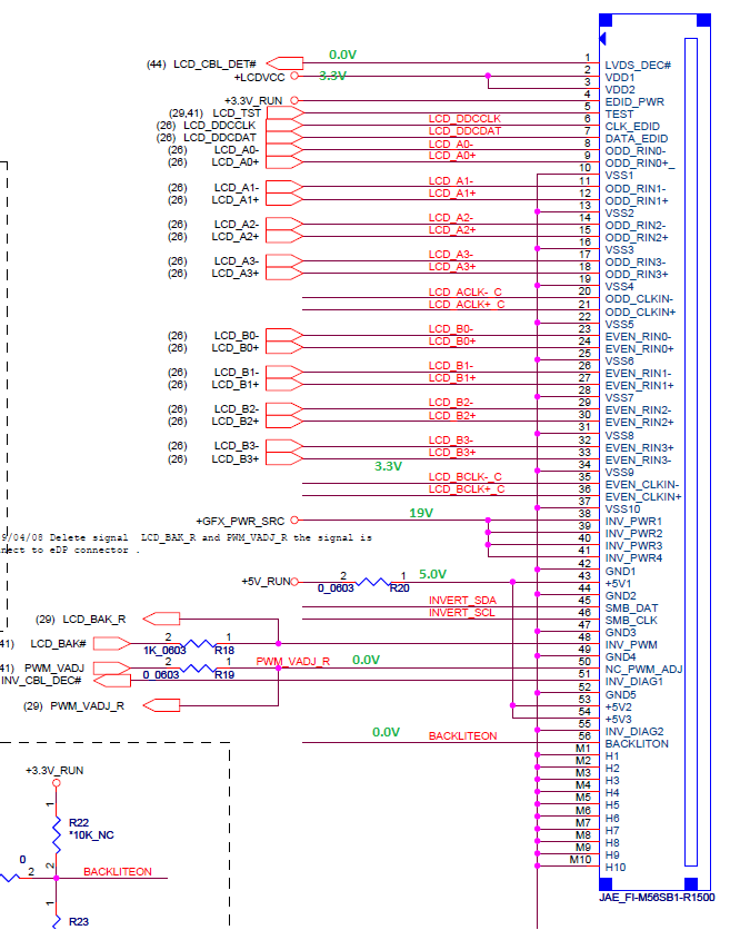

    Have this Alienware M17X R2 AB 4400 on i cannot enable BKL. Ha two displays one with CCFL and othe with LED backlight
    Attach my readings. i try to even inject missing PWM and BKL power but not work

        Test voltage on R21 , check for any activity on Q17,Q19 pins 1 and 3 on both,and attach the keyboard and try the brightness setting FN whatever

            Re: Alienware M17X R2 AB 4400 - no backlight
            this could not be on full brightness on start?
            R21 no voltage, but i try to inject and no joy
            Q17 have 0.17V on pins 3 and 1 , 3.3V on pin 2
            Q19 have 0.0V on pins 3 and 1 , 3.3V on pin 2
            i foung SMBCLK1 and SMBDAT1 shorted. 1.2ohm to GND when off and 13.5ohm to GND when started

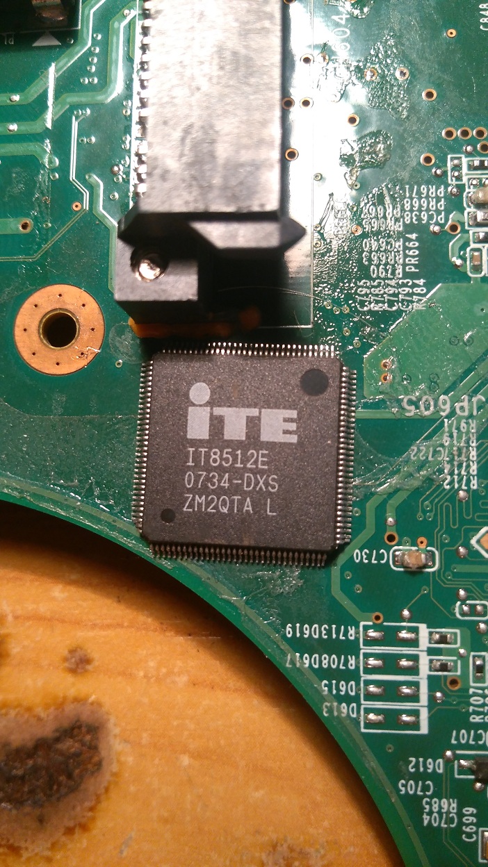

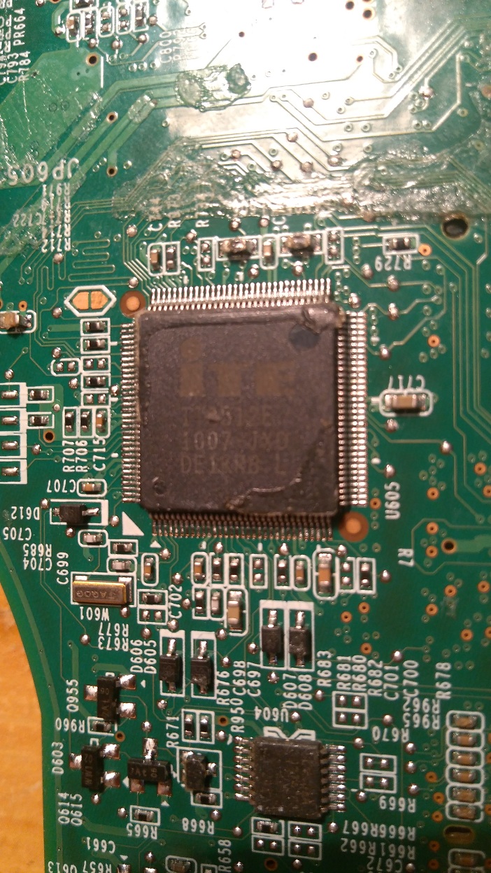

                  i think u have right. no SMB mosfets is shorted and i found little burn mark on EC

                    i found chip with same marking so i try to replace it

                      looks like it worked. Inverter WORK and even Fans work normal
                      but there is another weird problem, that start after EC change
                      MAIN_PWR_SW# go only to 2.2V when i press pwrbtn so it not start
                      Before R6 3.3V go to 0.0V when press button, but after R6 it it go only to 2.2v
                      when i short after R6 to GND laptop start.
                      R6 and R3 have measured the right restance

                        Your original chip is marked JXD ,your replacement is DXS .See if you can get one exactly the same
                          dont have that. i must order one
                          Replaced R6 - 10K with 4.7K and now MAIN_PWR_SW# does down to 0.22V and laptop start
                          for now i test it if it have any other issues because of different ic
