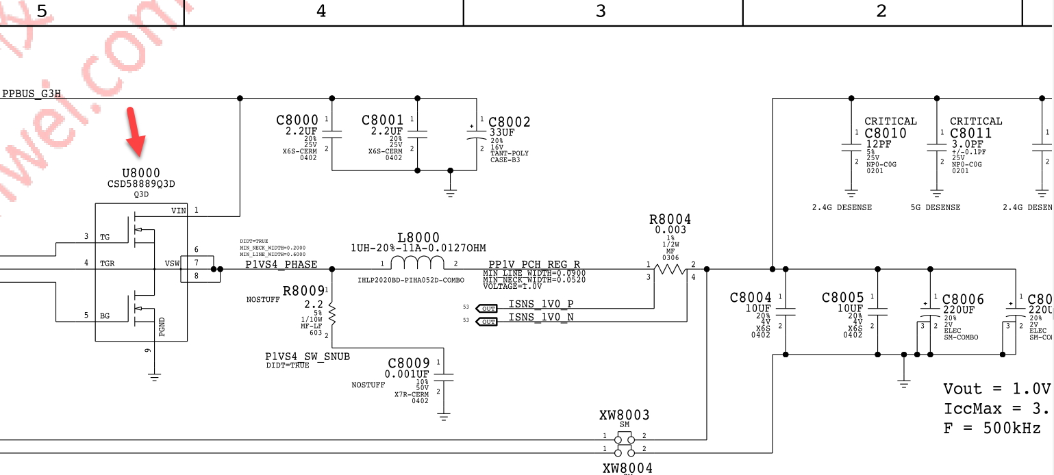

    Hi to everyone,
    i got the MacBook Pro 13-inch A1706 820-00239 from a friend (got it from eBay at good price) because it doesn't work (it doesn't turn on) and i have to fix it.
    I took out the logic board and i noticed that it is missing one chip.
    The question is:
    1) which chip is missing?
    2) if it is easy to find-buy?
    Any help would be appreciated thanks!
  • mon2
    • Dec 2019
    • 14665
    Re: Macbook Pro A1706 820-00239
    Hi. Welcome to the club
    1) You can download the boardview (component layout) and schematics (PDF format) from this forum. Just search for '820-00239'.
    Here is the direct link for the same:
    https://www.badcaps.net/forum/showth...ight=820-00239
    2) From a quick review - appears to be a MOSFET @ U8000. It is a custom component / private labelled made for Apple by Texas Instruments.
    p/n CSD58889Q3D
    You can find these on Aliexpress or contact your local macbook repair shop.
    Also on Ebay (prefer 100% new and original to be safe)
    https://www.ebay.com/itm/lot-of-new-...-/173951557497
    3) My beef - hate resellers (Ebay so far) that strip the parts off the unit and then try to pawn off the unit innocently as no idea what could be wrong with it. Got screwed by someone in California whom I will flame soon. The seller claims he took into a shop for a repair and the shop claimed it cannot be repaired so this guy sold it on Ebay - we paid top $$ for it only to find multiple parts stripped off the logic board. Then the seller claimed we are trying to scam him, the innocent seller. Bad karma coming soon - 'may his garden fail to grow this spring!!!!!'
    4) To properly diagnose this unit, you will need a USB Type C power adapter and USB Type C in-line meter (bidirectional) so you can view the voltage and current being drawn when you mate with this logic board. Other tools are bound to be required such as soldering irons / hot air tools / multimeter. This hobby is a drug but very interesting. Be patient and carry on.

            Better buy donor boards when they are available.
            Also a MOSFET doesn't go missing by itself. Someone already worked on this, if they pulled this specific part I'd assume they at least somewhat knew what they were doing, so they probably found something wrong on this rail, such as a short to ground or a short from main power rail, and if they didn't go further to repair it they probably found out that it was not repairable due to a dead PCH. No surprise when you buy this stuff from eBay.
