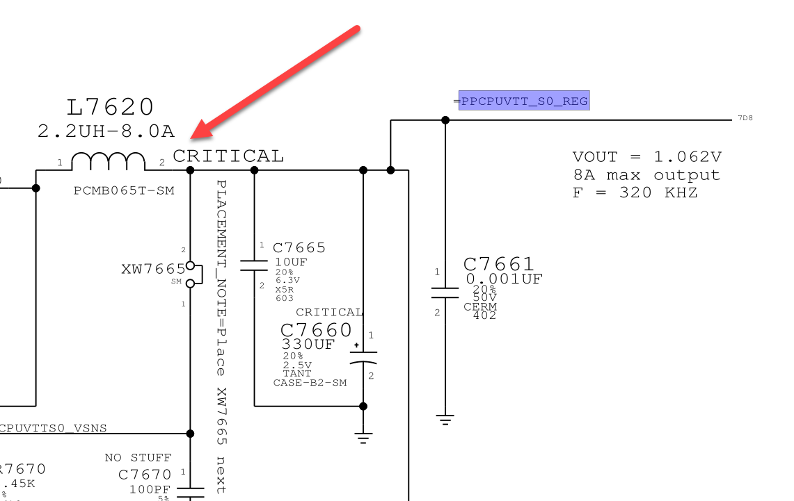

    U7600 is the voltage regulator for the CPU Vcore @ 1.062V (PPCPUVTT_S0_REG).
    What is the voltage @ L7620, pin 2 ?
    Also post the voltage into L7620 as per attached diagram.

        0 volts present at L7620

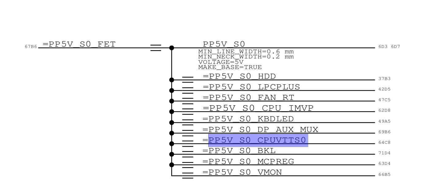

          Check and post the voltage on pin 10 of U7600 (PP5V_S0_CPUVTTS0) which should be 5v0.

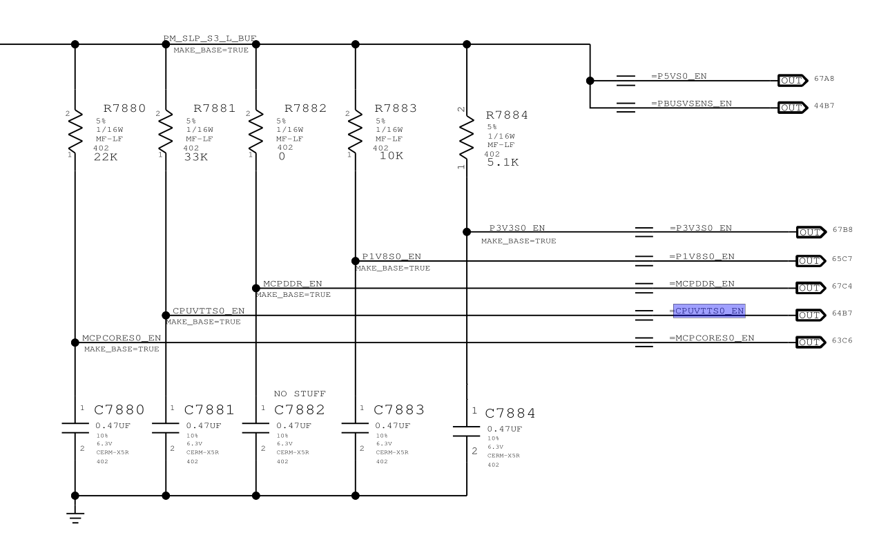

          Check and post the voltage on pin 1 of U7600 (CPUVTTS0_EN). This pin turns the switching regulator ON / OFF via this ENABLE pin. This is driven by a RC (resistor & capacitor) circuit - see attached.

              Pin 10 = 0 Volts
              Pin 1 = 0 Volts

                Also mon2, tested R7881 Resistor to see if it is blown or failed. I have 33K on the resistor so it shows good on the board. No power at cap C7881. RIP life lol

                  Wait , the cap could be fine. What is the voltage reading @ the junction in the attachment?
                  This whole cluster of resistor & caps are a poor-man's delay circuits to sequence the power rails. They really should have used voltage supervisors that once they reach a specific voltage threshold -> release the reset line and/or enable the next power rail, etc.
                  This power sequencing is done to prevent latch up conditions. In our opinion, rc circuits are not recommended but it is a cheap method that appears to be 'just ok'. We strictly use power supervisors in our designs. Never a fault.

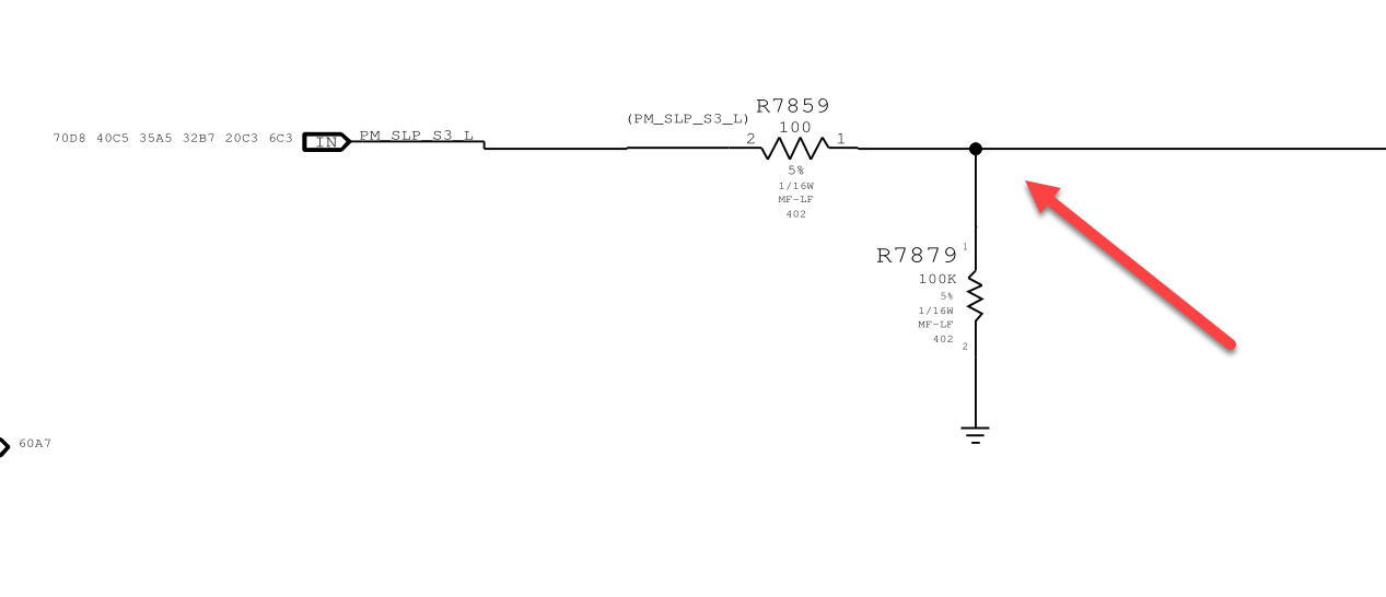

                  Need to know if you have +voltage on PM_SLP_S3_L_BUF.
                  Then if this rail is zero volts here, keep checking 'to the left, to the left'

                    No voltage at all on PM_SLP_S3_L_BUF Going to check further
