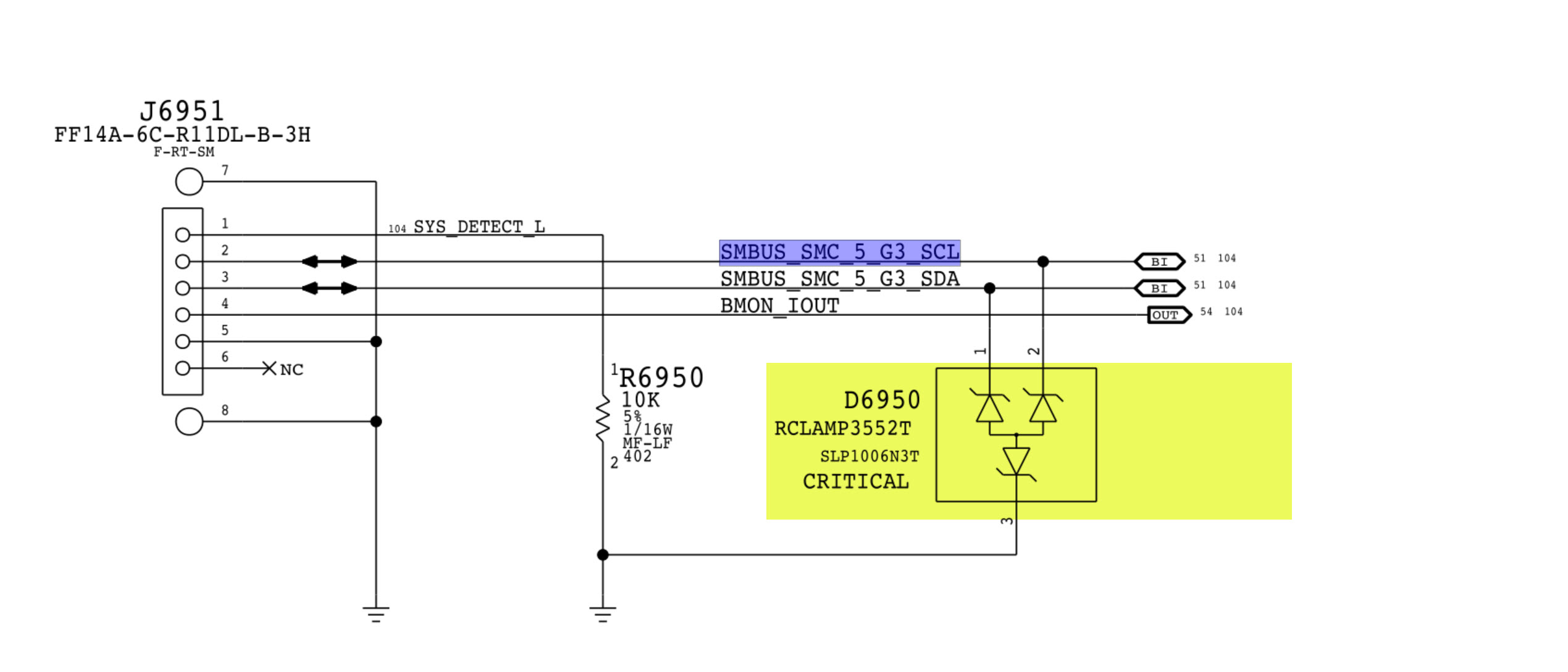

    I have a Macbook A1706 that won't turn on. It did have signs of liquid damage under U7650 so I replaced the chip. No changes.
    I then went to measure a see if PP3V3_G3H is present on R7009. It is indeed present at 3.4v.
    However, PPBUS_G3H on F7000 measures 1.1v without the battery installed.
    A USB-C amp meter initially shows 5v in but then goes up to 20v. 0 amps are present as the board is not turning on. No fan spin either.

    Remove the fuse @ F7000. Power up again and test if the PPBUS_G3H voltage returns on the ISL side of this power rail.
    What is the voltage to ground without the fuse and load applied ?
    Next, remove all power -> measure the RESISTANCE to ground of the consumer (downstream) side of this removed fuse (F7000).
    What is the resistance to ground reading ?
      Re: MacBook A1706 No Power; 20v present on board
      Still no PPBUS_G3H. Voltage on ISL side is 0.064v.
      Resistance to ground on downstream side with fuse removed => 4.7k Ohms.

                Power up with the same adapter. The selection of 20V is good and confirms that the CD3215 ACE controllers are working.
                Measure the voltage to ground (with the power adapter connected) for:
                SMBUS_SMC_5_G3_SCL
                SMBUS_SMC_5_G3_SDA
                Red meter probe to one of the above points; black meter probe to ground.
                Post each measurement.
                  Smbus_smc_5_g3_scl => 0v
                  smbus_smc_5_g3_sda => 0v
                  Seriously starting to wonder if our ISL chip (U7000) is bad.
                    That is not good.
                    Remove all power. Meter in DIODE mode.
                    Red meter probe, yes RED to ground .
                    Black meter probe to one of the same test points as above.
                    What is the measurement? Then repeat for the other test point.
                    We are checking if this open-drain interface pin is being shunted to ground.
                    Moving forward, suggest to flux + low air pressure -> remove the dual ESD device @ D6950. This is a tiny tiny bugger so proceed with patience.
                    Then power up again and check the VOLTAGE to ground of these pins again.
                      Not yet - review my last post. Repeating again that I killed 3 days to locate this nasty fault on a macbook about to be dumped in the garbage bin. D6950 was to blame.

                        So I made a pretty rookie mistake; I actually measured the wrong location.
                        Pin 2 is 0V; Diode mode shows 0 Ohms to ground.
                        Pin 3 alternates between 3.3v and 2.6 and in between the two. 0.45 voltage drop in Diode mode.
                        Woops.
                          Do confirm that R5381 is present.
                          Remove D6950 and test again.
                            With D6950 removed, voltage measurement at pins 2 and 3 are the same.

                                    So I went ahead and replaced the ISL 9239 chip, and tested again without the fuse on the board.
                                    We had PPBUS_G3H and the amp meter read that current was actually being drawn by the board.
                                    However, when I went to put the fuse back (F7000), the heat from the heatgun must have loosened the ISL chip because I noticed that it was raised slightly on the left side and the amp meter was reading 5v after putting the fuse back on. I then tried to put the ISL chip back down on the side that was raised but it moved just a little too much and the chip is just shot at this point and I don't have a stencil to reball it. Luckily those 9239 chips are not expensive.
                                    So to make a long story short, the board worked after replacing the ISL 9239 chip, but I botched the repair shortly after and I'm mad at myself.
                                    Going to get another ISL 9239 chip but this time I'll do it with the fuse already on the board.
                                      Replaced the ISL 9239 chip and we have PPBUS_G3H, power on, and successful boot!
