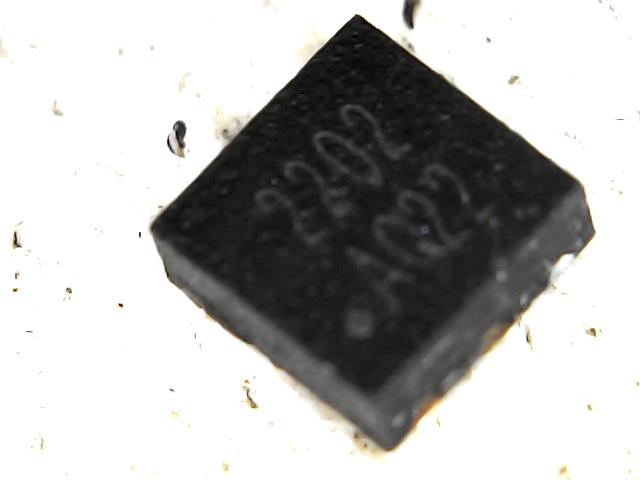

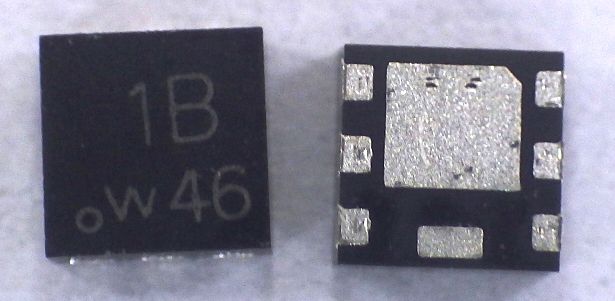

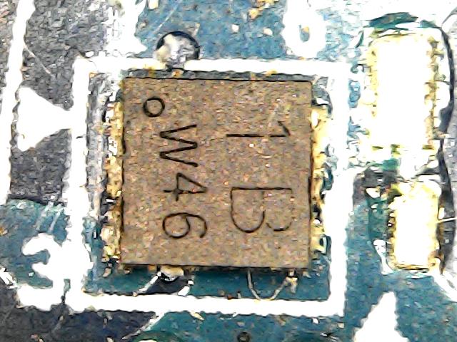

    Please help to identify this mosfet, I need to replace it but I don't what mosfet is, the mark is 1B W46.
    I have a similar with mark
    2202
    AQ22
    Both are charger battery mosfet.
    Thank you

    Laptop and Mainboard Model/Number?

      See here which appears to be similar in look:
      https://www.aliexpress.com/i/32953054095.html
      See attached.
      I think your one mosfet is p/n SM2202NSQE. Final answer.

        Yes it is, thank you mon2!!!

          I believe the original is a RF4E080BNTB sometimes marked HB, The SM2202NS looks to be the same

            Cool R_J Found it here:
            https://www.ebay.com/itm/Hot-Sell-5P...P/232976661022
            same same?
