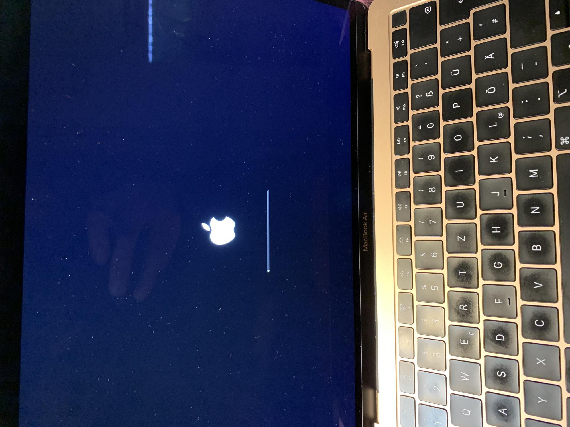

    hi there,
    got a spill damage MacBook Air 2018.
    USB C IC replaced and cleaned the board.
    everything looks fine now.
    Macbook is booting and loading rescue data, but then while boot it turns off.
    just load around 5% under the apple, fan spins high 1 second and then turns off.
    same in target mode.
    Hardwaretest runs normal and all fine.
    Voltages and Rails are all there...
    T2 Chip is recovered in DFU und up to date. SSD was detected before restore t2.
    Any ideas?

          did anyone knows what happens in the first 5% of loading... Apple Hardware test is also fine. Maybe a Problem with bridgeOS ?
          • focus2k
            • Jan 2020
            • 28
            Re: 820-01521 MacBook Air 2018 turns off while boot
            With question mark folder the Mac stays on all the time
            • focus2k
              • Jan 2020
              • 28
              That's all... what happens at this Point of Boot
