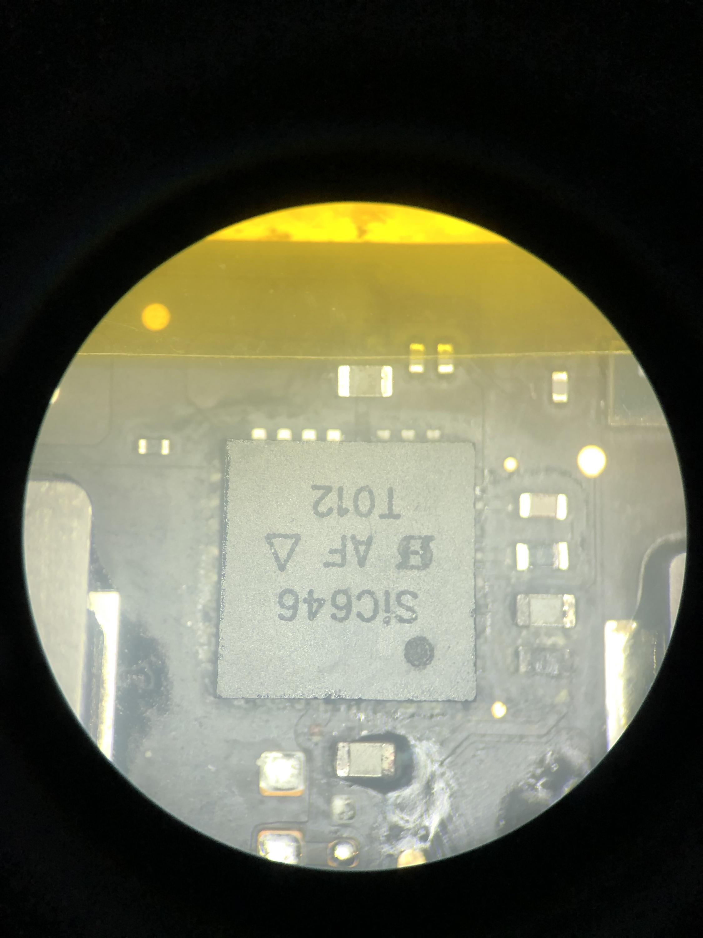

    Hello all,
    could someone assist me with the values of the burned parts (prob. caps)
    Thank you in advance!

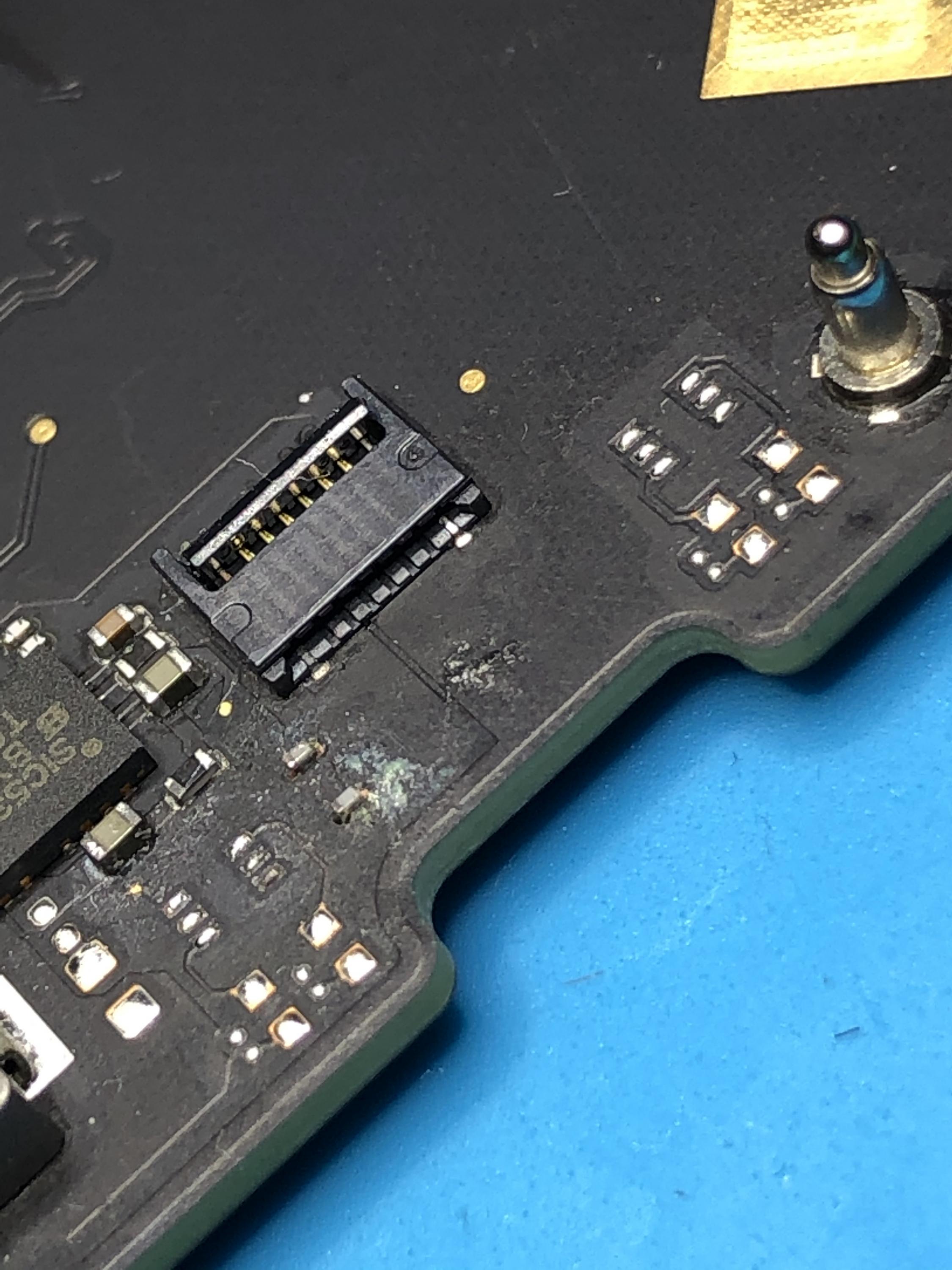

          Okay, obviously it was too late for me yersterday. =)
          So help me a little bit out, which connector ist that? Unfortunately there are no markings on the board. Otherwise tell me the full marking code of the SIC-IC or share a better pic.

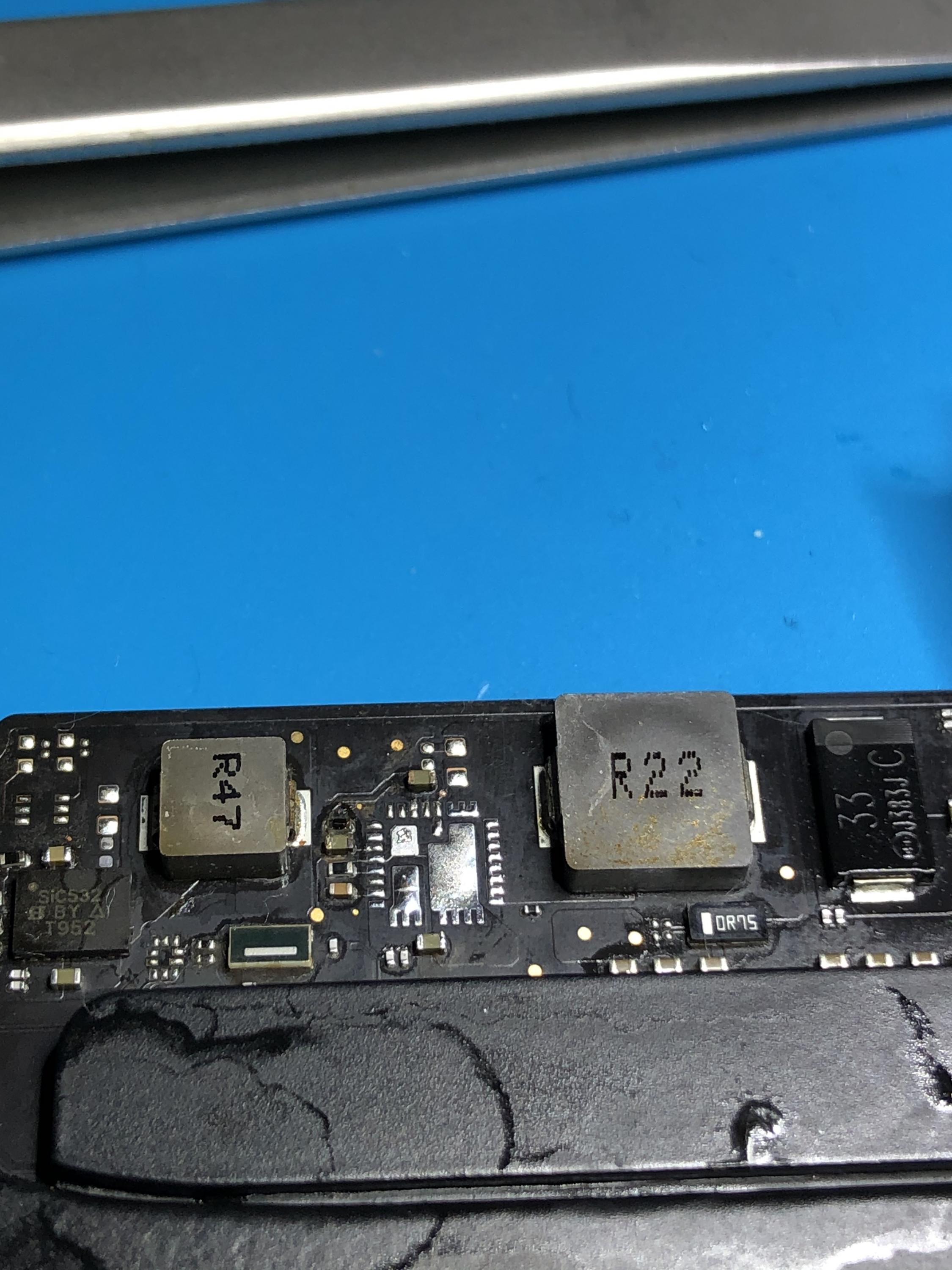

            Thank you for your answer and helping me.
            Attached i am sending you 2 pictures, one of a second (sic 646)liquid damaged area.

              Re: a2289 820-01987 values of burned parts
              I figuered out CD6s0 and CD6s2

                • Harryrepair
                  • Jul 2016
                  • 82
                  You are welcome.
                  I found a short on ppbus which i will check tomorrow.

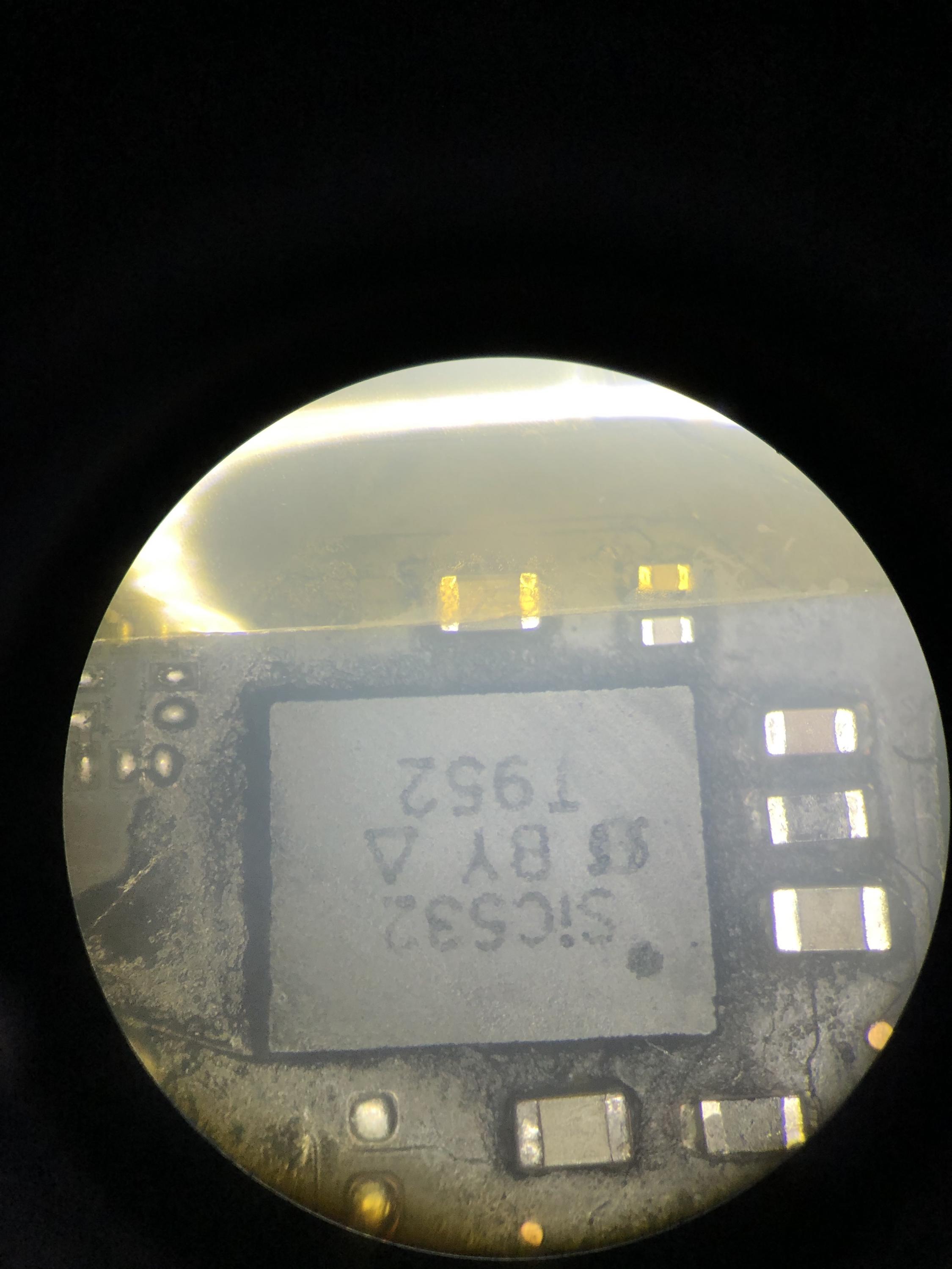

                    Hello all,
                    next step with this one.
                    I resoldered the sic532 and had still a short.
                    Next i took off the sic646 and the short was gone.
                    Reinstalling gave me a short again.
                    I gave it a try without the ic and got 20V (before 5V) on my charger and ppbus is present at 12.6V.
                    I guess the chip (sic646) is internal short or maybe one other part in this area.
                    My question to you guys:
                    Could have a short look on the picture and give me a hint wether i am right with the chip or if there is the possibility that one other part could cause the short when the ic is soldered in?
                    Thank you.
                      You are right for this chip
                      If short gone after removing
                      First check it by replacing
                      • piernov
                        • Jan 2016
                        • 4437
                        • France
                        Chip is dead but high chance of the CPU being dead as well…
                        • Harryrepair
                          • Jul 2016
                          • 82
                          because of ppbus passed through this chip directly to cpu,right?
