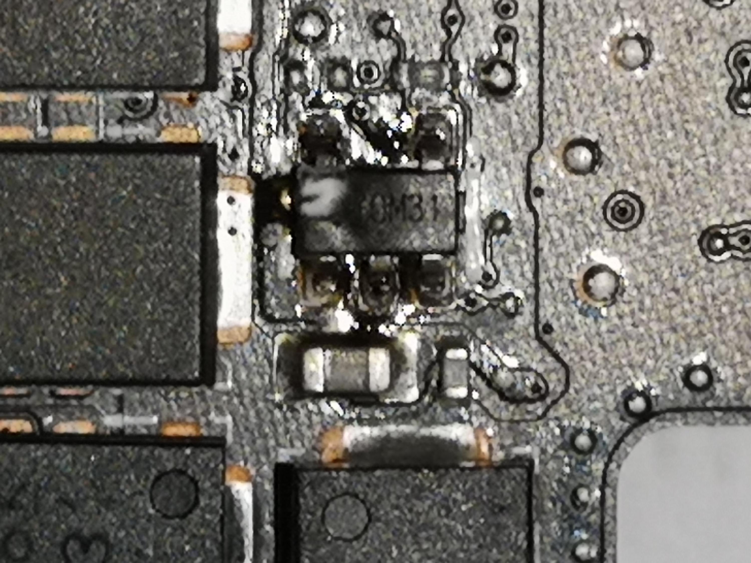

    Hello
    I have an RTX 3090 Founders Edition, can someone say me please what that Part is, i can only read M31 on the End.
    On my board it is burned i cant read the full numbers, or find Parts to buy.

    Need Help to find RTX 3090 FE Burned N-Chanal Mosfet
    Hi guys
    i find the burned part it is an N-channel MOSFET (EM5203AJ-02A)
    can some one help me to find similar component.
    here is the pdf from EM5203AJ-02A

      Re: Nvidia RTX 3090 FE Burned Parts
      I found it
        better check for short on his pins

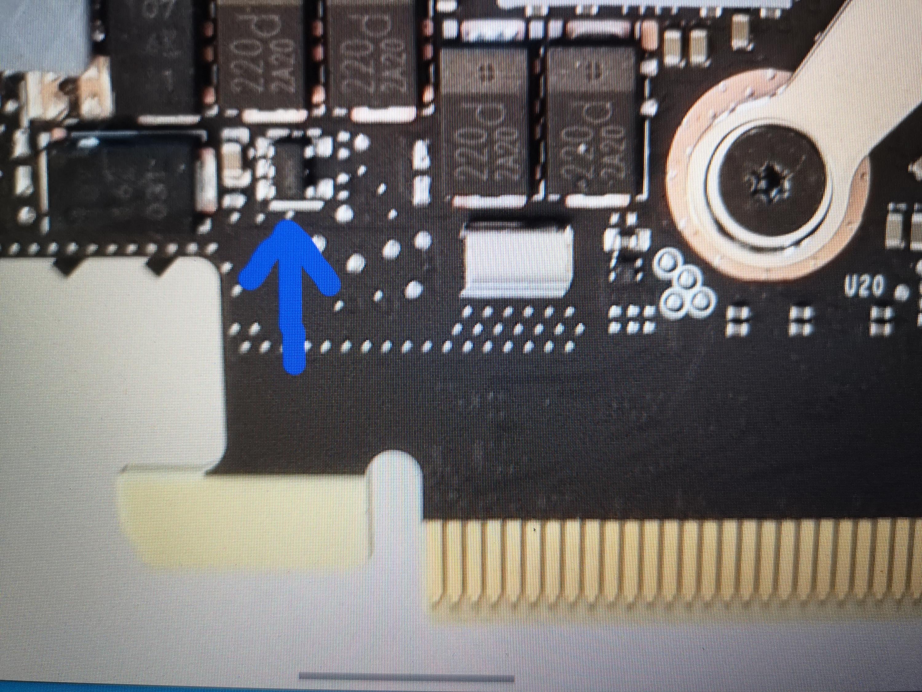

          3090 FE Part Confirm/Identification
          by H H
          I'm hoping someone could help me confirm if I have identified the following parts correctly.
          Apparently the DP cable became stuck inside the graphics card and was yanked out. This caused some sort of short which burned the DP contacts and blew some resistors and ferrite beads.
          The parts needing replacement are on the back of the board behind the HDMI input.
          I have identified the parts as the following:
          C6037: MLCC 0.1uf/16v(0402)x7R W05
          R6016: RES 499 OHM 1/16W (0402) 1%
          LB10911: Ferrite Bead (0402)...
