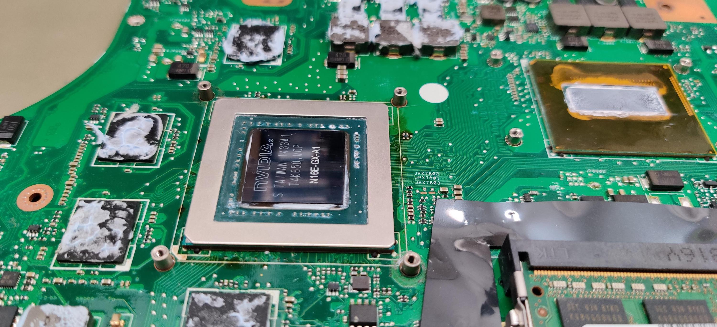

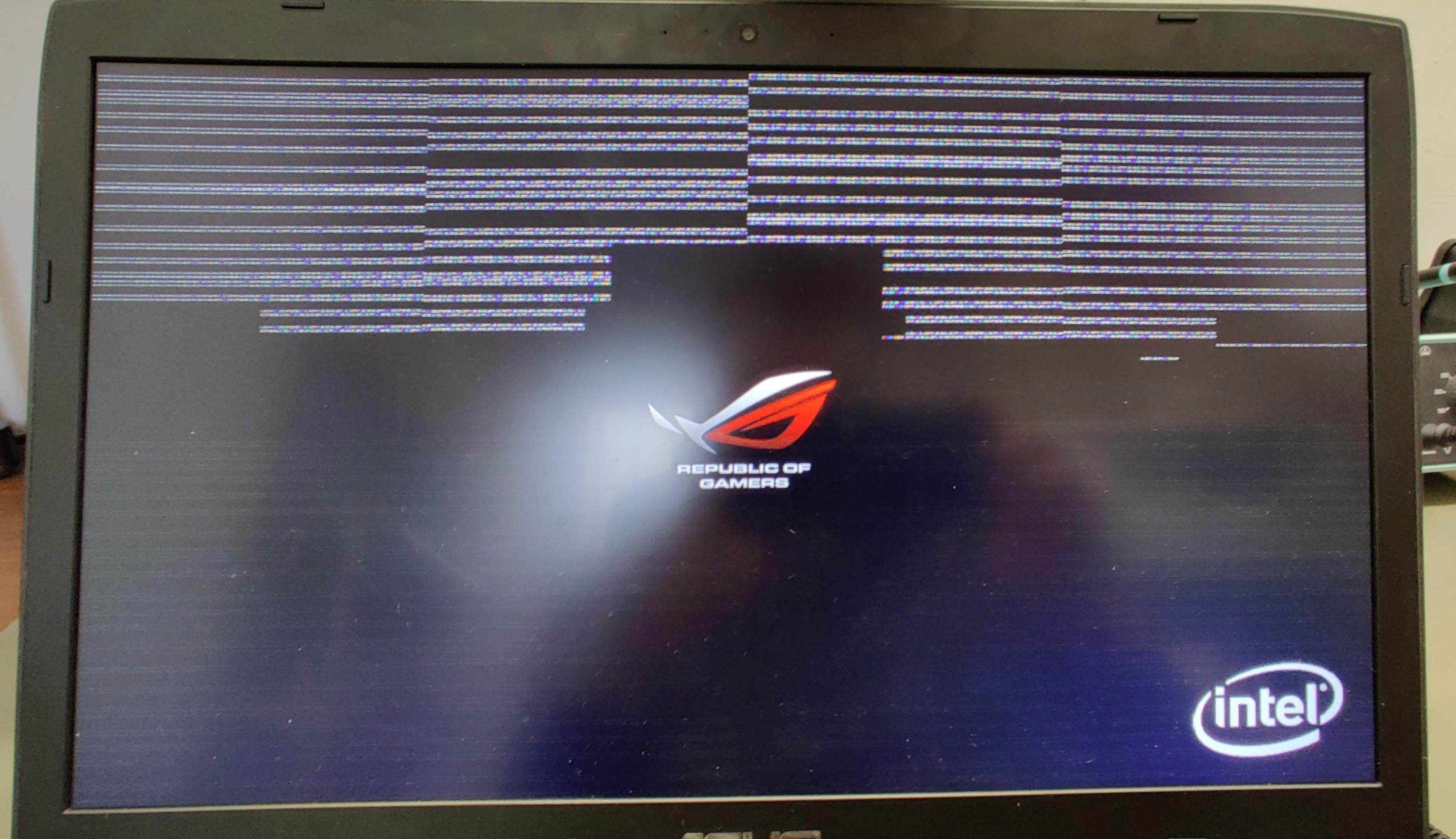

    Ma patient is Asus G751JY rev:2.0
    The error is shown in the pictures. In internal and external (HDMI & VGA) screen same error.
    Someone tried to reflow Nvidia ic.
    I think the vga causing the error...
    Has anyone seen a similar error?

    Seems that someone have tried a reflow of the bga chip, at this point you need a chip replacement. Sometime a bad vram can cause this issue.

      You're right, someone tried reflow. Thank you for confirmation!
