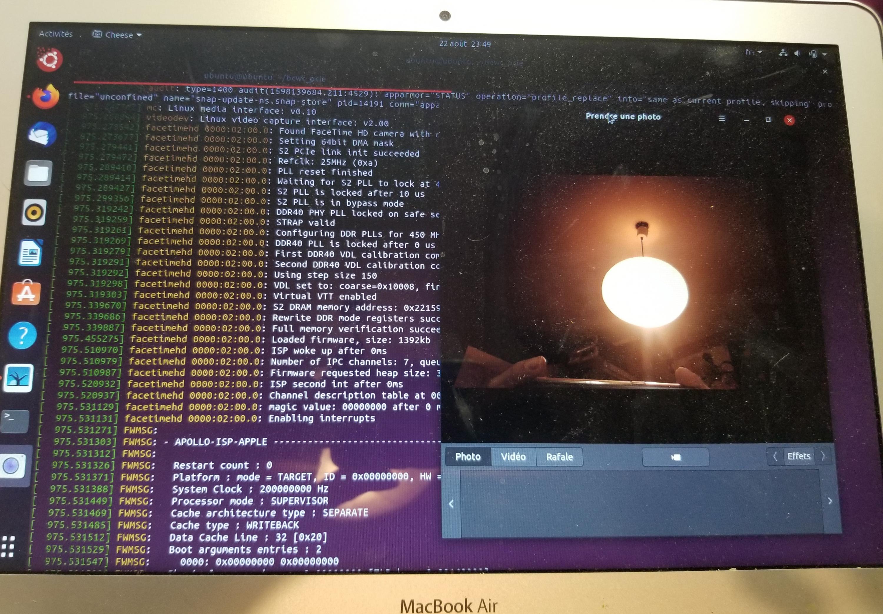

          Re: 820-00165 "No Camera detected"
          Under `lspci` a "Multimedia controller" with "Broadcom" in the name should show up (not the "Network controller" which is the WiFi card), it's the camera controller IC U3900 and it's connected to the PCH through a PCIe bus. The camera itself is connected to U3900 through a MIPI bus.
          Under Linux you have to install this driver manually: https://github.com/patjak/bcwc_pcie
          But if you don't even have the Broadcom Multimedia controller under lspci then installing this driver is pointless (it won't trigger so no message will be shown).
          Are you sure U3900 is soldered properly? Do a thorough visual inspection near it to make sure there's no missing caps/resistors.
          I still attach a picture of what the kernel log looks like when loading the facetimehd driver.

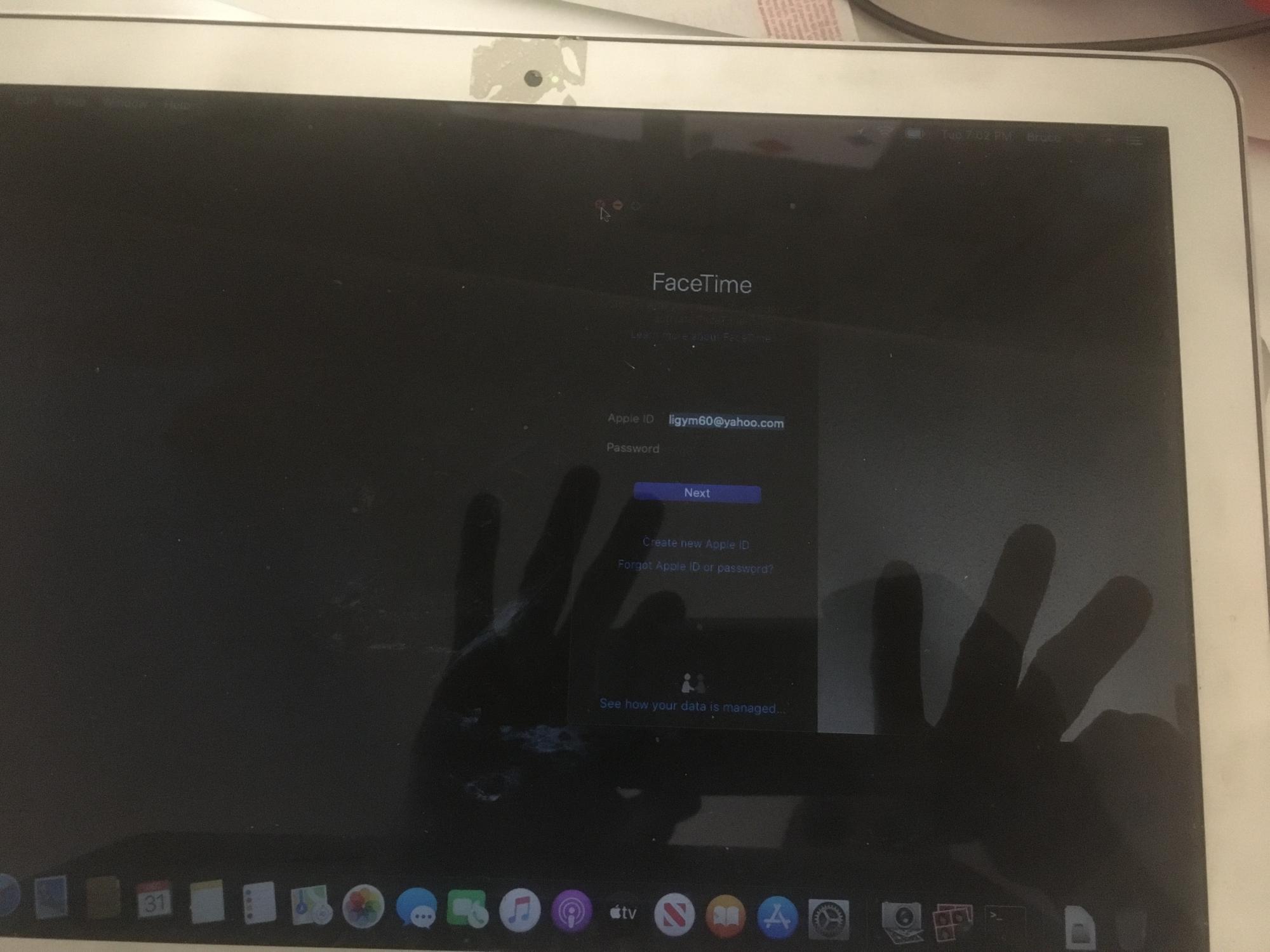

                    • ligym60
                      • Oct 2016
                      • 39
                      It's Fixed resolved clk issue. reflow and its done.
