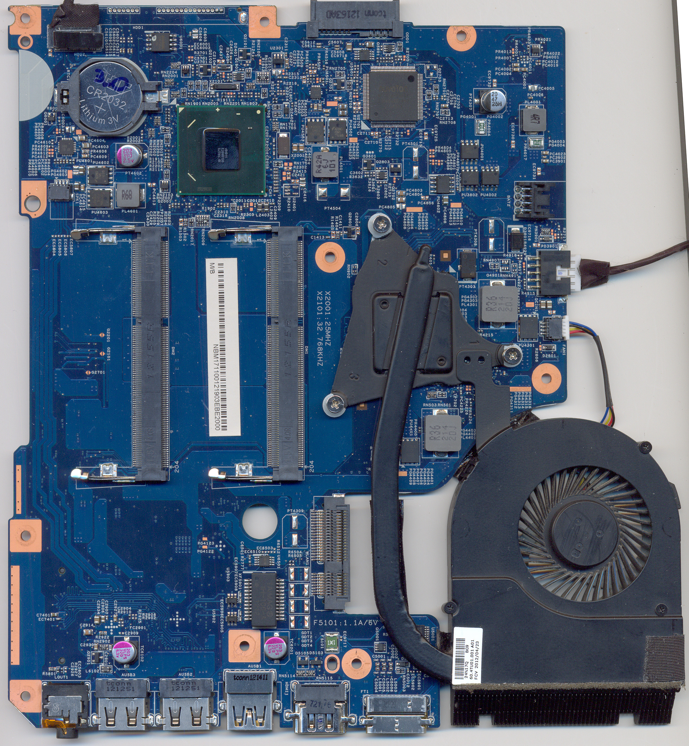

    Attached are the motherboard schematic and boardview and a datasheet for an IC. Change .doc to .GR for boardview file.
    Never had a problem with it until now. The laptop would turn on if put to sleep but when shut down it would not turn back on. I have another of the exact same laptop so I switched chargers and batteries to see if that worked. It did once after many swaps and power button presses. I am not sure the combination that worked but it did not seem to do it immediately, i.e. I just kept swapping over and over until it came on. When I put it to sleep again or shutdown, I can't remember which, it did not turn back on even with swapping things.
    I am new to laptop motherboard repair and laptop schematic reading but think I have traced it to some potentials I hope someone with more experience can give a more definitive diagnosis. As I have a working one of these motherboards I compared the things that I thought were relevant and came up with the following. Please correct me where I may be wrong. GOOD AND BAD signifies which motherboard not necessarily whether that component is actually bad or giving differing reading do to it being bad or another component inducing the differing reading.
    Measurements for pins not listed were taken but not included here as they were the same or very close. When follwing the schematic I hope the below testing shows me tracing the problem. I am uncertain which of the first three components are the sole cause of the problem or if there are multiple component failures or if it is something else.
    Super I/O
    ...GOOD U2701..........BAD U2701
    Pin 14......0V...................3.3V
    The schematic seems to indicate that pin 14 S5_ENABLE is an output and originates from here. If so then I do not know if this means there is an internal short and 3.3V is coming out or elsewhere down the line 3.3V is being fed back to it.
    Dual MOSFET
    GOOD PQ4101 .......... BAD PQ4101
    1....GND......................GND
    2....0V.......................3.3V
    3....4.73V....................0V
    4....GND......................GND
    5....0V.......................3.3V
    6....4.97V....................0V
    When the GOOD board is turned on the readings are the same as when the BAD board is off and plugged in. I do not know where the 5V on pins 3 and 6 of PQ4101 comes from if pins 1 and 6 of PU4103 are input.
    Power supply Controller
    GOOD PU4103..........BAD PU4103
    1....5V....................0.9V
    I can feel this IC getting warm and if I put some isopropyl alcohol on this IC I can see that the alcohol evaporates quicker due to the heat whereas it does not on the GOOD board. According to the pinout in the attached PDF datasheet for this component it says that pin 1 and 6 are inputs.
    GOOD AFTP12 S5_ENABLE..........BAD AFTP12
    .........0V...........................3.35V
    ............GOOD R3603.......... BAD R3603
    1...S5_ENABLE...0V.....................3.3V
    2...5V_S5_EN....0V.....................3.3V
    GOOD D3601..........BAD D3601
    1...0V...................3.3V
    2...0V...................0V
    GOOD RN2705 BAD RN2705
    1...3.3V...............0V
    2...3.3V...............0V
    3...0V.................3.3V
    GOOD R2780..........BAD R2780
    1...3.3V.................3.3V
    2...3V...................3.3V
    Both resistors measure 9.89K
    I hope that gives a good, correct and accurate overview of the not turing on issue. Again, I think the problem is with one of U2701, PQ4101, PU4103 or maybe a combination or something else entirely. If someone is able to trace my work through the schematic and offer some insight and assistance it would be appreciated.
    Thank you

                              Back to Q2703. Pls Share a high quality Photo of this Area, so i can Understand how this Rail could work without the P-Channel Mosfet.
                              Please do the Voltage Measurements on the empty Pads of Q2703 and Show them in the Picture.
                              Please Tell us the voltages of this area from the working Board too.
                              FairRepair on YouTube
                              • Mad Capper
                                • Feb 2012
                                • 113
                                Re: Acer V5-531 Does not turn on
                                Here is the information you requested. Can you explain to me how this is relevant, I do not understand. I do not know how it works without it but it does.
                                GOOD Q2703..........BAD Q2703
                                1..........3.3V.................3.3V
                                2..........0V....................0V
                                3..........3.3V.................3.3V
                                Q2703 is in the upper right hand corner of the image to the upper right of the Super I/O
                                  Hehe, this is for me a Challenge too. I'm still learning.
                                  I wanted to Check If the EC_Enable# Signal is Coming Out and driving the 3D3V_AUX_KBC (3.3V LDO) through this Not existing mosfet to make it to 3D3V_S5.
                                  The Problem i have is, your measurements are Not getting much Sense e.g. You shared 3 Measurements from PR2705 but is has 4 Pins. I believe you Mean with Pin 3 the Input (3D3V_KBC_AUX), but Maybe i'm wring. Another one is Q2703. Yes, it has 3 Pins, but they are Called S, D, and G (Source, Drain and Gate) and are Not Marked with Number on the PCB. For this reason it is Very hard to Follow. Would you clarify this for me? Otherwise the variables are to many to find the Culprit.
                                  Edit: Additionally one Thing. What is this beetween PIN 12 and PIN 13 of the EC? Are The Pins shorted? Check this Please.
                                  • Mad Capper
                                    • Feb 2012
                                    • 113
                                    There is no component PR2705, do you mean RN2705?
                                    Sorry copy/paste missed pin 4. Also I re-measured, disregard original measurements for RN2705 and use these.
                                    1...3.3V...............3.3V
                                    2...3.3V...............3.3V
                                    4...3.3V..............3.3V
                                    See boardview file for Q2703 pin assignments and reference schematic. Starting at 3 o'clock position going anti-clockwise pins are 1(D, 3DV3_AUX_KBC), 2(G, EC_ENABLE#), 3(S, 3DV3_AUX_S5 )
                                    By EC I assume you mean U2701 the Super I/O and are referring to the photo. It was just a piece of dust.
