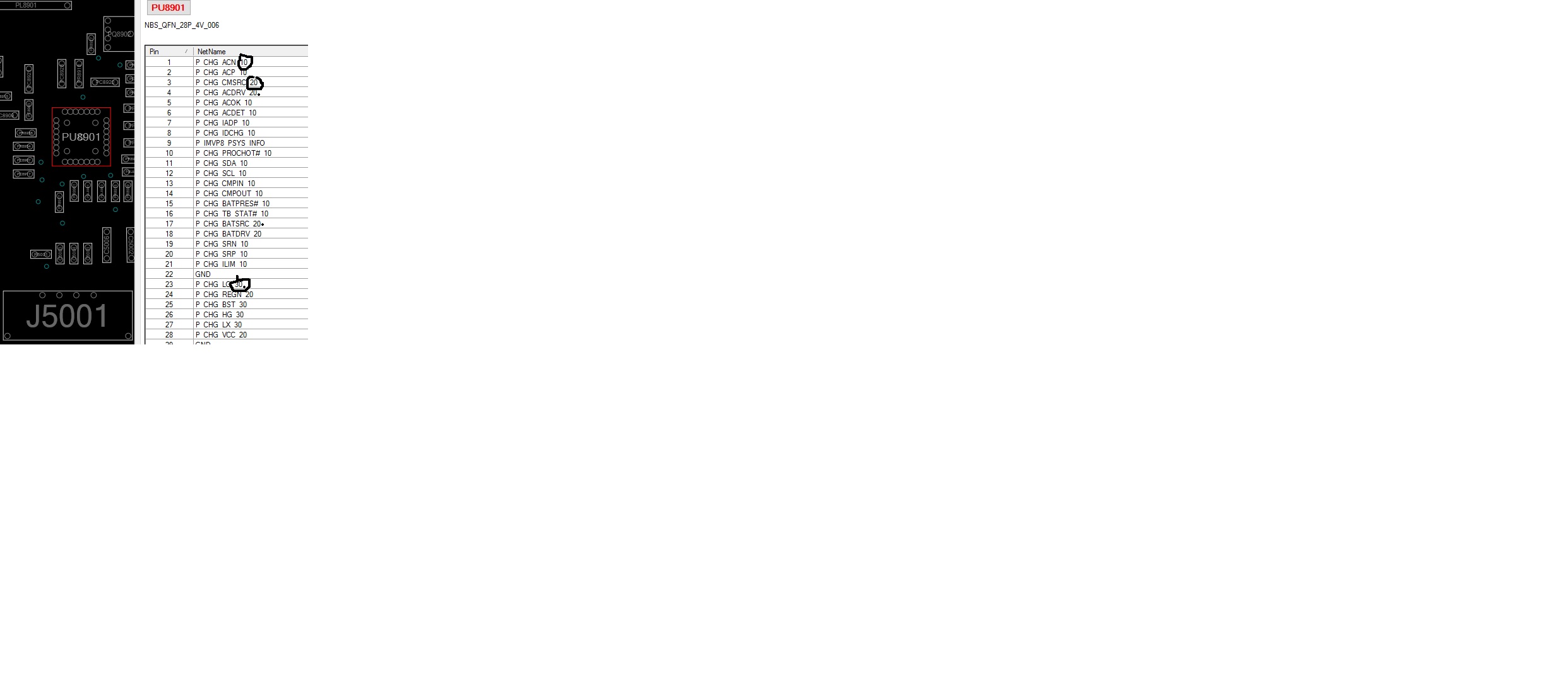

    Board info:
    ASUS X555UJ
    REV: 2.0
    this unit won't power ON when using AC Adapter only but with good battery it will power up. when i reheated the area where the PQ8906/PQ8907 located it power up but for a short period of time only. i tried already replacing BQ24780s charging IC but the status still the same... for now i put back the original BQ24780s...
    Data at BQ24780s:
    Charging IC - BQ24780S
    1 P CHG ACN 10 = 0.004VDC
    2 P CHG ACP 10 = 0.004VDC
    3 P CHG CMSRC 20 = 0.035VDC
    4 P CHG ACDRV 20 = 0.001VDC
    5 P CHG ACOK 10 = 0VDC
    6 P CHG ACDET 10 = 2.66VDC
    7 P CHG IADP 10 = 0003VDC
    8 P CHG IDCHG 10 = 0VDC
    9 P IMVP8 PSYS INFO = 0VDC
    10 P CHG PROCHOT# 10 = 0VDC
    11 P CHG SDA 10 = 0VDC
    12 P CHG SCL 10 = 0VDC
    13 P CHG CMPIN 10 = 0VDC
    14 P CHG CMPOUT 10 = 0VDC
    15 P CHG BATPRES# 10 = 0VDC
    16 P CHG TB STAT# 10 = 0VDC
    17 P CHG BATSRC 20 = 0.155VDC
    18 P CHG BATDRV 20 = 0.048VDC
    19 P CHG SRN 10 = 0.155VDC
    20 P CHG SRP 10 = 0.155VDC
    21 P CHG ILIM 10 = 0VDC
    22 GND
    23 P CHG LG 30 = 0VDC
    24 P CHD REGN 20 = 6.09VDC
    25 P CHG BST 30 = 5.99VDC
    26 P CHG HG 30 = 0.155VDC
    27 P CHG LX 30 = 0.155VDC
    28 P CHG VCC 20 = 19.42VDC
    thanks...

    ACDRV Drives the DC-IN Mosfets. The Signal isn't Coming Out and we have to find Out why. What about the DC-IN Mosfets. Did you already Tested them for internal short? Where Stops the Voltage? Check for Short to ground too.

          sorry, adapter is not an issue... tried adapters with ratings like 19v 3.42a and 19v 9.23a... and sorry i don't have schematics for this unit.. i only use boardview as my guide... so far i can't find any short circuit on this board... data that i wrote here were all what i got with my multimeter readings. right after PQ8906 is 0vdc...
          PQ8907 = 0vdc on any pins.
          for 10,20,30 things.. please see attached... i just wrote what i saw on boardview...
          thanks...

                  changing DC JACK doesn't solve the problem. but reheating/reflowing all components (mosfets, resistors, capacitors and others) after DC JACK had solved the problem... it been running for 12hrs. and tried already reinstalling OS three times... but one more problem on this unit, NVIDIA 940mx chipset had error code 43. tried already installing NVIDIA drivers via driverpack and from NVIDIA support site.
