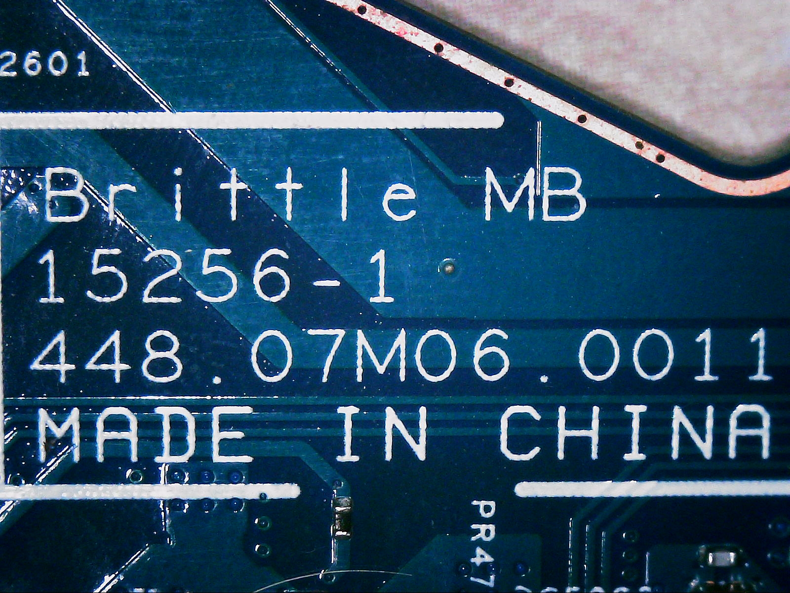

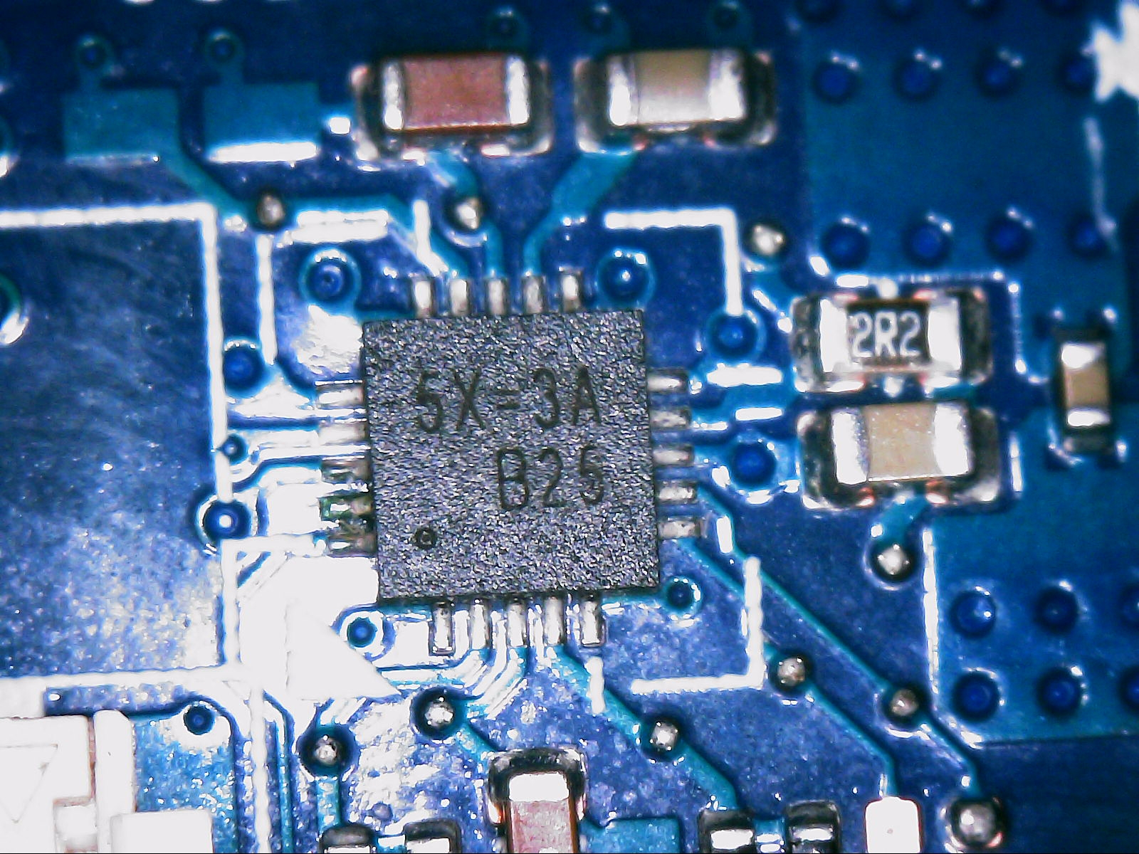

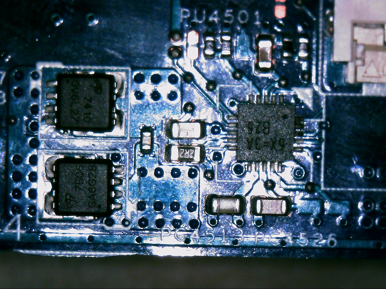

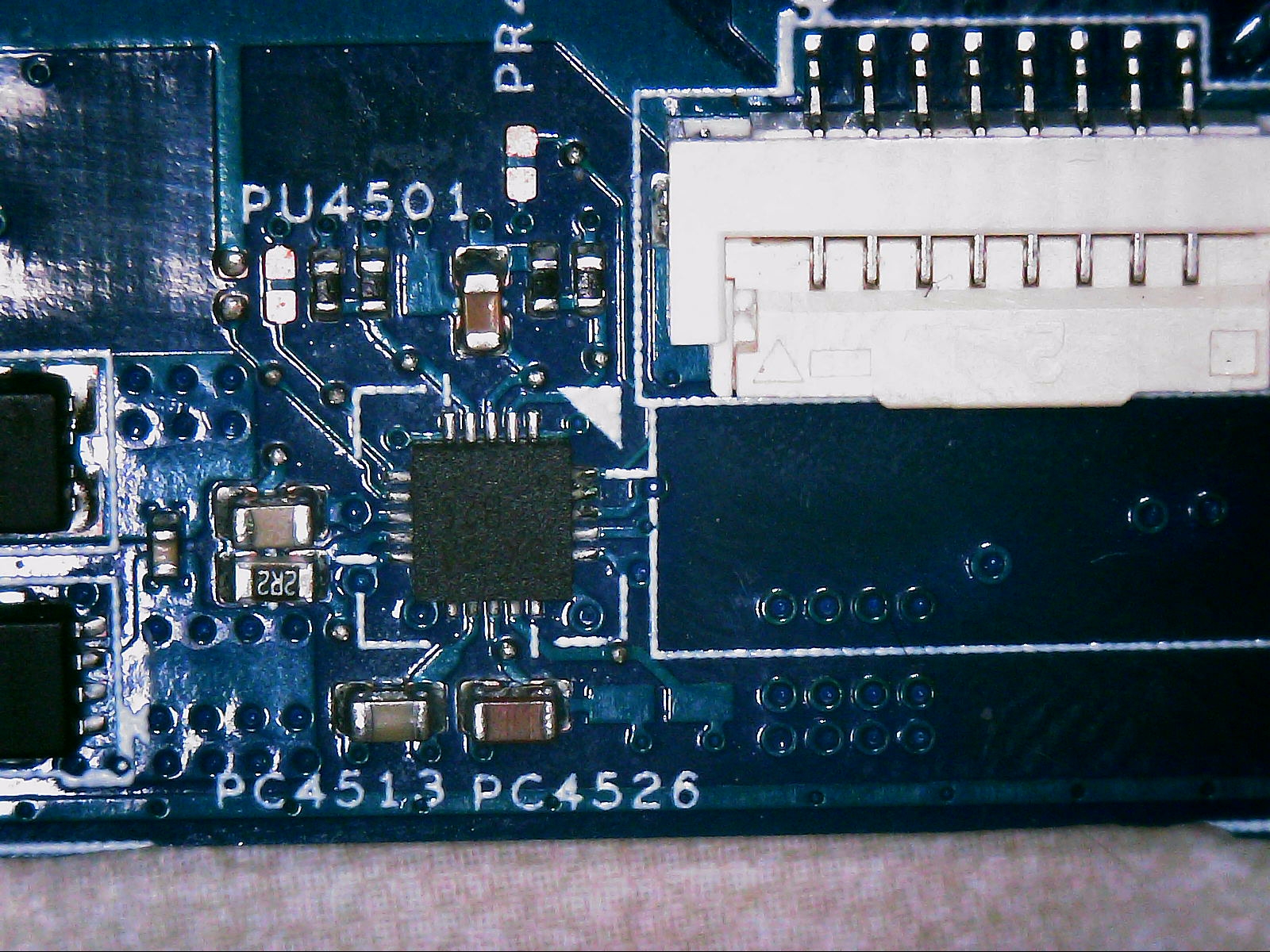

    Hi guys, grateful if anyone can help with identifying part number of the following IC.
    Laptop: HP Pavilion x360 m3-u001dx
    Motherboard: Brittle MB; 15256-1; 448.07M06.0011
    IC marking: 5X=3A B25
    Location on board: PU4501
    I can't seem to find schematic for this motherboard.
    From now, thank you for you help

    Re: Help with HP IC component identification
    Richtek RT6575DGQW
      Originally posted by R_J
      Richtek RT6575DGQW
      Thank you very much, that will help me to repair
          RT6575D stb control chip, 3pin + 3V LDO and 13pin + 5V LDO outputs. Overheating of the chip may not indicate it is malfunctioning. what are the omaj values in these outputs.
