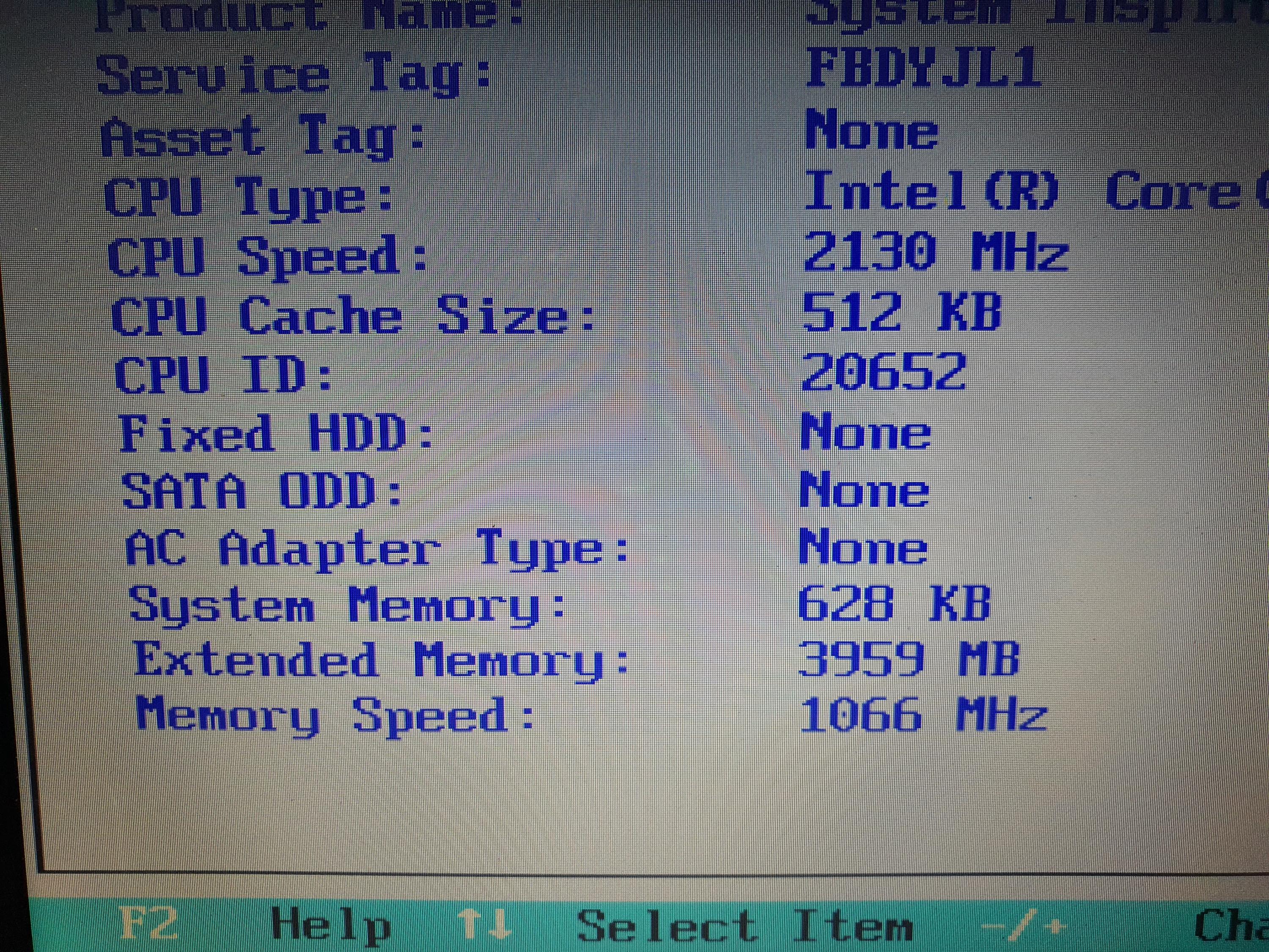

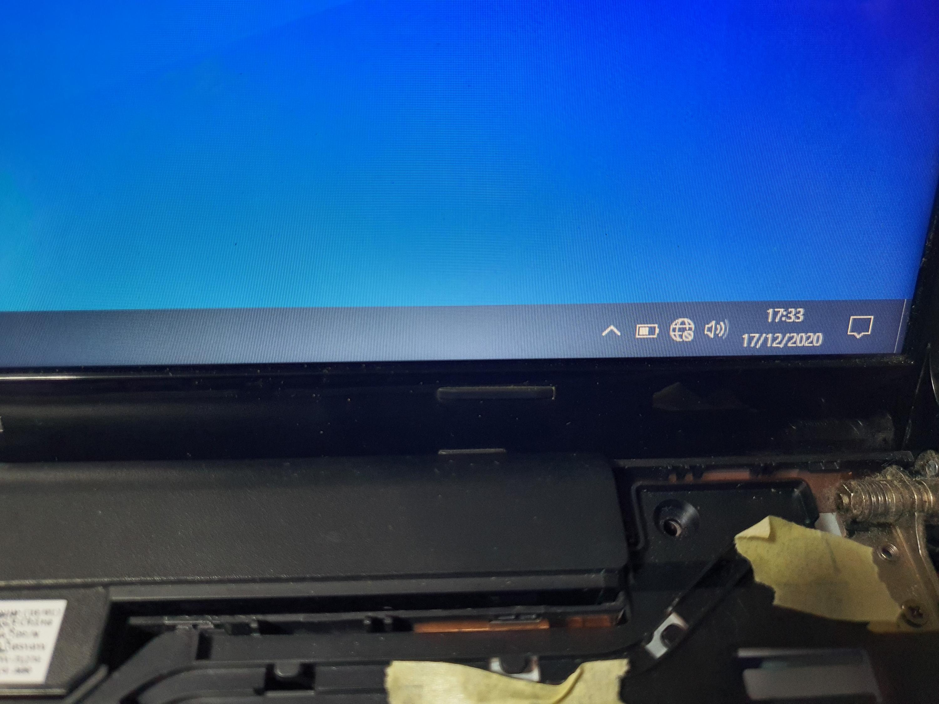

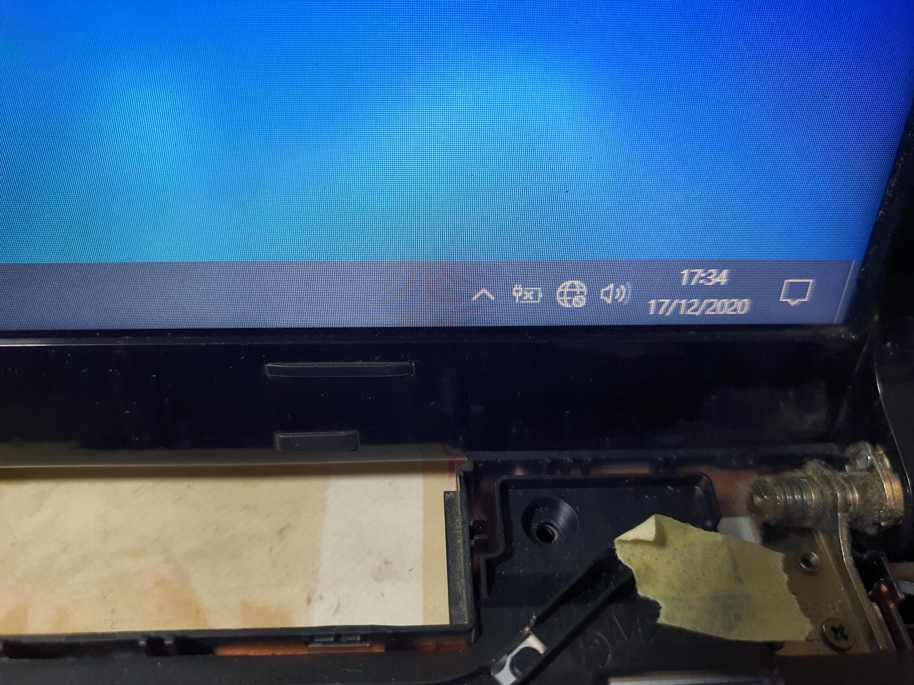

        first of all thanks for your support, I have attached 3 photos 1- bios ... 2- without battery ... 3- with battery (see icon on the O.S. try).
        unfortunately I'm a beginner so I don't have an oscilloscope, I'm armed only with a voltmeter. I will try to check Pq11 and Pq12 as suggested and I will update you, if please in these three photos they suggest other tips that you can give me is appreciated

          BIOS doesn't detect the adapter, but the machine powers on. This is classic dell nonsense.
          In this condition the battery will not charge.
          Before you do anything else try to find another original Dell adapter that you know works and try doing the same thing with it. Alternatively, put your adapter into another Dell machine. This is to eliminate a fault in the adapter (these things have a whole serial protocol between the adapter and the motherboard and if the circuits in the adapter that are responsible for it die, this is exactly what you would see). After that you can start dealing with the board problem. See sheet 53 of the schematics.

                        Another check performed in the old Bios mainb the "AC ADAPTER" detects 90 W
                        in the bios of the new detects NONE
