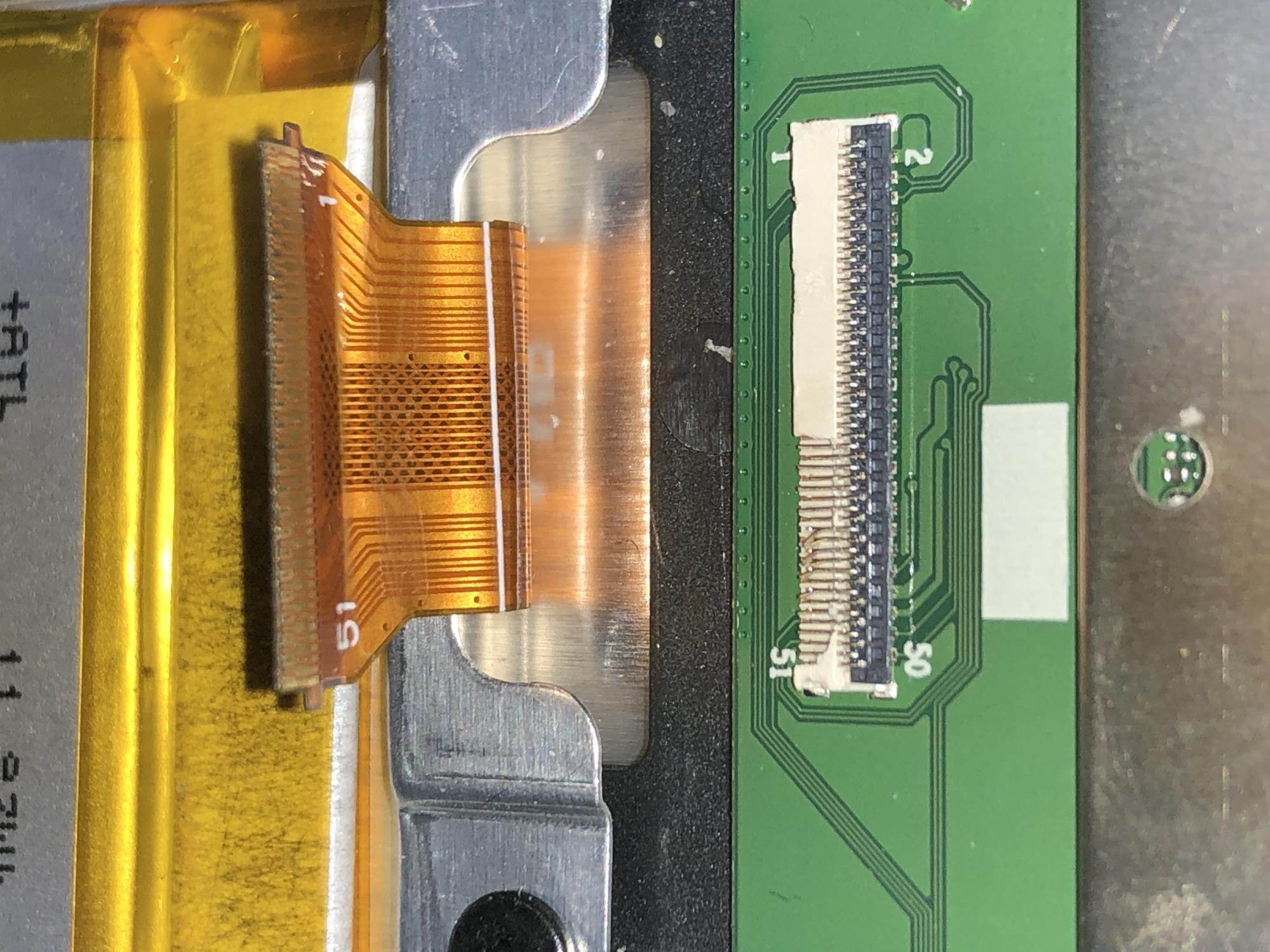

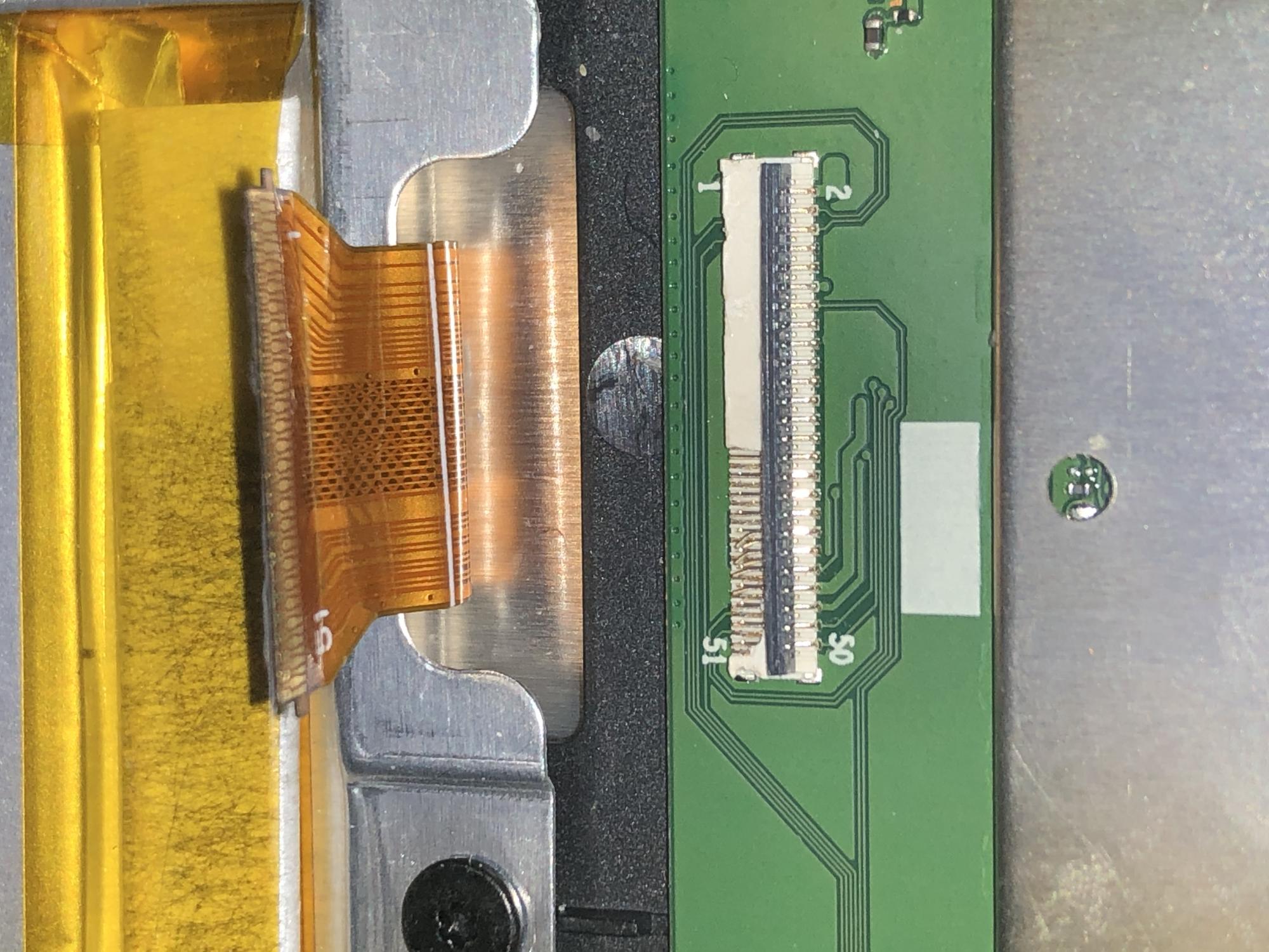

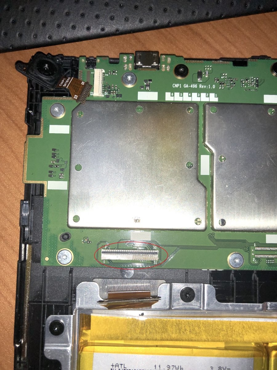

    Ribbon flex connector replacement
    I am trying to fix a tablet that someone botched the ffc/fpc connector on as circled in the picture. When buying a replacement connector I see the connectors are categorized by number of pins and pitch but how do I determine what mine is to find an exact replacement. Not sure if it means anything, but beside the connector it has written a number 1 on one side and 51 on the other side which is also written on the ribbon flex

    Re: Ribbon flex connector replacement
    51 will be the pin count. Having a number on the other side suggests it's two rows of contacts, it's hard to tell from your photo.

        • 21441
        Originally posted by ntec
        I will try and get a closer pic of the connector and a pic of the flex cable later.
        Post the make and model number as well.The connector might be available for sale on ebay or ali if its a popular model.
          It's the amazon fire 10 hd. I did look but couldn't find anything for the connector.
            Here are better pics.
