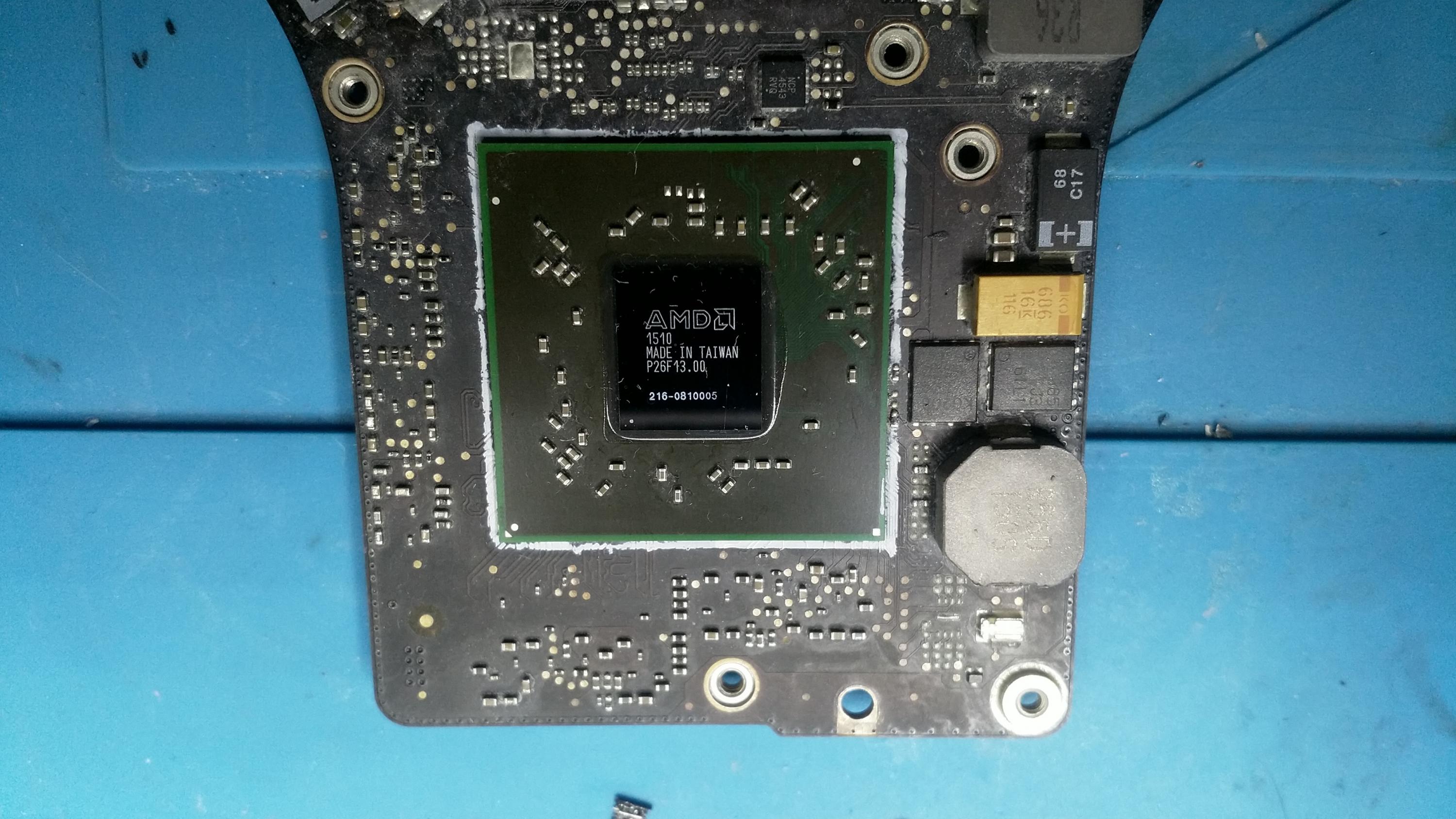

            Re: 820-2915-B Chime, Boot to OS, Hear sounds, but No Video
            today i replaced the gpu bga with a new one from goldenchipset. whole process was fine. gpu soldered ok after 20 min to allign it without markers onboard, but now i have black screen when powering on the macbook. i ear chime and so on, but no video, and on C8943 i have 1.1 1-13 volt but on a working one it goes to 0.9 when monitor turn on, so something is wrong with the gpu, but gpu should be a good one since it was looking in perfect new condition. original gpu was 2015 ( maybe a refurbished board from apple) and the new one is 2017.

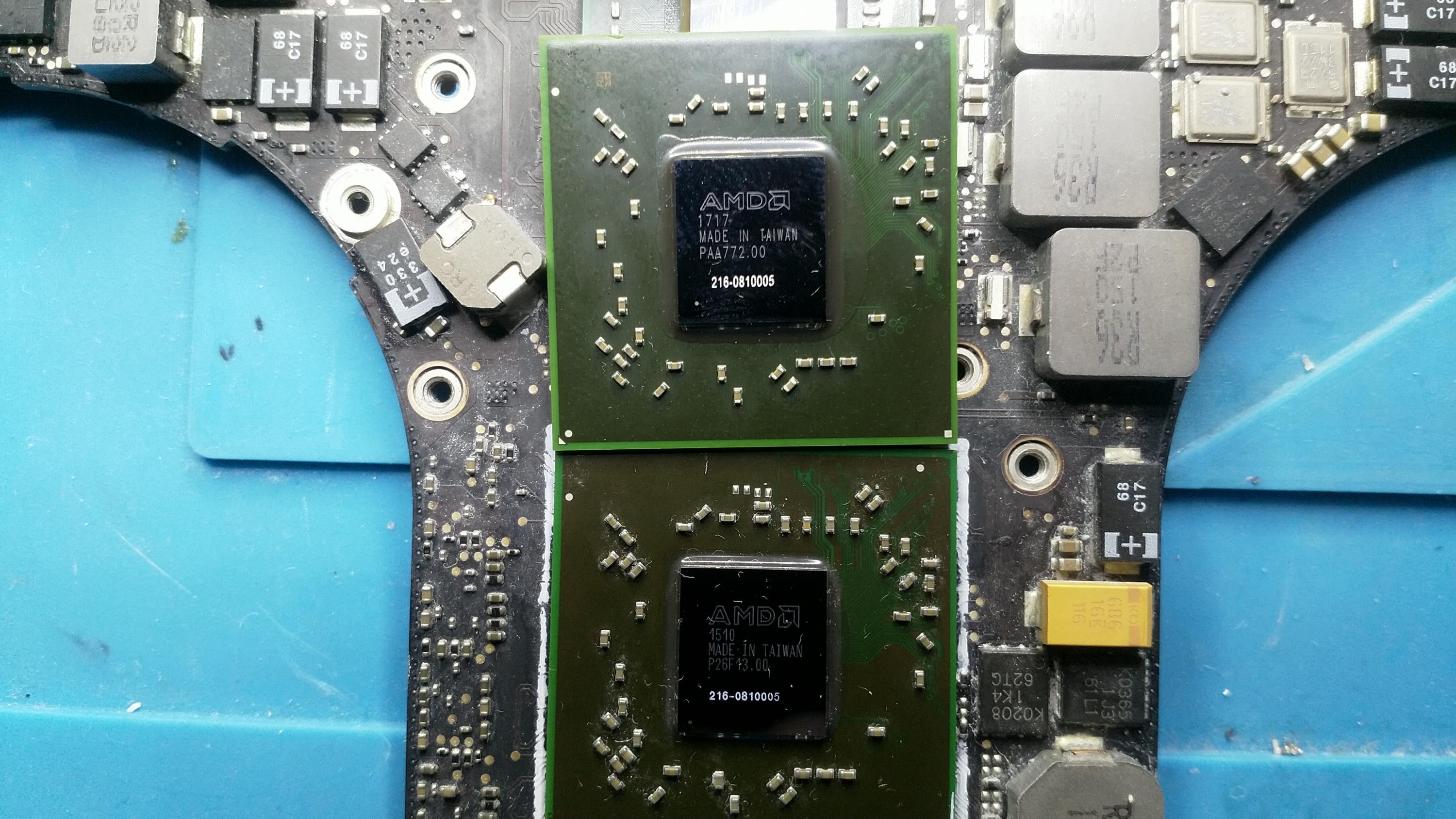

                  yes i have measured that on a booting board. now i have another bga, same model same datacode as i ordered 2 from goldenchipset. the first one got reballed with leaded balls ands soldered on it without backing the bga.
                  now i dunno if try the other chip on a second board, solder it with its original lead free balls or reball it, or try that chip on the first non booting board to see if it was really the bga itself . in both case this time im gonna backing the board at 98° celsius for 4-6 hours before solder the chip in it.
                  i attached picture. on the old soldered 2015 bga u can see solder on top 4 pins, while on 2017 bga from gc u can see those 4 pads have no solder, like 100% new...
                  i also used a permanent marker before remove old gpu, but when i was desoldering it, flux make the marker liquid and useless
                    Hey nice idee with the marker, but i think this is not necessary because you cant do much failure putting the chip back to the board, if you have good BGA Flux!!
                    These Chips are all garbage, its a shame from ATI, because in my eyes these Macs are damn good, if they wont have these shitty ATI Chips...
