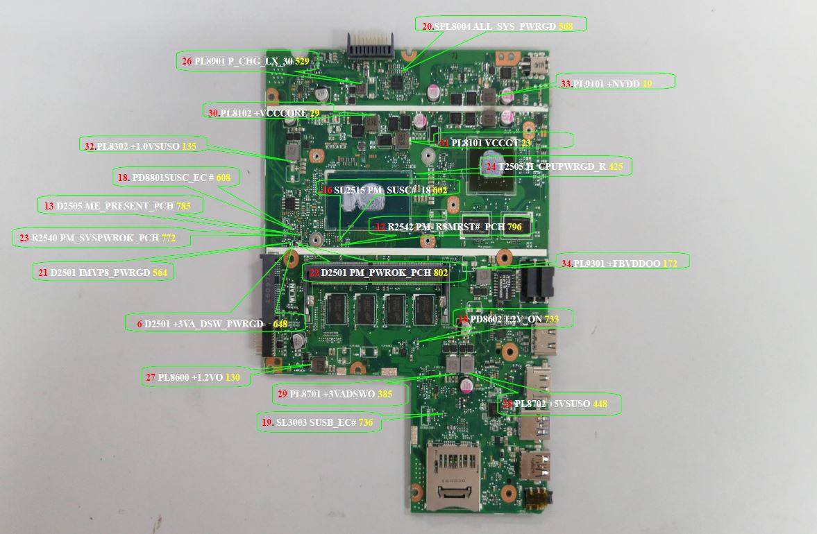

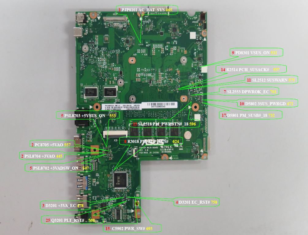

    after a lot of ic replacements and good cleaning i have this results:
    18.70 AC_BAT_SYS
    5.00 3.00 +5VAO +3VAO
    3.20 +3VA_EC
    3.20 EC_RST#
    3.25 3.25 +3VADSW_ON +5VSUS_ON
    3.23 +3VA_DSW_PWRGD
    3.24 DPWROK_EC
    3.34 PM_SLP_SUS#
    3.25 VSUS_ON
    3.25 3SUS_PWRGD
    3.34 SUSWARN
    2.94 PM_RSMRST#_PCH
    3.04 ME_PRESENT_PCH
    3.25 PCH_SUSACK#
    3.22 PM_PWRBTN# PWR_SW#
    3.34 PM_SUSC#
    3.34 PM_SUSB#
    3.24 SUSC_EC# 1.2V_ON
    3.24 SUSB_EC#
    3.31 ALL_SYS_PWRGD
    3.30 IMPVP8_PWRGD
    3.25 PM_PWROK_PCH
    3.24 PM_SYSPWROK_PCH
    1.00 H_CPUPWRGD_R
    3.34 PLT_RST#
    12.51 P_CHG_LX_30
    1.20 +1.2VO
    5.05 +5VSUSO
    3.34 +3VADSWO
    0.98 +VCCCORE
    0.00 +VCCGT
    1.00 +1.0VSUSO
    0.00 +NVDD
    0.00 +FBVDDQO

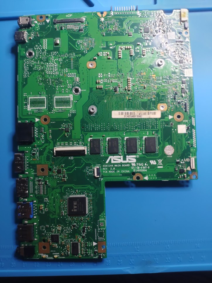

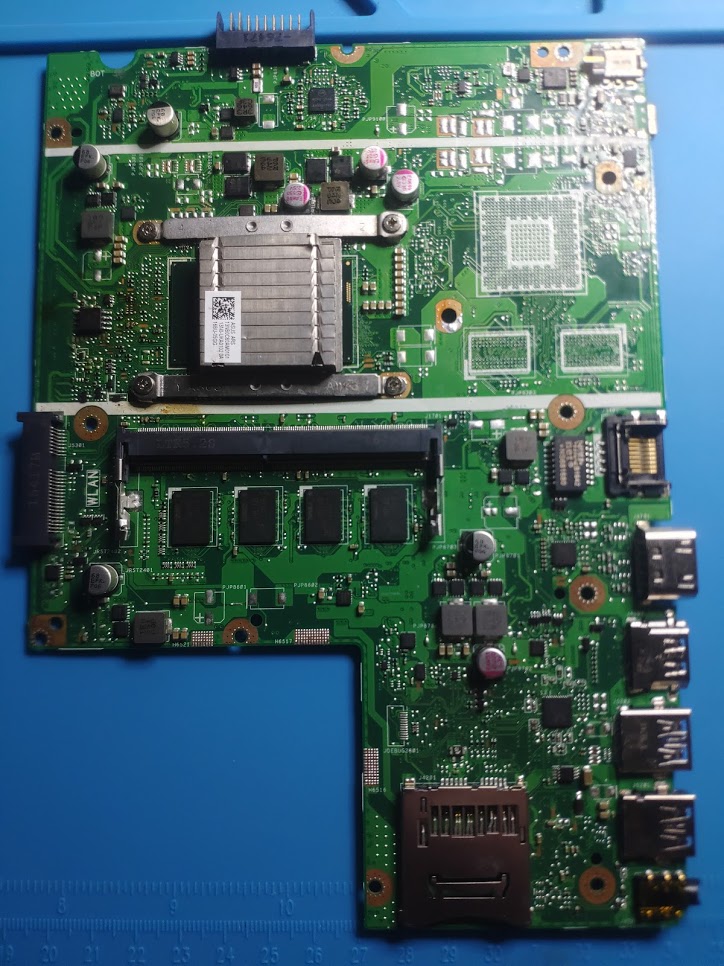

    with his original bios dump i had white light on power led and orange light on charger led all time, i disabled onboard ram and still the same, i changed bios dump and with version 308 i had white light on power led and charge led blinking white colour once. with version 307 (i have only black screen without backlight or anything else) without ram on slot i have power led white and charger led blinking 2 times white(it recognize that ram is missing). when i install ram on slot i have white led on power led and orange on charge led. i also replaced ncp cpu ic. any ideas?
