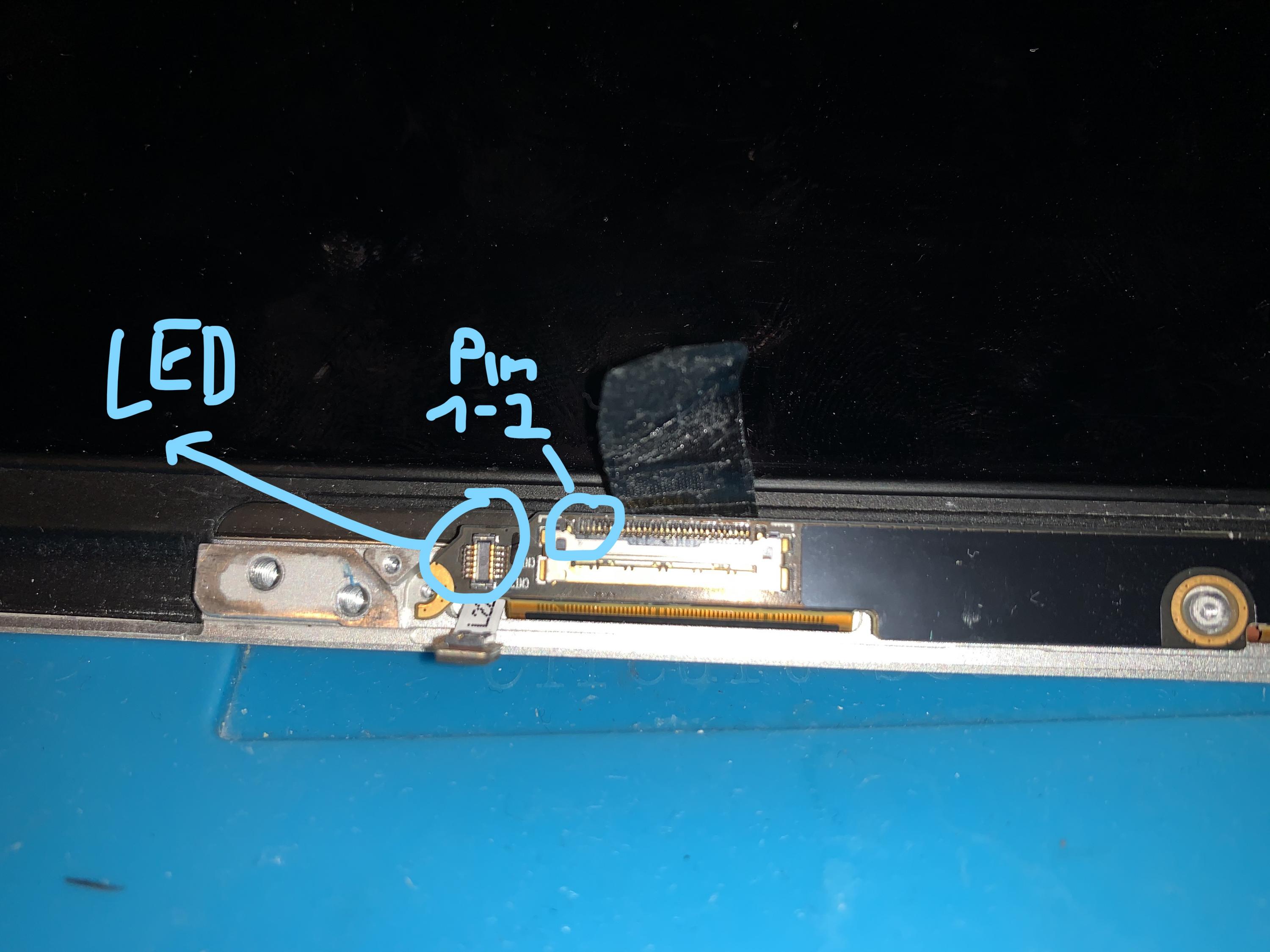

    hello all,
    so there is image but no backlight, i can use the laptop with external screen via HDMI,
    i have checked the board and found an damaged LCD fuse F9700, replaced it but this didnt solve the problem.
    these are some readings that i have made, i have measured all with the LCD connected
    L9000 (PP5VR3V3_SW_LCD) - PIN1 5V PIN2 5V
    C9000 (PPVOUT_S0_LCDBKLT)- PIN1 0V PIN2 0V
    F9700 PIN1 12.94V PIN2 0V

    Resistance to ground on PPVOUT_S0_LCDBKLT with and without LCD?

          Re: Macbook pro 820-3332 No Backlight
          so i set the multimeter to 200KΩ
          no LCD i measure 56.2K
          with LCD 0.009K
          what does that mean?
            Bad LCD or LCD cable.
                    Originally posted by p_d View Post
                    ? water damage
                    whatever blue the fuse is still a problem
                    i have found that the pin 1 and 2 on left on lvds connector are damaged.
                    can this cause the backlight not to work? because backlight connector is not damaged as you can see on the picture
