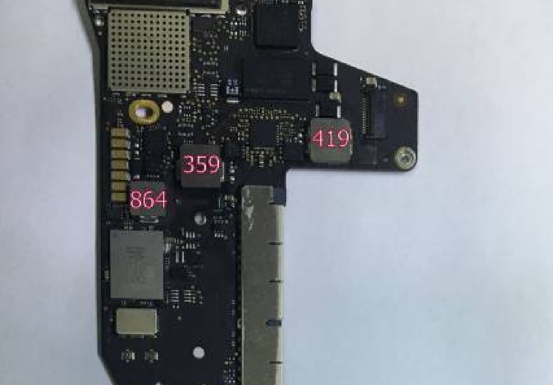

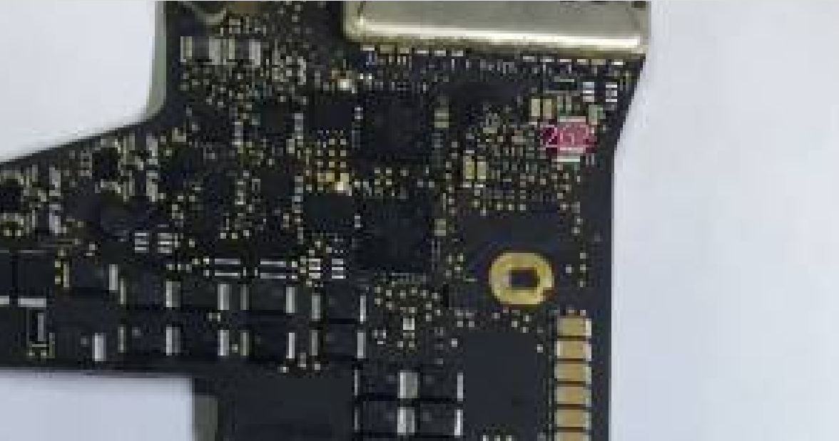

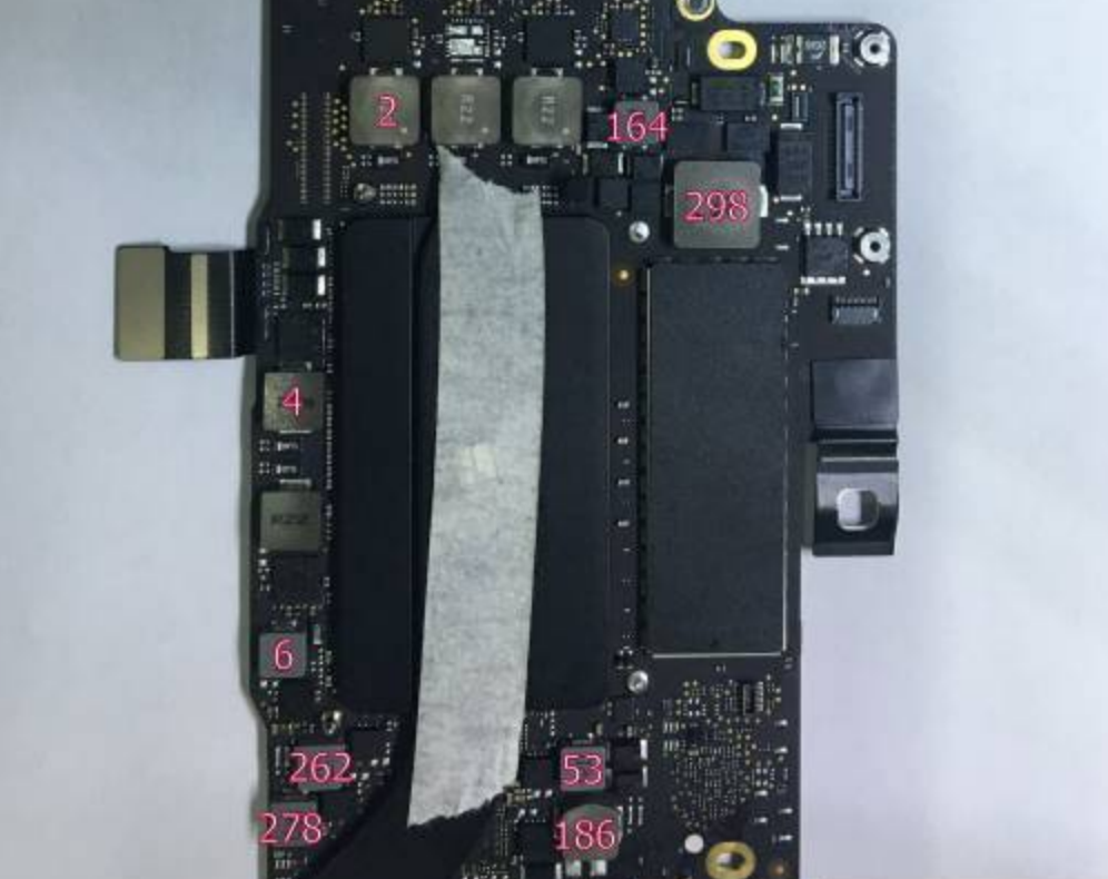

                        1) Review the attached diode coil readings. Some of the values are fuzzy but hope you can still read them.
                        2) What is the reading @ F7000 for the voltage when ON ? Power down, and remove the battery. Then place your meter in RESISTANCE mode -> what is the resistance reading to ground on F7000? It is good to review the same for other coils on the board.
                        Perhaps you have a shorted (bad) cap onboard and the resistance will be very low. The Vcore rail is ok to be low but list the values. If the value is too low, the power supply will current limit the power supply so that it does not get killed.
