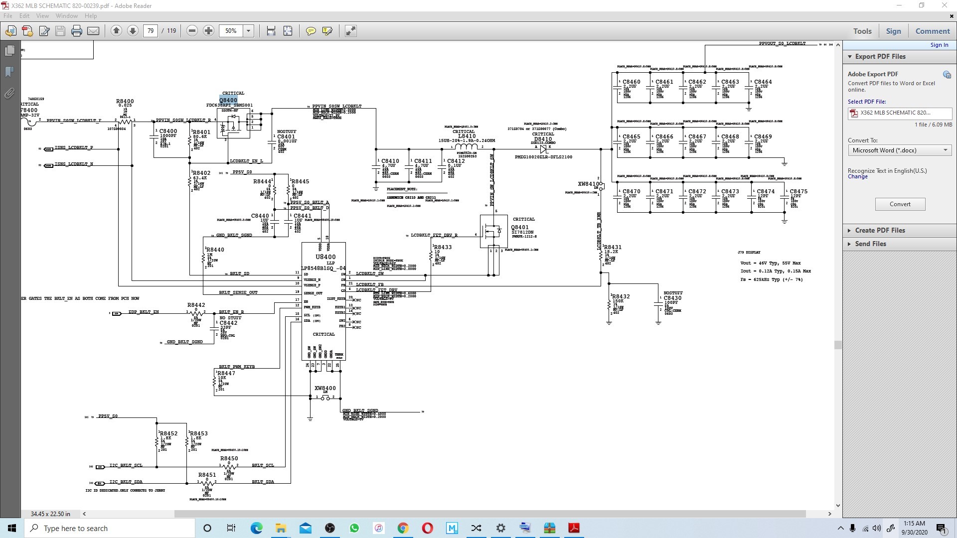

Hello guys, what is the procedure to diagnose a back light on this model
820-00239 i have the image but no back light
Re: 820-00239 i have the image but no back light
As always start by checking exact voltage on backlight output (LCD connected).OpenBoardView — https://github.com/OpenBoardView/OpenBoardView
