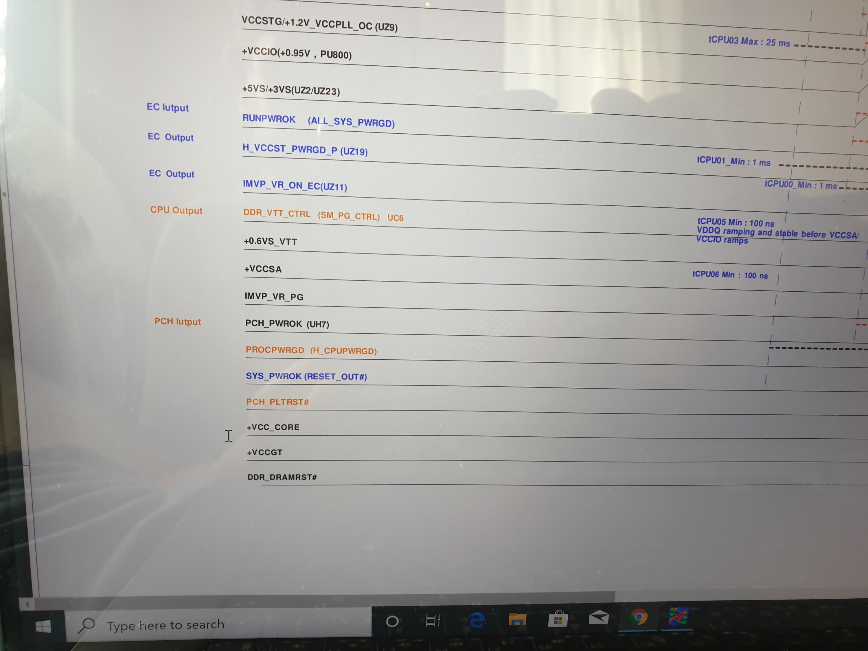

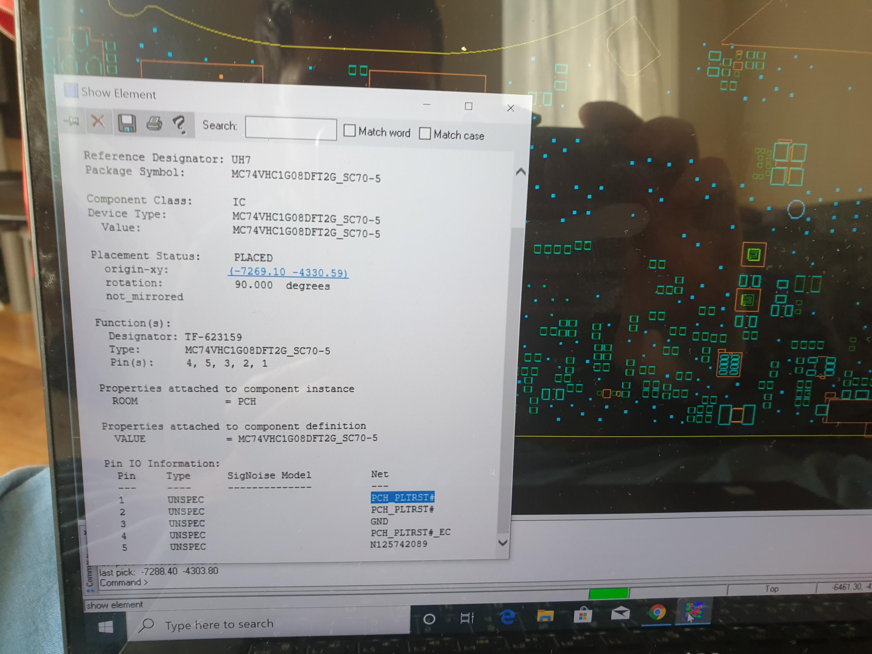

                Hi aftet more measurements
                PCH_PLTRST#_EC missing this is probably last signal before vcc_core
                On Uh7
                I've got
                Pin 1 PCH_PLTRST# -0v
                Pin 2 PCH_PLTRST#-3.3v
                Pin 4 PCH_PLTRST#ec -0v
                Im little confused why pin 1 and 2 got same name but are not connected (diode mode)
                Can i connect pin 1 and pin 2 and try to power up the board???

                      [QUOTE=techtiger;988930]
                      Originally posted by barakuda123
                      uplode the Schematic that you have the my one is different
                      There's no schematics for 9560 only for 9550 and 9570 There's a boardview for 9560 tho
                      I'm just combining all 3
                      Power sequence os from 9570 tho most if not all start up signals are the same

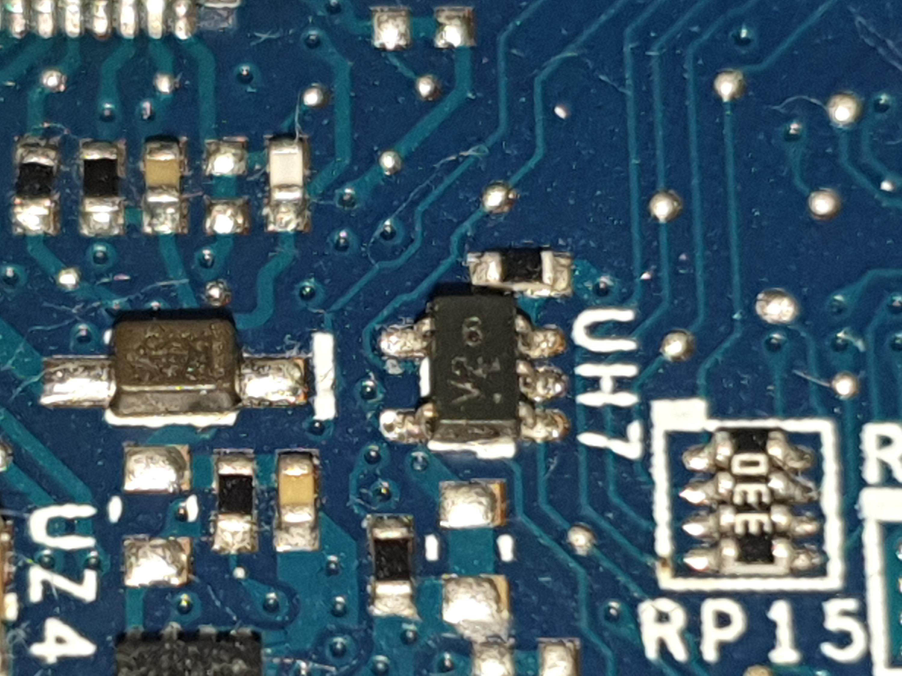

                                  • uk
                                  Re: Dell xps 9560 la-e331p dead
                                  Originally posted by techtiger
                                  First remove UH7 & see if the voltage is back pin 5/ 1/ 2 , Check pin 108 DDR3 Slot voltage ? If now supply find out RD35 voltage in out & input side ?
                                  Hi after removing uh7 still no voltage on pin 1 or pin 2(pch_pltrst#) on this board its rd31 i believe you asking for ddr4_dramrst# and h_dramrst# when i power up the board voltage jums for 0.5 sec to 50mili volts than down to zero
                                    pin 5 UH7 do you get 3V ? if you have a hot air gun heat the PCH and see as for the Schematic RD31@ no stuff find out RD35 or put a jumper 1.2V & see what is the resistance to GND on RD31
                                    • piernov
                                      • Jan 2016
                                      • 4439
                                      • France
                                      Can you annotate the pins of UH7 on the picture of the board with your voltage measurements?
