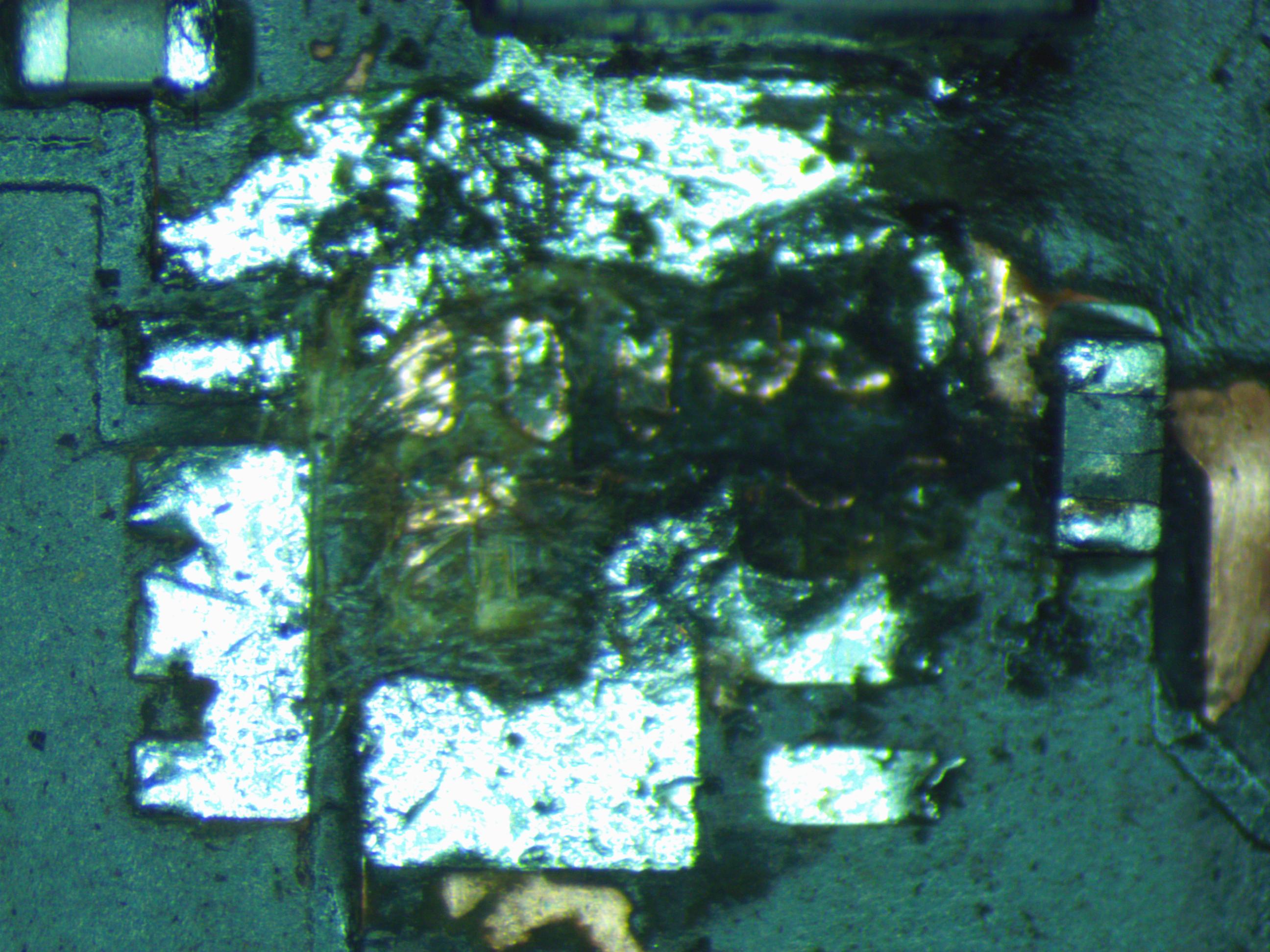

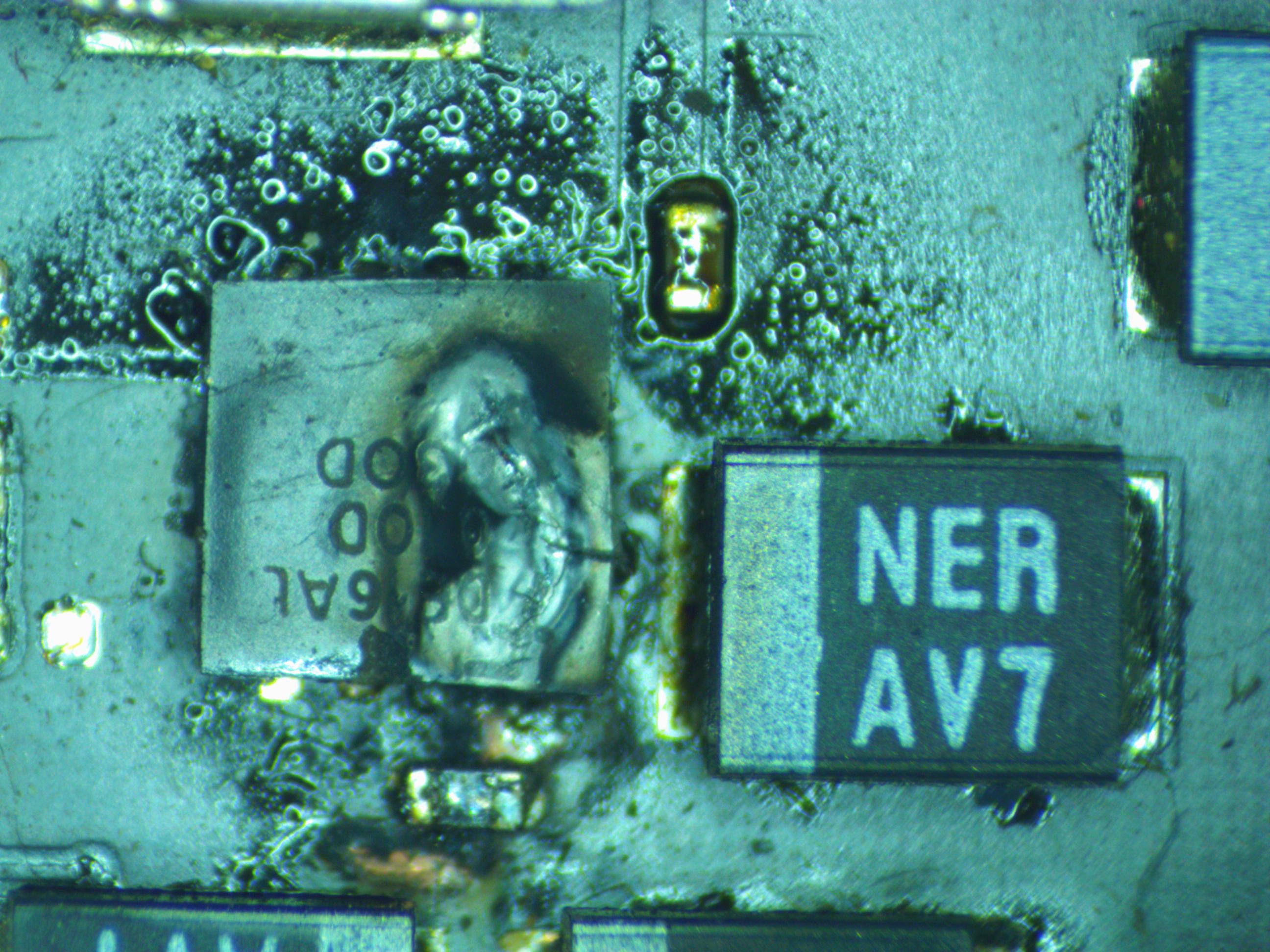

    Hello, I got this water damaged macbook air which my main question is about Q7630 which is blown and because of the way it was, I'm wondering if worth it to troubleshoot this MB, if you pay attention to the picture you will see that there might be some damaged layer below, actually if I connect the charger orange light comes on but it doesn't charge. please see pic.

    Well remove it and see how bad it is. There is a chance that it damaged the PCH though.

      Re: 820-3435 water damaged
      it looks very bad. what do you think
        clean with isopropil alchool 99.9% and make picture again. check if some pinpoint is shorted. if not it can be repaired.
